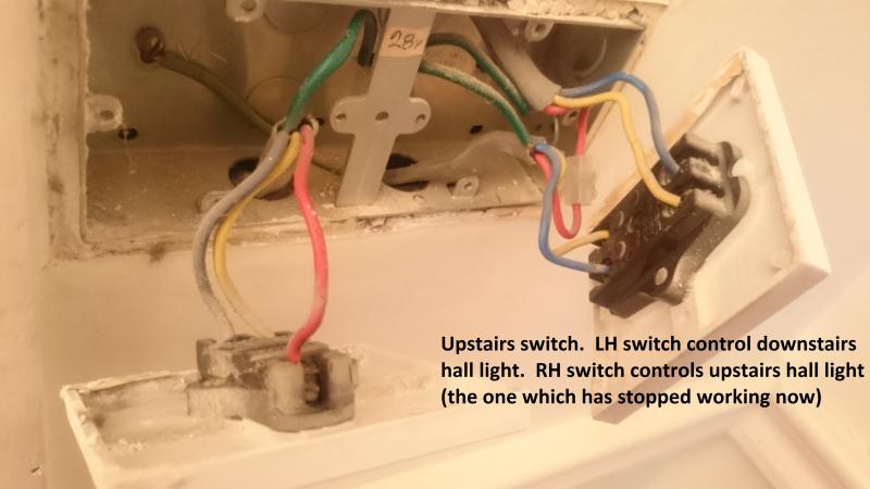

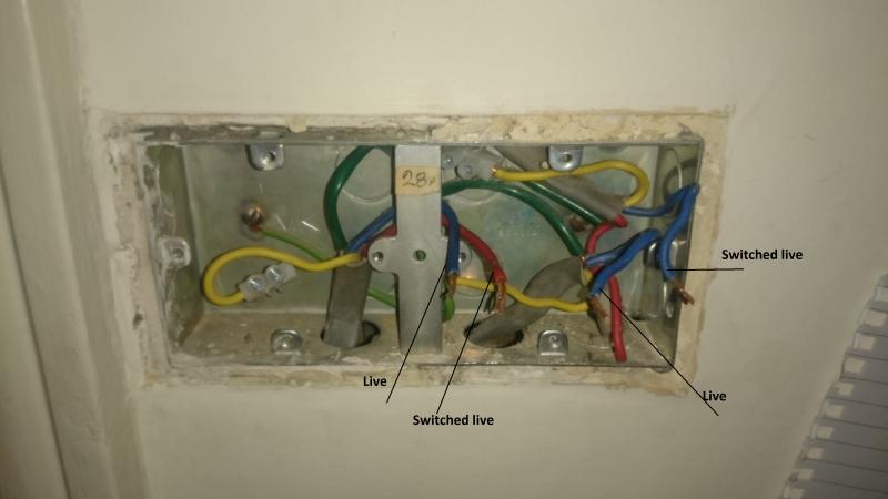

So here are the pics, if this can help?
Just a reminder of what I did.
1. Connected together some wires downstairs so that I no longer have to use that switch (replaced with a remote control to new upstairs 2 gang switch)
2. Put in a new replacement 2 gang switch upstairs.
All worked for a few weeks but now the upstairs switch to upstairs hallway light no longer works. The switch next to it (which controls downstairs hallway) is still fine.
Any ideas what it could be?
...but the downstairs switch was two switches (the circuits now joined) and
the upstairs RH switch is an intermediate which indicates that there is a third switch on the circuit (which could possibly have been switched (off or on) meaning that your very strange wiring has caused the light to not work).
I would suggest you put it back as it was if you can and get it working as it was and start again.
