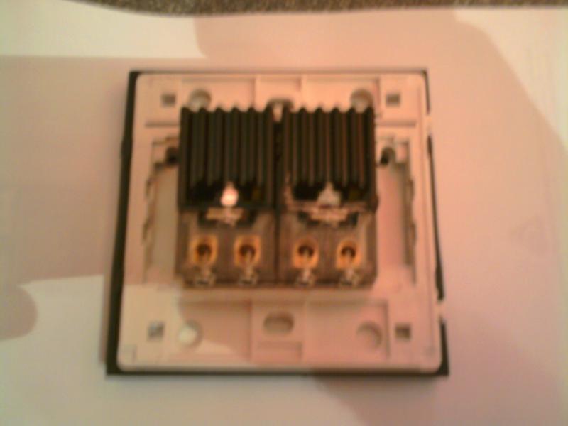

hi can some1 please help im changin my light switchs in front room the old 1 has l1 l2 l1 l2 an 2 com
the new ones have l1 l2 l1 l2 but no com
i tryed to change them an put l1 l2 in on both but dint work can some1 tell me where im going wrong please
It sounds as if you have bought one-way switches when you need two-way. the old ones had three terminals each and the new ones only have two.

Please take a photo of your new switch and your old switch and post it on here. You'll find how to do it under "forum rules".

So what are the connections to the old switch?
The switch you have bought may be OK as long as there are no two way circuits.
right one wire is black am goes to l1 other is red an goes to l2 an a red 1 to com
thats 1 gang an other one is same
You need a 2-way switch then. It sounds like one of the gangs is controlled from another location as well as this switch. A 2-way switch will have capacity for this.
But as you are fitting dimmers, make sure the dimmer doesn't need a slave or retractive switch at the other end.
When looking at your new switch, it DOES have a COM, but its labelled L1. And L1 is labelled L2. Confused? :wink: You're not the only one. Com can have a few different notations. C, ~, ~ with a line through it, L, Common, Live to name but a few.

in my living room i have two lights an two double light switches
the new light switchs i got as told by steve are 1 way two gang switches
but can be used as a 1 way 1 gang switch
so it says on box
could i use them like this an how would i wire them up
i hope you know what i mean really sorry if you don't
You have two lights, each are controlled by two switches yes? So four switches in total.
You CANNOT use this switch if this is the case. Each switch needs three terminals, as your old switches had.
Do you know the brand and model number of these switches? Or a photo of the box?
