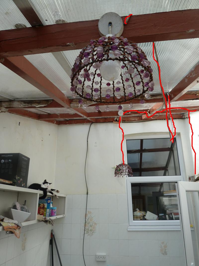

Hi,
I am looking to update the wiring in my conservatory.

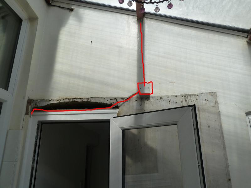

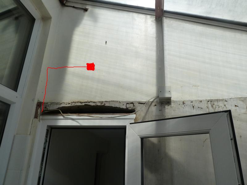

It's pretty dire at the moment. Here is a photo of the current set up for the lighting. In the second and third photos, I've highlighted the current electrical cables for the lighting in red. The cabling then runs down the side wall and back into the main part of the house, which can be seen in the third photo.

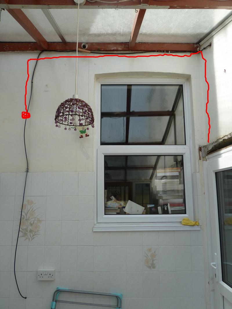

I want to get some new lights and install them on the wall. At the moment I am trying to work the best position. I was thinking of running the cabling as in the following photo, where the new cabling would be channelled into the wall.
Is this a reasonable place to run the cable? It occurred to me today that there maybe an issue with the lintel of the window, i.e. in running the channel for the cable I may weaken the structural support of the lintel. Sorry this is a stupid question, but is that a possible issue?
These are the permitted safe routes for buried cable.
Newly buried cable will very likely require 30mA RCD protection, so is that existing on the circuit being used?
Also it is not wise notching into a wooden lintel or chasing out into a masonry type. But if you use the the permitted safe routes wisely, this maybe avoidable.

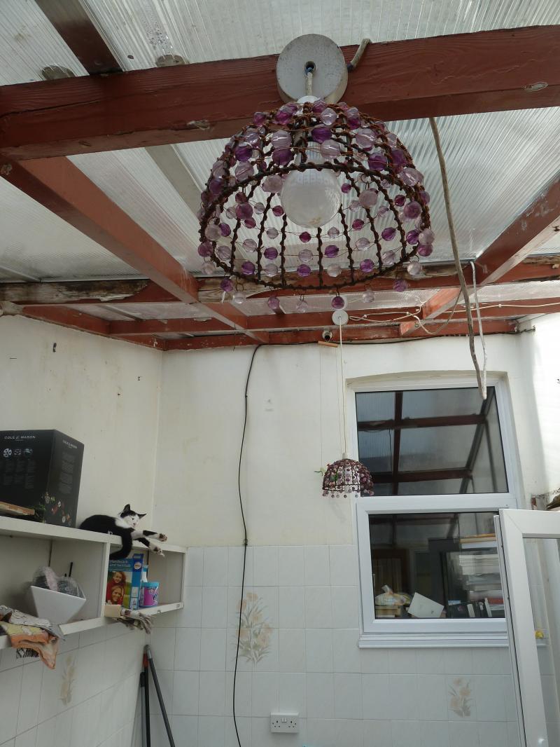

I am currently thinking of a position just above the door. Here is a photo of the proposed position.
Again, I would prefer to chase the cabling into the wall. I was thinking of going up the wall that is adjacent to the wall with the door, so as to avoid the door lintel, and then across to the light. Would this be okay?
