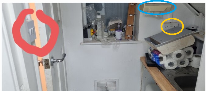

I have to re wire a shop and I was told to use same switch in the kitchen witch too close to a sink. Please advise
Photo in the attachment
I don't believe there is a "zone" around a sink so should be ok to stay.

But this is not a bathroom!!
In bathrooms, there are rules defining the zones, measured from a bath or fixed shower, where electrical fittings, and especially sockets, may not be fitted.
Your room is not a bathroom, so the zones do not apply, and it does not contain a bath, so there is nothing to measure from.
A sink is not a bath.

It's not as close as the socket or Consumer unit.
But all of that aside as others have already pointed out if there is no Bath or Shower in the room there are no zones.
