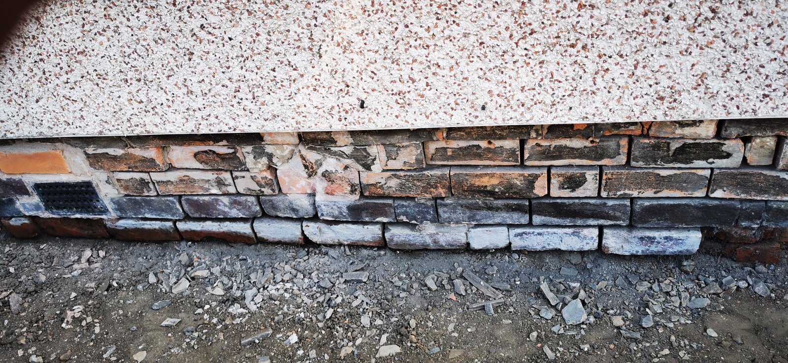

Hi, I have some brick work that needs repointing and need advice if it needs lime mortar or not the house is a victiorian terrace
To the extent it is below dpc level, and therefore going to absord damp, ordinary mortar should be OK.
