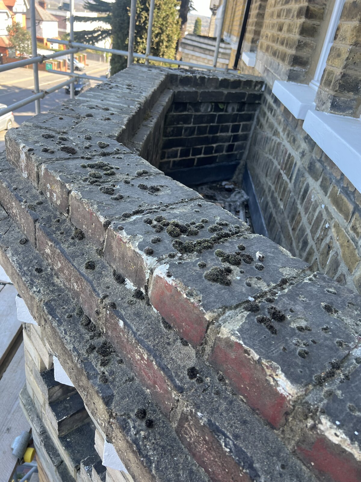

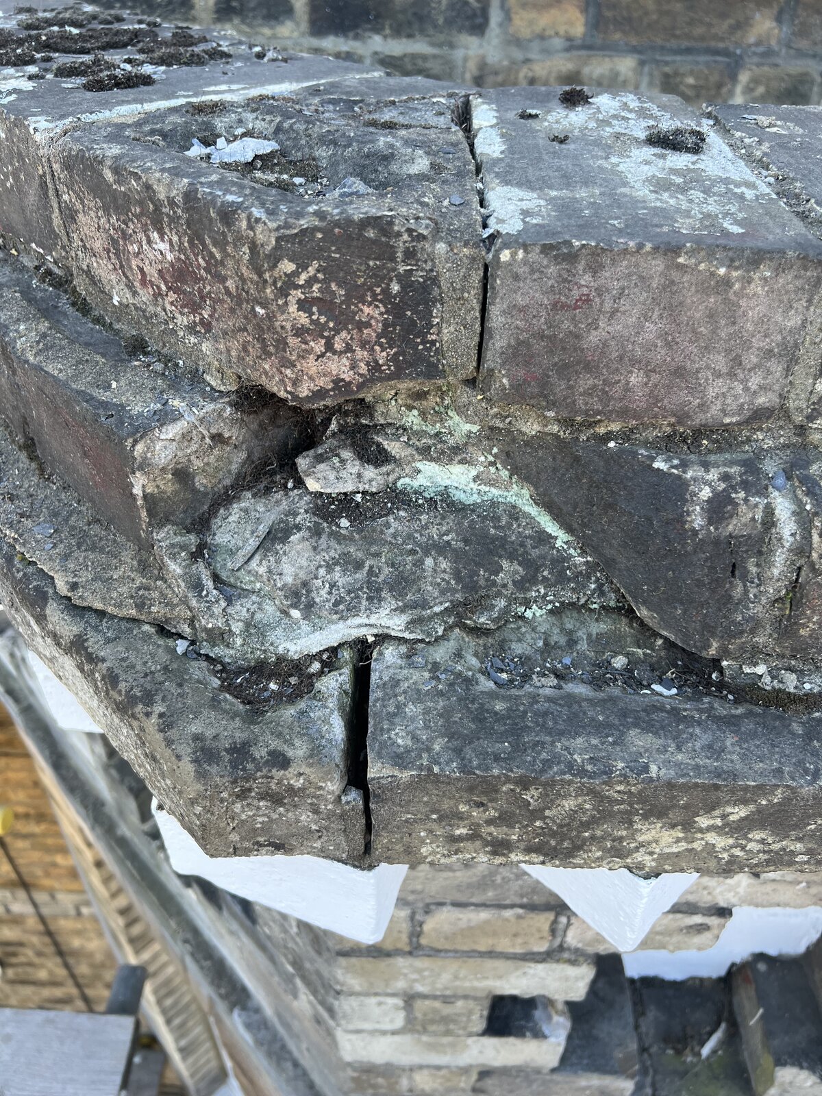

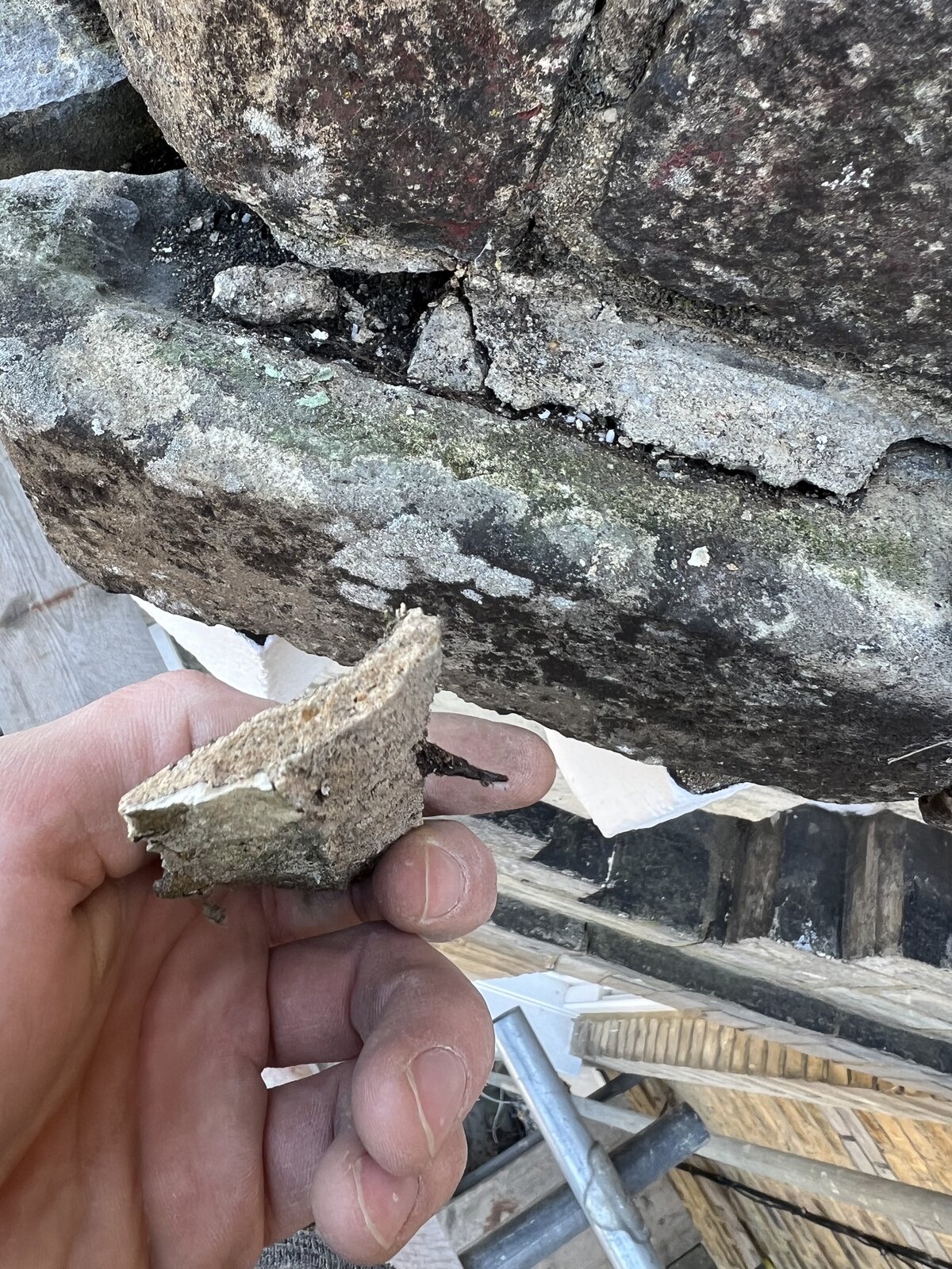

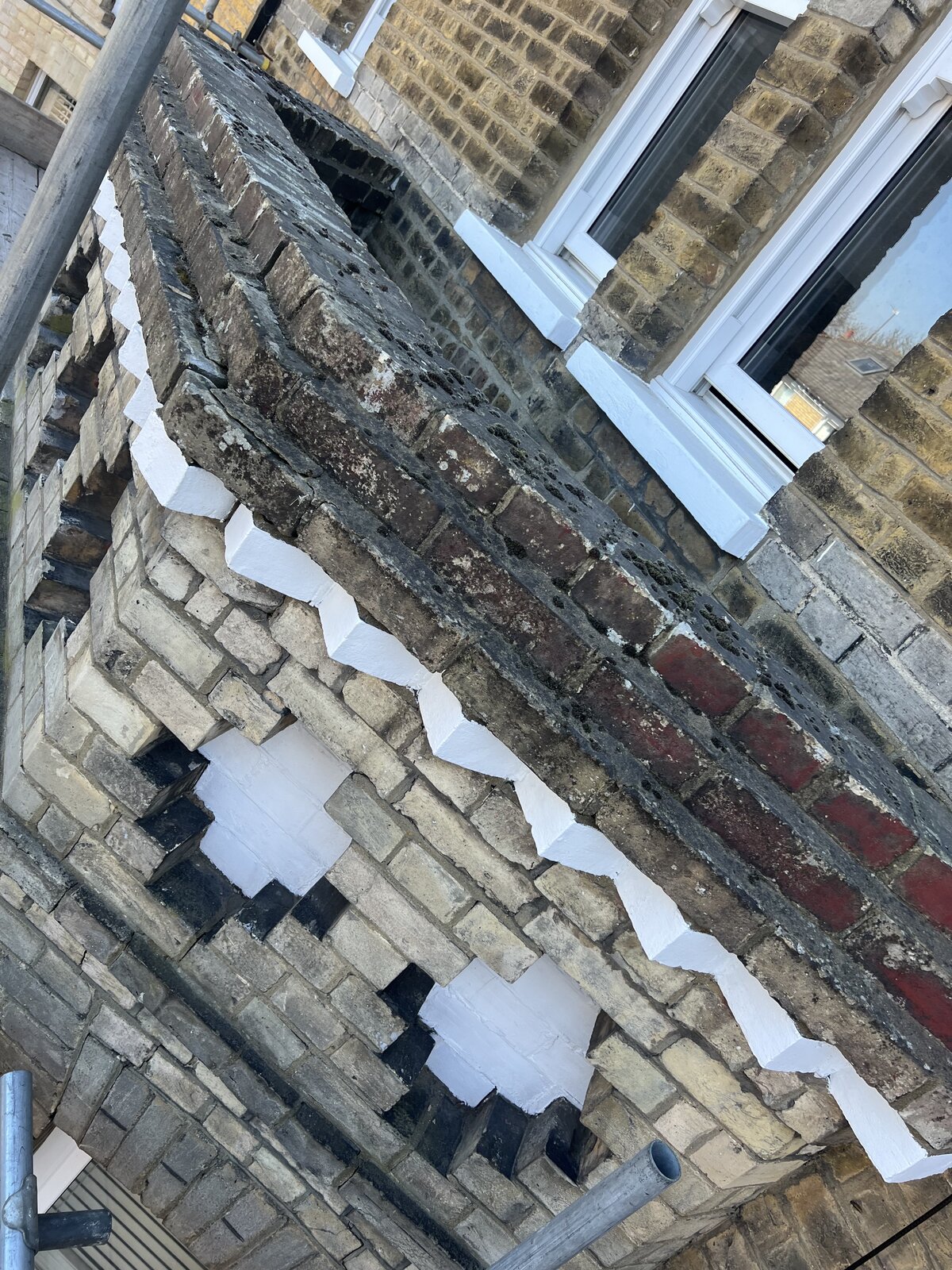

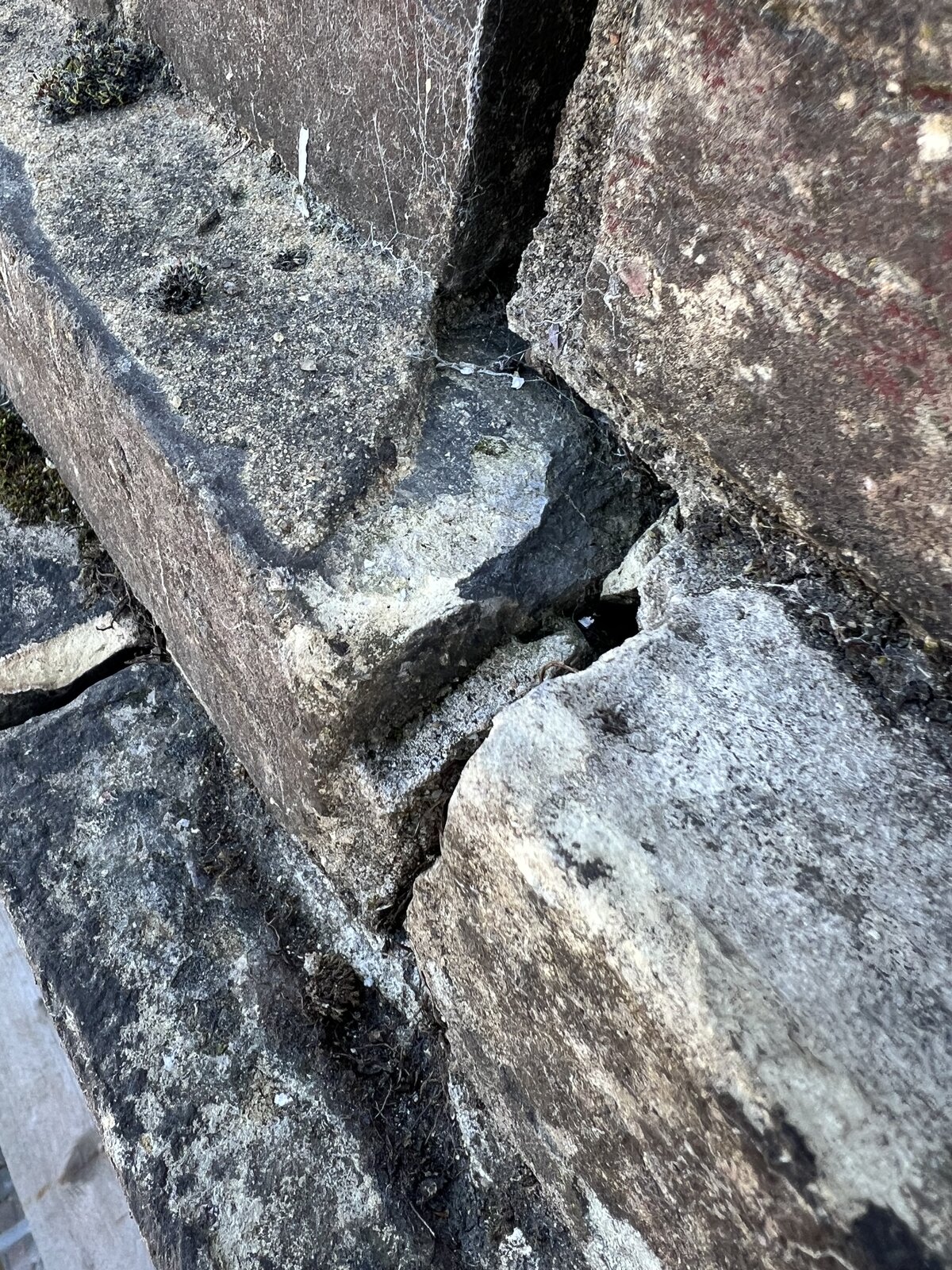

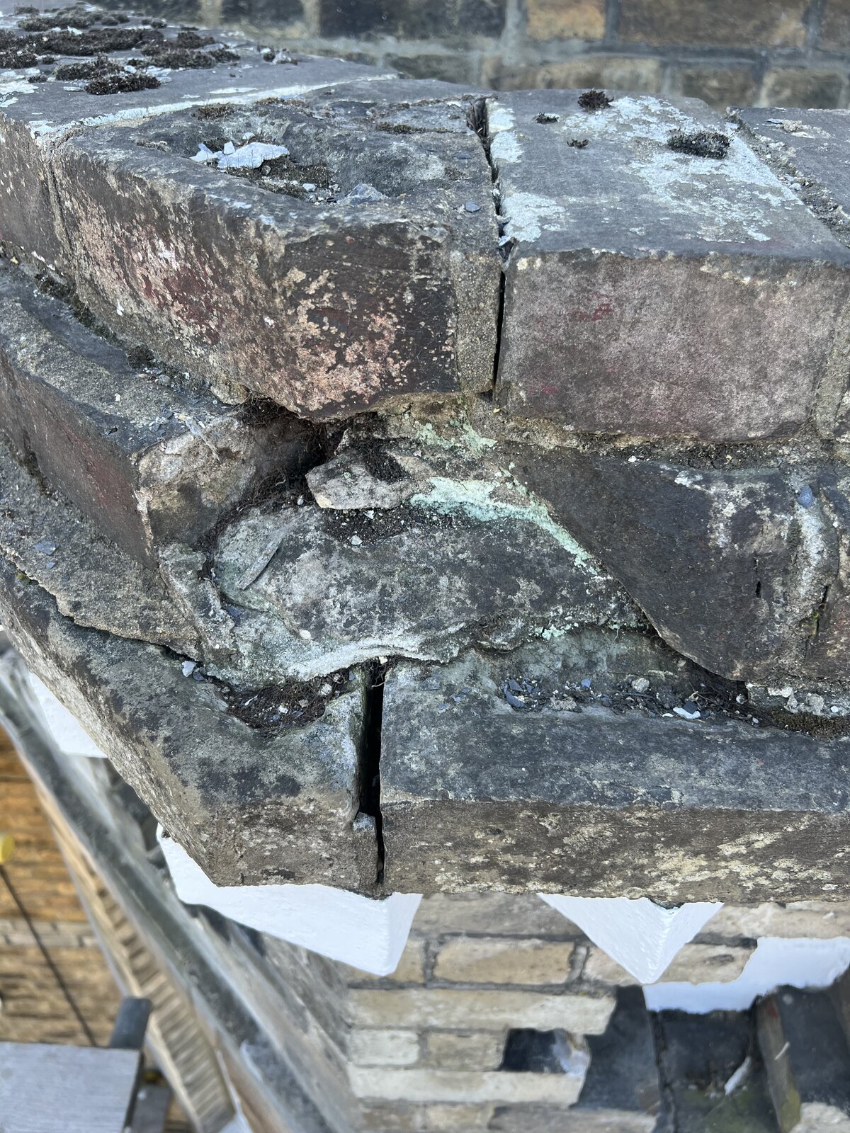

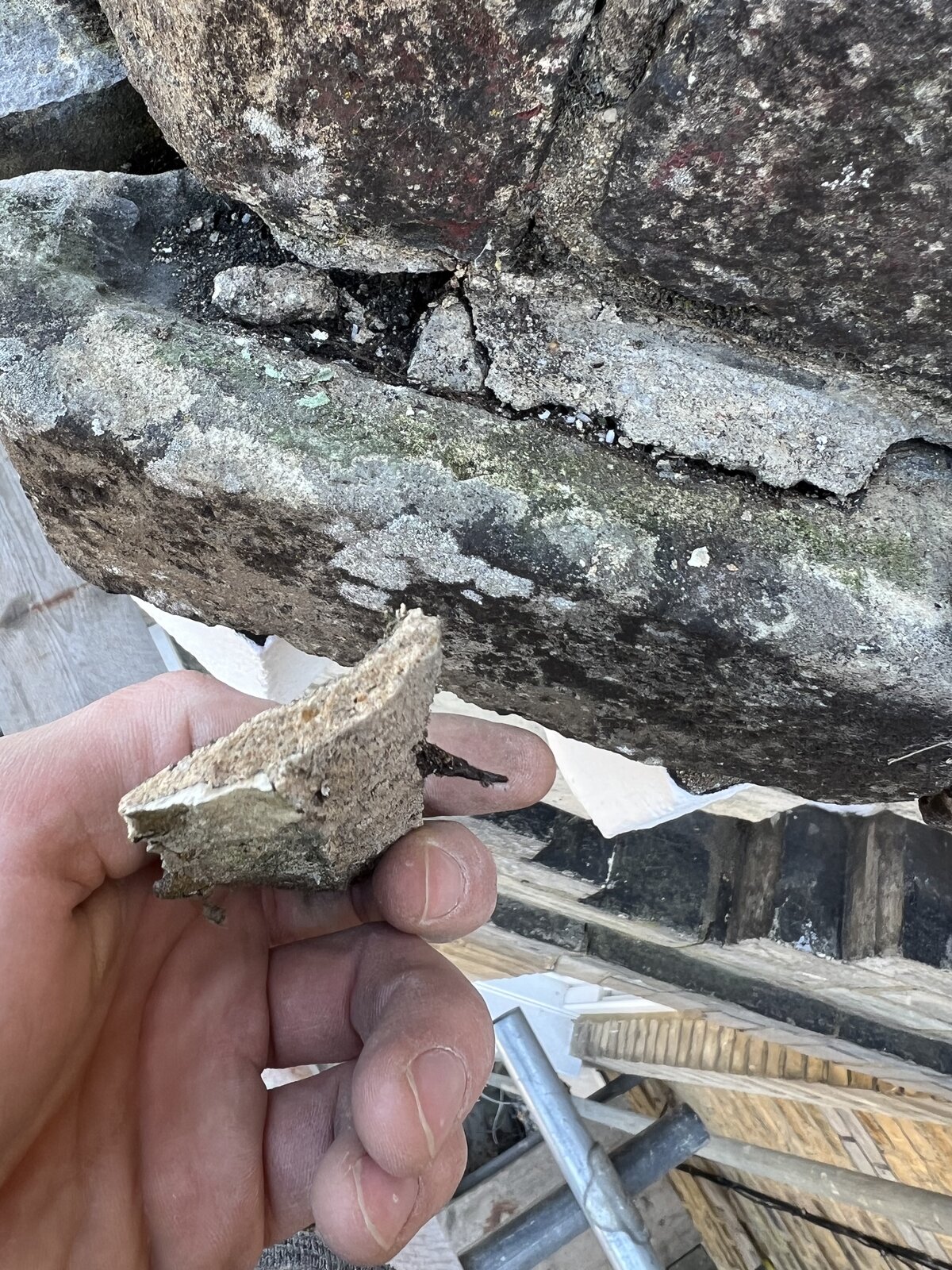

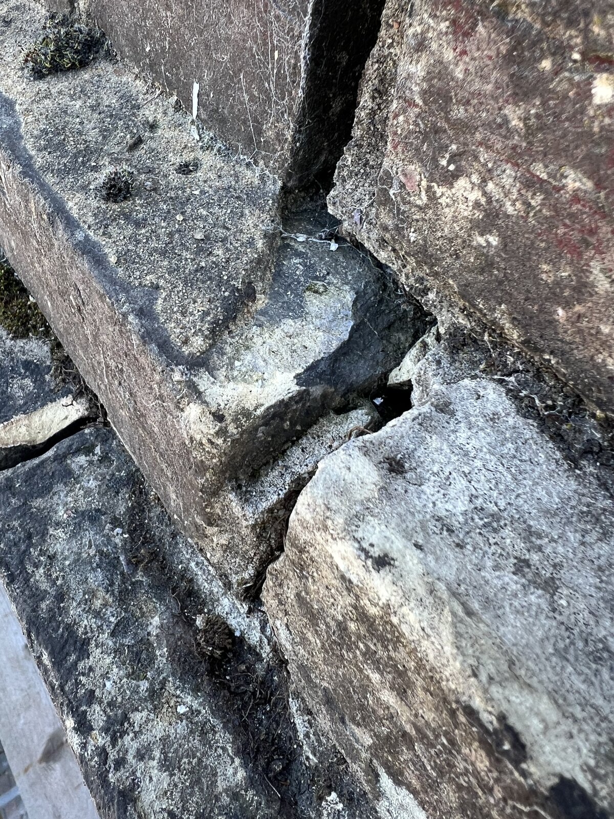

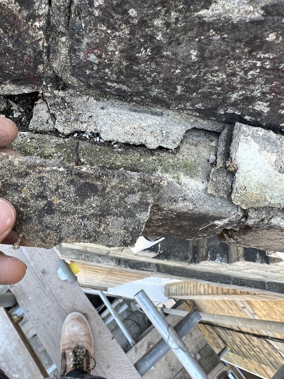

To lime point or cement point ??!!
I have a bay which all the pointing has eroded, cracked or fallen out and weeds which grow out the top. It needs re doing probably top 3 courses, not sure if a normal lime mix will be too white and weird on appearance, client doesn’t want to pay for diff clean and rather not jet wash but could do lightly on just Bay Area. I can’t fully tell if it is lime. And if would be bad doing it cement but rather do what’s right.
Please advice

Waw, looks bad.
If it were me, i would rebuild it......remove those top 2 courses and then see if the last course is as bad and re bed it all...
An excellent guide to identifying the differences here:
There will be a noticeable difference in the colour of the new mortar compared to the old mortar, whichever you use.
This difference may be reduced by the addition of a pigment to match the old mortar. You might need a few tests to decide on the amount of pigment needed.

Drop some of the mortar into vinegar. If it fizzes, it's lime.
Lime is not meant to last forever. In time, all lime pointing will need redoing. But it's kind to the bricks or stone, as it's softer.
Use NHL 2.0 and a sharp sand.

True for what it is, debating new bricks but hard to find same, some are so badly damaged

Many thanks! Yeah will look different but hopefully as it’s the section that steps out will look less weird if you see what I mean.

Thanks will give it a go, seems like normal cement mortar so could go back with cement if it is already
