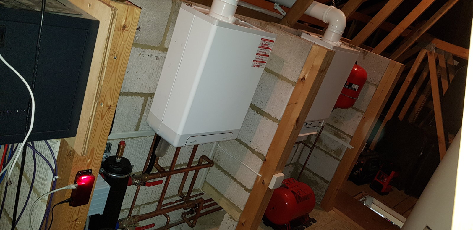

This is one we did recently - the big white thing on the right is a cylinder in the loft too.
Sounds promising then :-) That loft space is massive compared to what I have available though (pic to follow). Thanks for the guidance.
