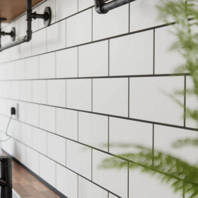

I bought these:
Toying with the idea of a contrasting grout (nothing extreme, maybe light grey) however on the box it states for their matt/satin tiles, recommended white grout only. For their gloss effect tiles, any grout colour can be used.
Why is this? Due to the matt/satin finish and risk of colour bleeding through the tile?
I bought these:
I set green tiles around a door a few years ago and wanted green grout to go in the gaps but couldn't find a close enough match. Most recommendations are for a powder that adds to regular grout but it comes in 1kg bags and was far too much for what i needed. Smaller pigments are available but expensive, so it comes down to how large an area you want to cover.
I like the example in the link: the green edge looks great around the white tiles.
I think I'll need to email them. I read it more (the guidance on the box I mean) that they are recommending white grout only for their matt/satin tiles due to the way they're made i.e. the finish on the surface. Almost like a warning.
It's likely they advise that because the colours will stand out too much beside the matt finish and render the tile a white space between thin coloured lines, like a large crossword puzzle. If you were to opt for a near-white grout it could work, but a test piece would be best before you sally forth into a world of woe and regret.
Emailed the supplier. They confirmed they've tested other colours on this tile without issue. The manufacturer has apparently advised the guidance on the box requires updating.
Grey grout here I come!!!
Don't forget to find a silicone the same colour. Mapei have a wide range of silicones that match their coloured grout.
