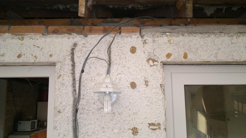

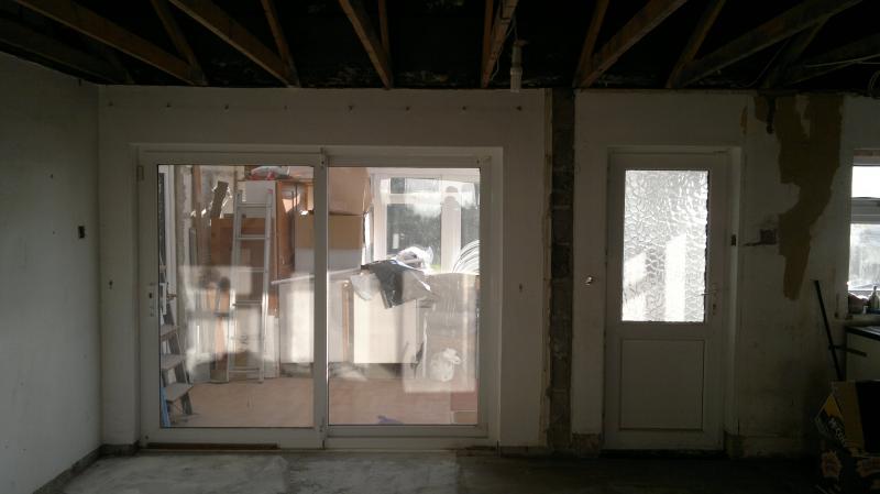

Can anyone see any problems with removing the patio doors and the single backdoor and installing a bifold unit instead.
what size steel would we be talking about, and what sort of cost, its a bungalow, with concrete tile roof. have a builder coming to have a look the weekend, and would like a rough idea at the size and cost of the lintel before he gets here.
have a mate who can sort the door , so just lintel price if you may
Complete opening would be 3m 90
Cheers in advance
Nothing difficult about that. Should be a simeple case of removing the existing lintels and installing something like a 203X133 UB with a bottom plate.
Or it may well be more cost effective to use a Catnic for that opening...

Yes, the numbers are the dimensions of the beam, as you thought.
The bottom plate is a piece of steel welded to the bottom of the beam and sticking out, to carry the outer leaf of masonry. The beam itself would be positioned under the load bearing inner leaf and the plate would pick up the few courses of outer masonry.
Would work in a similar way if the wall isn't cavity.
Although as the doors would lead into an extension, you might be just as well using a wider beam and boxing it flush with the wall.

catnic do a heavy duty lintel which is just a 203x133UB with a 6mm steel plate welded underneath, check out catnic's website, I'm sure most steel fabricators could knock up a cheap replica.
