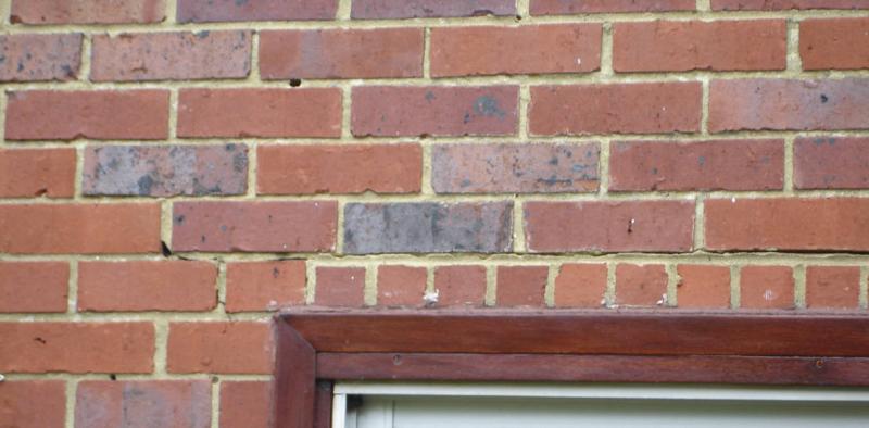

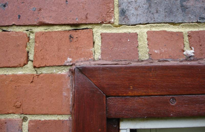

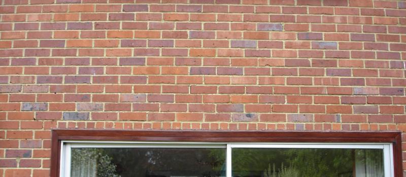

OK here are some pictures. Although there is some crcking, it's been like that for 20 years since we have been here. There is some DPC showing just on the top left corner.
Click picture to enlarge
PS have cancelled the new door until this is sorted out !!!![/img]
It looks a straightforward job to support the wall just above the brick on edge with strongboys and take away the BOE and insert the iron.
[GALLERY=media, 21092][/GALLERY]
It looks like an 18 inch Hyload tray has been used, although ideally it should go directly on top of the frame as there could be some water penetration through the crack in the bed joint between the BOE and the course above.

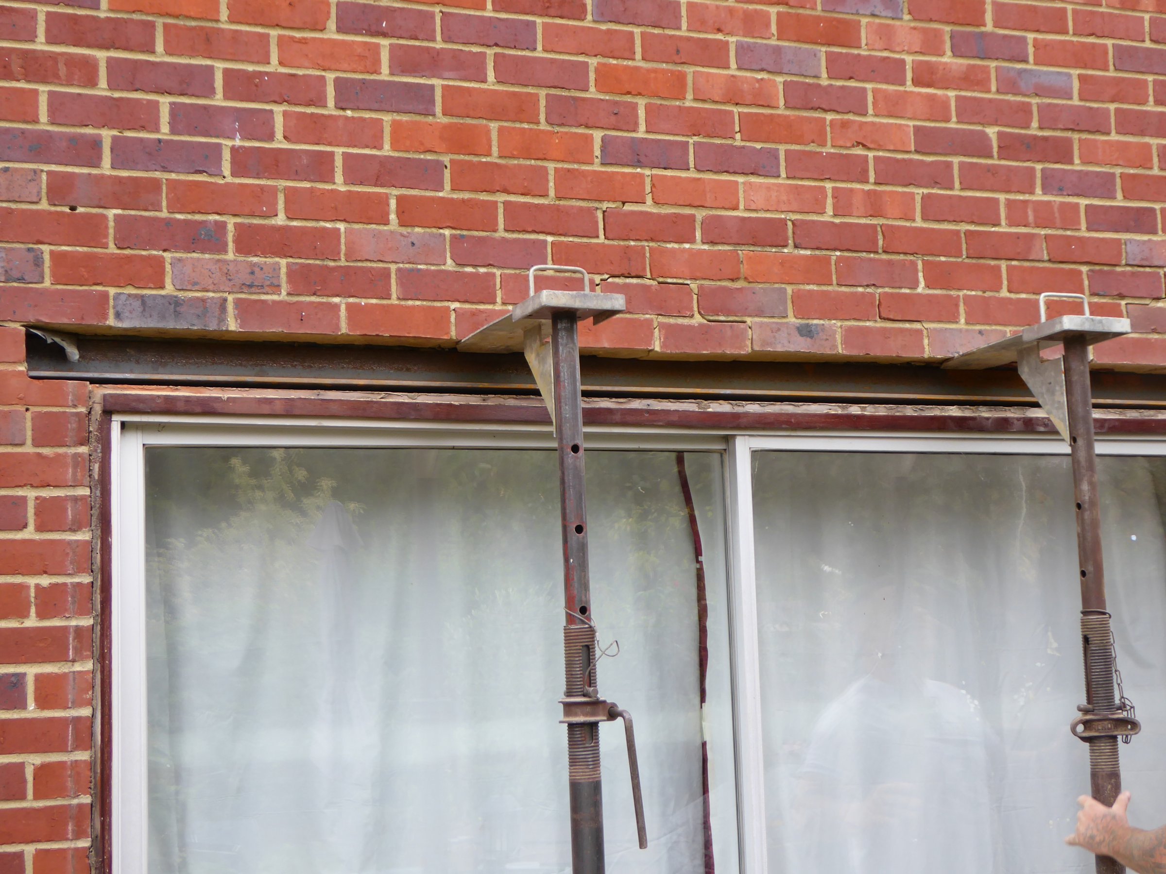

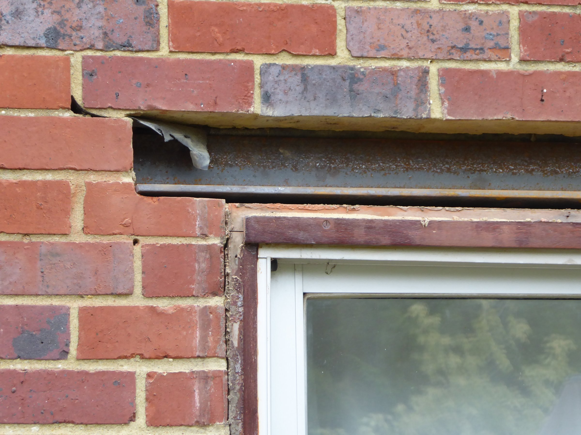

Hi all, this is my old thread but the job is still pending !!! Last week (1/6/2016!!) took the external architrave off the frame and saw the front edge of a steel. It is the front edge of a 1/4" thick galavenised plate, persumably the front edge of some sort of lintel. We measured the height at the sides and middle and there is no drop. That was the good news.
However, the visible edge of the steel plate is the same width as the frame and the edge on bricks course - it does not extend into the side brickwork. The bottob of the EOB course is not level with the side course - it 1/2 way up a course.
So the question is what kind of lintel is it ?

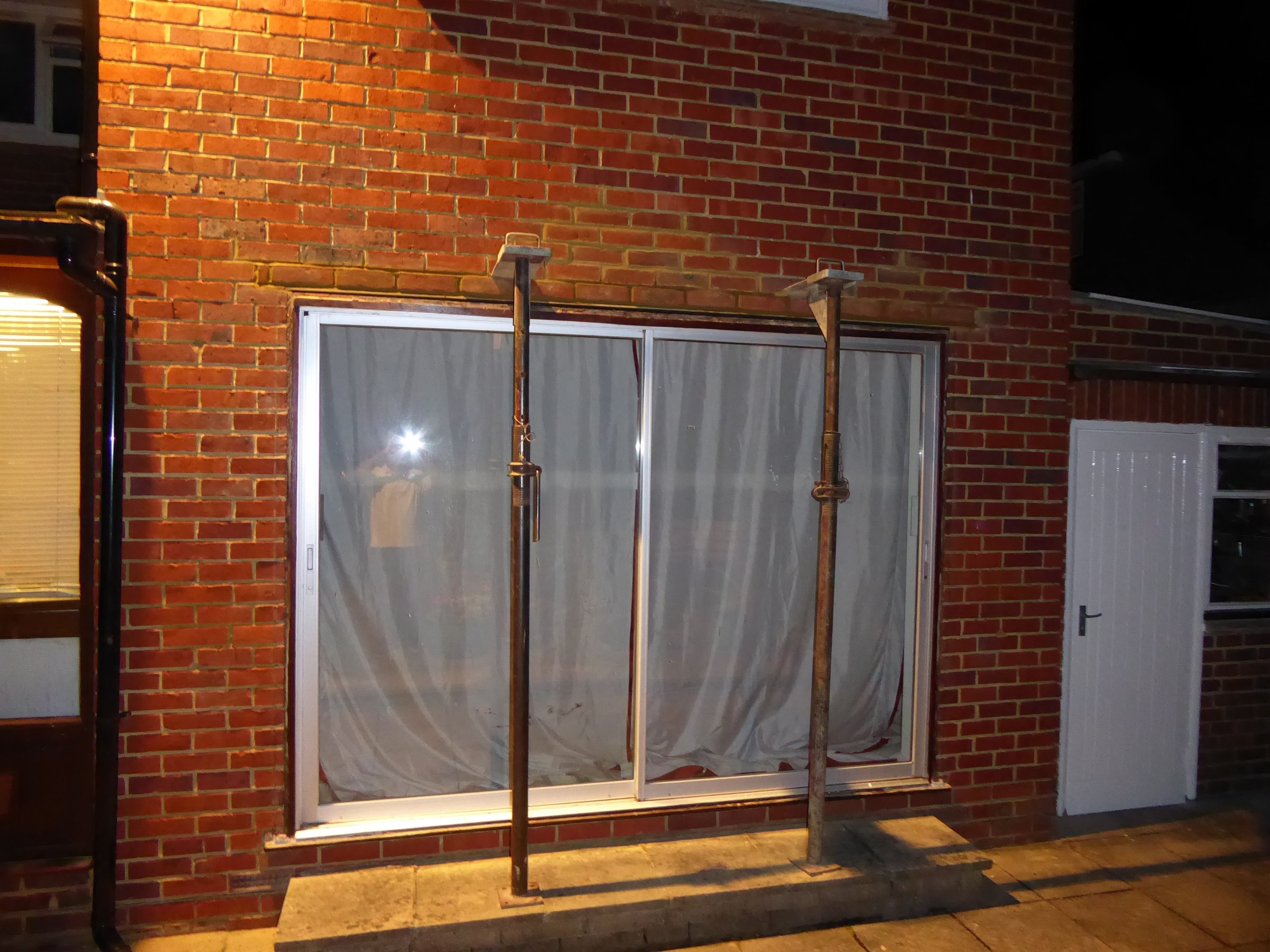

Well !!! after over ten years we've finally had the job done. There was a steel angle above the old patio door frame but is was only resting on the wooden frame. So the installers supported the brickwork, took out the half bricks above the frame andtook out the old steel. They have now installed a new heavy steel angle spanning well into the bricks at each side and put in a straight course of bricks. The acrows will be taken out when the morter has cured and the new door is on site ready to be installed.
