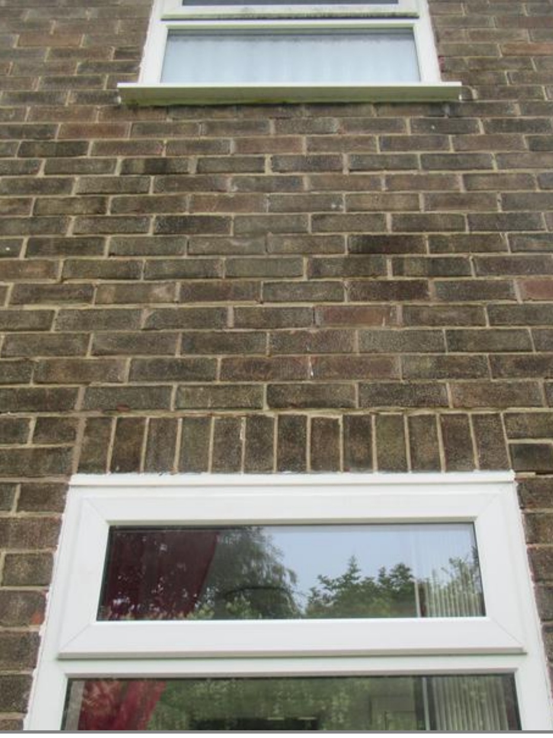

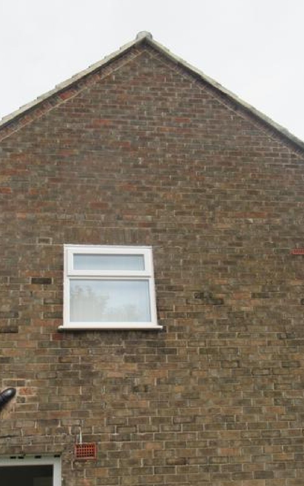

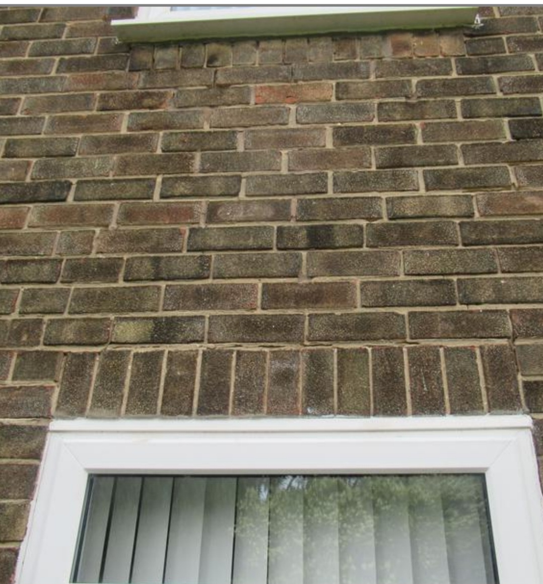

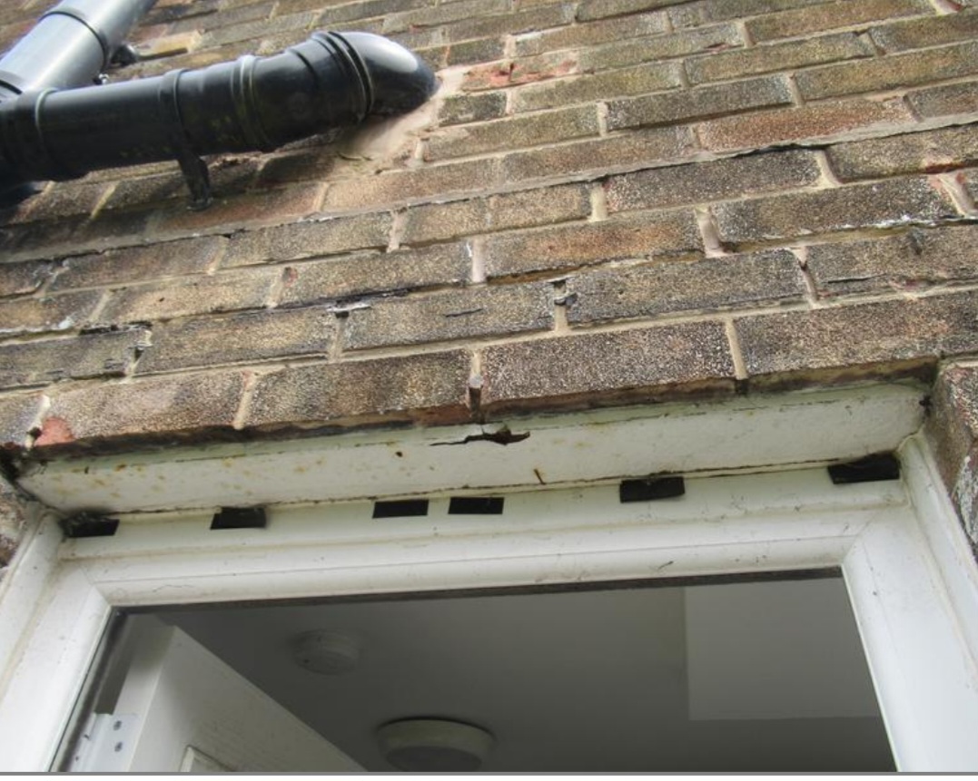

I'll attach images because the surveyor's report has indicated the potential of no lintels being present and with the brickwork being in soldier pattern/type as well as no signs of a protruding lintel, or any rust, I believe this is a large possibility.
I have read and been told that in houses of this age (around 1965 construction) metal or wooden window frames were used and considered part of the supporting structure so no lintels were used. When double glazing is provided, it's often overlooked in putting in a lintel although required.
The extent of what I can see is in the image attached below if this is of any use?
