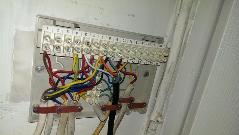

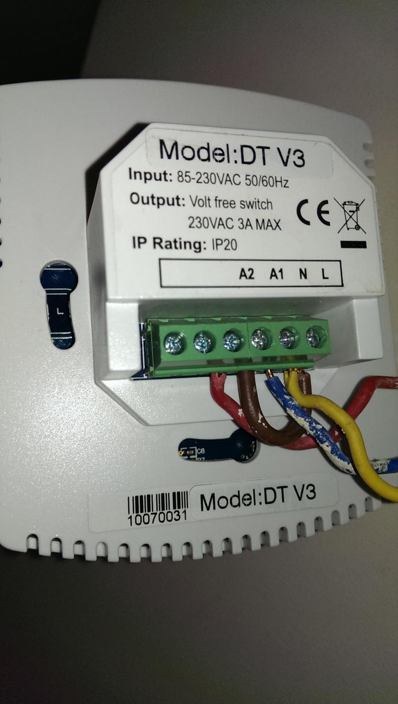

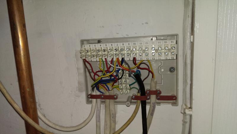

Can you post a photo of the junction box wiring and the back of the stat?
Pics attached.
From left to right cables are:-
- To heating and hot water timer controls
- Mains input
- Tank stat
- Room stat (where I had moved yellow cable from 4 to 1)
- CH pump
- Motorised valve
- Boiler
Thanks for your help with this, much appreciated.
looking at the manual you have it wired correctly, your live has to come from the time clock in order to give you timed heating, however i expect the problem you are getting is the display goes blank when there is no demand from the timer as no live is getting to the stat?
Probably would have been better to get the battery model if you wanted a live display all the time.
Or you could have bought a programmable room stat, then you could just have left the heating on the old programmer on constant.
Thanks Dean and Picasso. The situation is exactly as you have stated.
Funnily enough I actually searched for a digital without a battery as I did have one previously but it ate through the duracells like they were smarties. So I thought the Heatmiser DT would be a good replacement as a basic digital stat without programmer, so seem to have created my own problem!
I will leave it as it is for now with the stat only being powered when the heating is on and perhaps look for a Heatmiser PRT so I can use as an alternative timer, leaving the existing permanently on.
