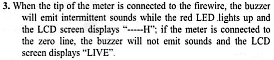

3.Live zero and live line wiring detection: in LIVE mode, insert the meter head into the hole to judge the zero and live line display H with beep, and the zero line has no response.
The instructions are in small print, so near impossible to read, it seems the function is to detect which live terminal is line, and should show ---H for line, and LIVE for neutral, however I get ---H for both, has anyone used a multimeter with this function before.
ANENG A3005 is the meter I have been given.

I would say the meter is not as good, now scanned instructions which say
seems odd to say LIVE for neutral and ---H for line, but that is what the instructions say. Also a non contact volts range
which I also have with my clamp on, but instructions seem wrong, it shows with both meters -, --, ---, or ---- and the LED and sound increase with flashing rate as it shows more - across the display. Same idea as volt pen, but it shows 5 levels no detection it shows EF. Both clamp on meter and pen meter are the same with that, so use to that function.
But not seen this 'firewire' function before. 1725488131502.png hence asking if anyone else has come across it. I have an adaptor like this
which is about the only way to access live outlet, earth shows LIVE (no volt) and both Line and Neutral show ---H I managed to open shutters on an extension lead with same result, but line and neutral both show ---H.
It is not a function I really want to use, not sure why my wife got it for me, the clamp on does most of what I want so really no point in having a second small meter. I do like the NCV range, but this 'firewire' seems useless.
