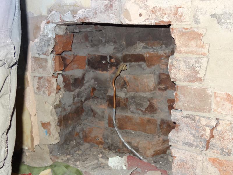

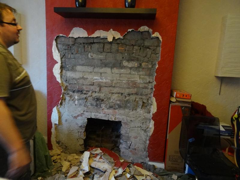

We have just purchased a mid terraced property, & are really wanting to make a statement of our chimney breast, so andy decided to take hammer & chisel & bash away at the plaster 2 see what was lurking underneath.......
As you can see from the photo, it's 1 hell of a mess/bodge job (so I think).
Anyway, the questions we have are...... Do we need a lintel & can we possibly go deeper into the breast or is that as far as we can go?

Lets have the picture and a proper answer can be given.
Normally you will find a lintel in place supporting the hole made for the fire.
Depending on age of property and type, the lintel will vary in size and position. This will then determine whether the hole can be made bigger, without any more structural work being done.
look at post from : specialk july 12 2011, and research this subject on this site. there's plenty of info and pics. Dont go any deeper into your fire opening, the wall at the back is a party wall.

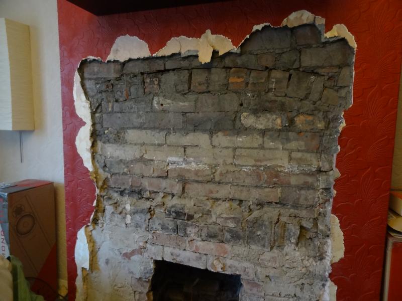

Dunno about deeper, but you can go higher.
That arch 11 courses up was the original lintel for the fireplace.
Measure the outside depth of your chimney breast then measure the fireplace depth, its possible it was packed out with bricks for the gas fire?
