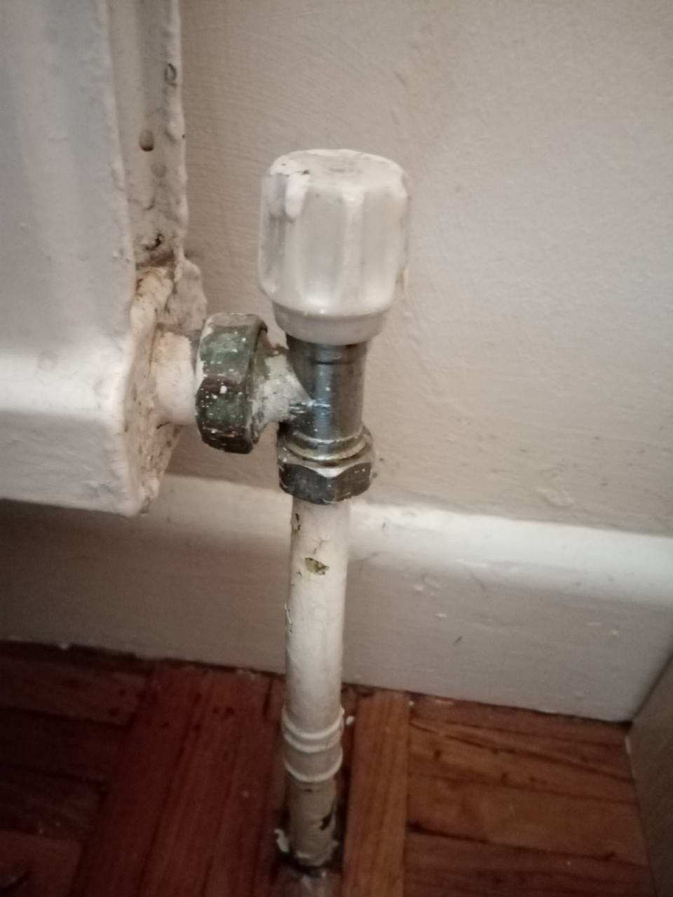

Post a picture of jammed valve.
Is the pipe plastic and what diameter
All metal pipe and fittings except the actual turning cap itself of course. 15mm soldered copper piping. Have attached photo of one of the jammed valves.
They look ancient.
I'd be removing the rad and flushing them out.
