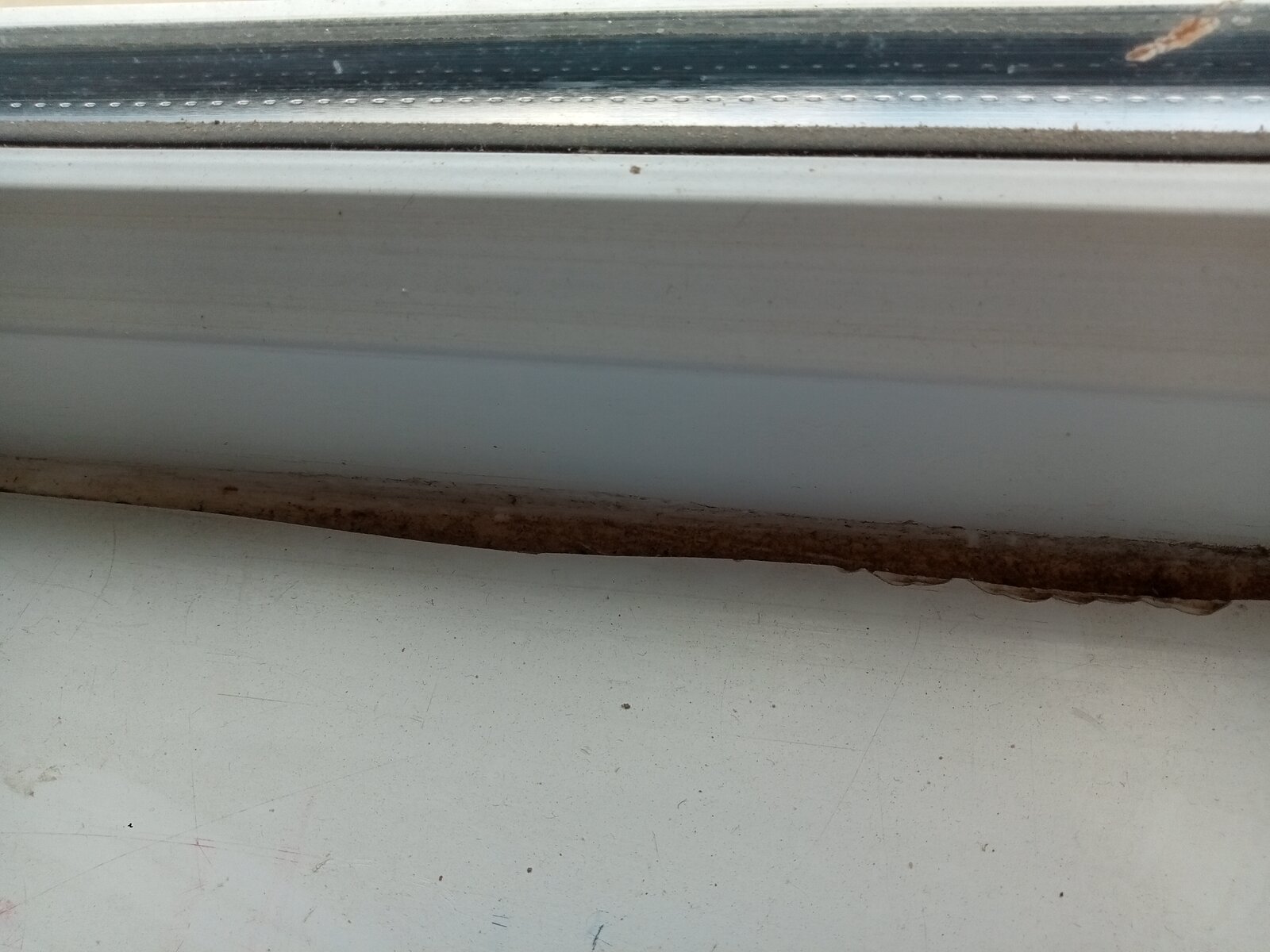

Living room window sill coming away from window

Hi all. What would you do to fix this? New windowsill or some kind of fill job?

I'm going to be a pedant here and say that is a window board. The cill is on the outside.
The board should be fixed down to the wall beneath it using screws, but if it is coming away is it loose or solid? Caulk may well do for now, but you need to check if the window board is properly fixed in place

I live in an unattractive mock art deco (1950's) building that originally had the hockey stick bays (Crittalls windows). Wouldn't the still and window board be the same piece of timber, or were they two separate parts?
Window boards in traditional work were always rebated along the back edge and housed into the lower back of the window frames, regardless of whether or not they were sash windows or casements. With metal windows and modern work it was/is more normal to butt up to the rear of the window, but with shrinkage you can see the sort of thing the OP has. It's quite common on all-metal Critalls, too. The cill is on the outside often with a drip groove routed on the underside and may be machined-in, or again housed in. There are all sorts of variations, but interior window boards need to be separete pieces because you just can't tell where the spreads (plasterers) will finish the plasterwork
