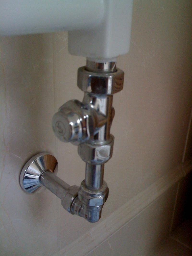

Hi, I have this valve on my towel radiator:

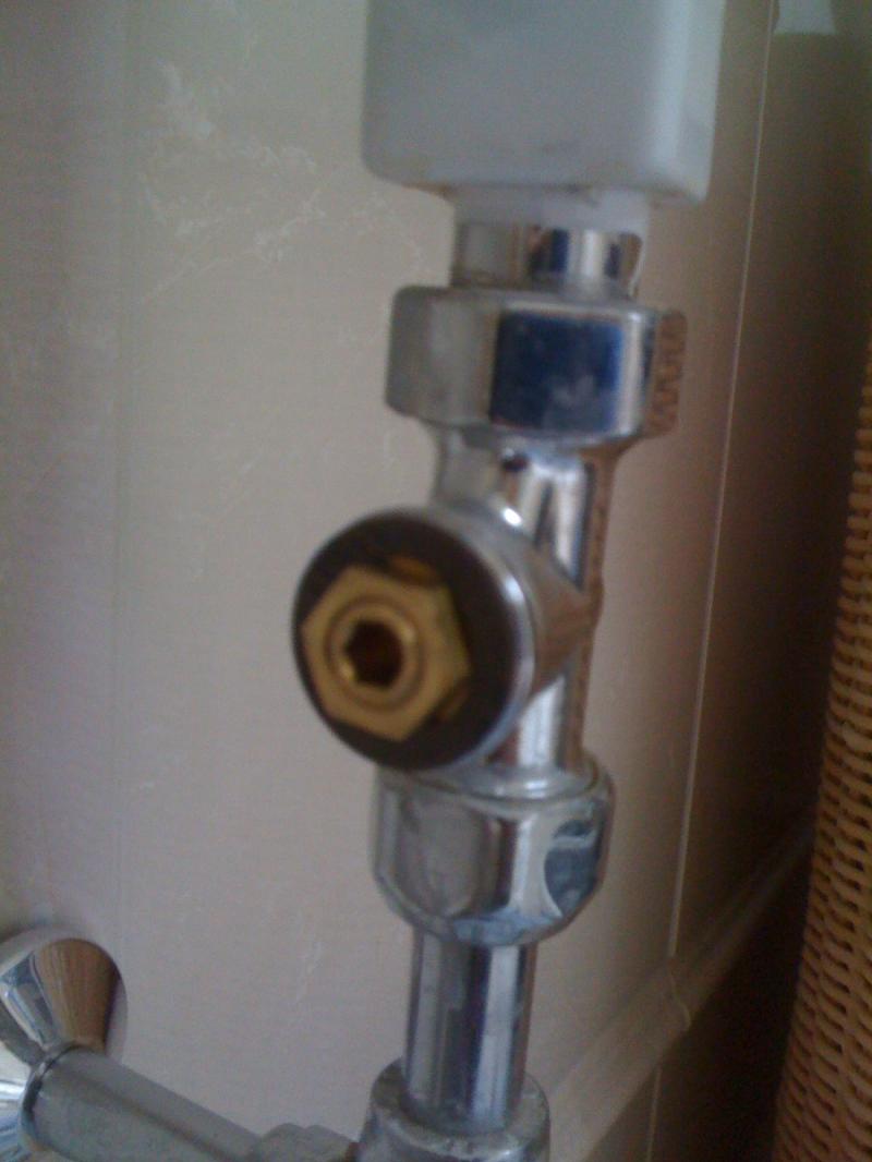

I need to change the bleed valve at the top as it looks like the rubber o-ring has failed and under pressure its it leaking slightly. How do I close the lockshield? Do i need to use an allen key, insert it and turn it clockwise?
Thanks in advance for your help

If your quick I wouldn't even bother locking off the valve. Undo the vent then with your finger used as a bung replace rubber and screw the vent back in.
Live on the edge once in a while eh :wink: plumbers time is money get in get the job done and get out... if you have the knack, same outcome less work. :D
And if it's pressurised to 2 bar and the original poster is asking about the "O" ring round the half inch outside of the bleed valve
he'll get soaked AND need to repressurise the system :roll: :roll: :roll:
Ned presumably wouldn't bother. :roll:
Shut both valves and let the first squirt of water out through the bleed.
Chances are its a bathroom, top floor, chances of air in that rad. All things considered you could get away with it... I wouldn't normally do it on a rad downstairs but the fact that its a towel rad with the vent on top and its an upstairs rad you wont get gushes of water out of it.
