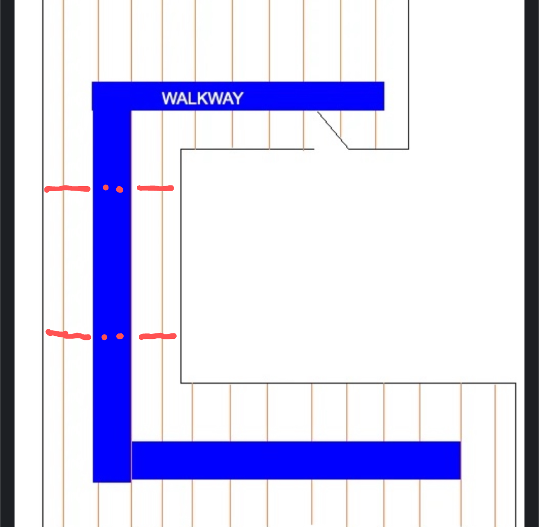

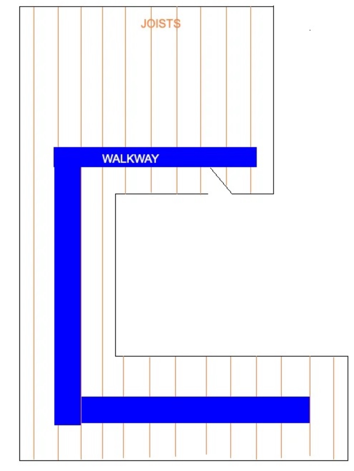

Hello,
I'm trying to figure out laying loft boards in my attic. A few points:
  • My boards are 1220 x 320 x 18mm
  • I've got loft legs to lift up 200mm
  • I was trying to create a walk way anyway between 300mm up to say 800mm wide
  • My joists are 400mm apart
I'm trying to figure out how to do, a few questions:
  • Since three joists across would be 1200mm, do I need to trim 20mm from the 1220mm board if I want to put these in a line, or should I build them like a brick wall, sort of offsetting each one so they aren't in a line?
  • How do I do the run down the left side? Would I need to still make sure the boards are perpendicular? I'm thinking I could either cut them to be 600mm wide, or even I could add another bit of wood at 90 degrees to mean a 600mm wide piece could sit on three boards.
  • Is it a problem if I put the board only on two joists? I read that three is ideal, but would mean I couldn't cut my current boards in half down that line.
Put some timber across under walkway so it's braces to spread weight.
I've never used legs so not sure.
If flooding onerlaps I didn't think it mattered.
