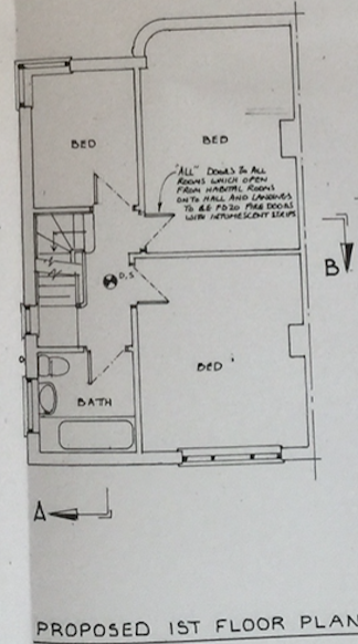

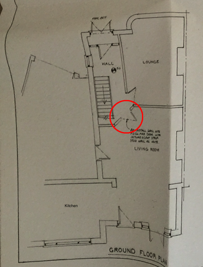

I am having a loft conversion and the building inspector has asked a wall and fire door to be installed installed in my downstairs area to separate the stairs as an exit.
I have attached a drawing and the red circle is where he is asking it be built. Also attached the first floor layout - loft stairs above main stairs.
Other measures going in are fire detectors throughout the property which is fine.
Is there a way around doing having to have the wall and fire door downstairs as don't want to block off the open plan feel?
Would it be possible to have fire escape windows on first floor instead for example?
Thanks for the help all.
Not much use as an escape route for people trapped in the loft by toxic smoke ( or fire ) on the stairs down to the first floor.
If every room in the loft had a safe escape route through windows then Building Control might consider relaxing the requirement for the separation of the stairs at ground floor level. Climbing out of a window onto a sloping roof is never a safe escape route.
I meant all the first floor windows, not the 2nd floor that way those in the loft could escape through the first floor.
I guess sprinklers are a very expensive option.
To escape the people in the loft would have to come down one flight of stairs to get to a 1st floor room with a window through which they could be rescued. They would have to know which rooms had windows suitable for an escape and be able to find them in the dark and panic of escaping from a burning building.
If the stairs and first floor landing are filled with toxic smoke then getting down the stairs and finding the door to a room with a suitable window would be difficult.
Many people die from smoke inhalation on the stairs trying to find an escape route in the smoke.

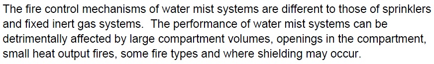

As stated in a separate thread; Have a look at mist suppression systems. I've not used one, but they start at about £500 for a (very) basic installation. But check with your BCO if this is acceptable to them.
I am in the process of converting my loft. My stairs exit in the lounge & I have had plans approved by the council using this system: http://www.plumis.co.uk/Fire-refurbishment-building-regulations.html
Hope this helps
