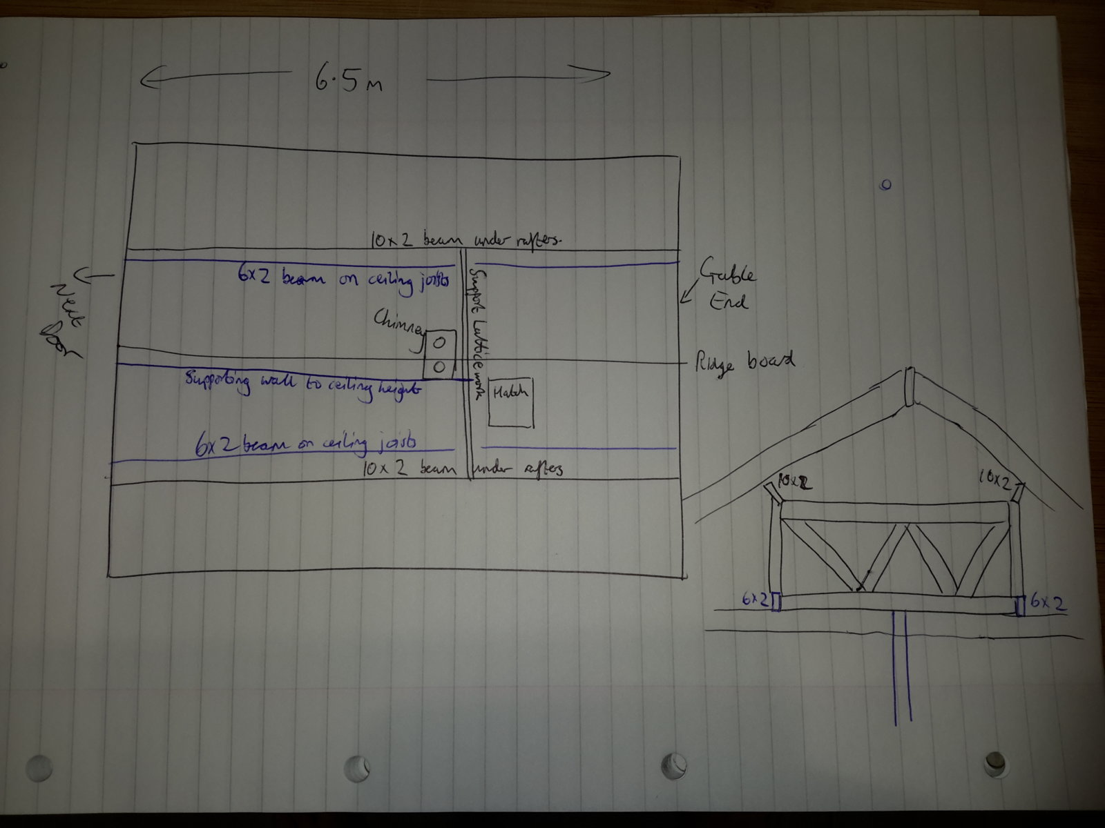

I live in an awkwardly built 1950s semi. However the loft is huge. It has massive potential. Our adjoining neighbours have told us they had a quote for a loft conversion and it was more expensive than the 2 storey extension they had built instead. When I look at the structure of the loft I see why it might be expensive, but wondered what the options are to clear the structure.
The left image is the plan. The joists and rafters run with the lined paper. The right image shows the cross section where the support lattice is in the middle of the loft. This lattice sits about 5 inches away from the chimney, and appears to transfer the weight from the middle of the 8x2 rafter supports onto the middle wall of the house. None of the other walls upstairs are supporting - all built onto the first floor with no support underneath. The lattice is constructed from 6x2s nailed together old school with 6 inch nails.
At the moment the left side of the loft is pretty much inaccessible.
So what can i do to eliminate this lattice support? Something is telling me the only option is to have a steel running front to back (shortest span) where the lattice is. This could then be used to support new joists (though would loose about 9 inch of headroom as theyd be at 90 deg to existing) Anything else that could be done? I appreciate this is not a diy job, just wondering what options are there.
Normally you would just run a steel beam along each side (where your 6x2s are) and build a stud wall off these to support the purlins, then hang your new floor joists off the steels, there's nothing complicated about this one.
The span is 6500mm though, wouldnt these steels be prohibitively big and expensive?
Depends on your idea of prohibitively expensive? Maybe something like a 254 or 305 deep beam @ say £50/m + 4 connections so prolly about £1k or so I'd hazard. You know your conversion will be say £30-40k + fees?

If it's 6.5m side to side, what is it across the loft.
about 5.5m front to back. The central head height is approx 2300mm to the current ceiling joists.
That's make it 2.7m from the central wall to the sides, so you might be able to use flitch beams to support the purlins.

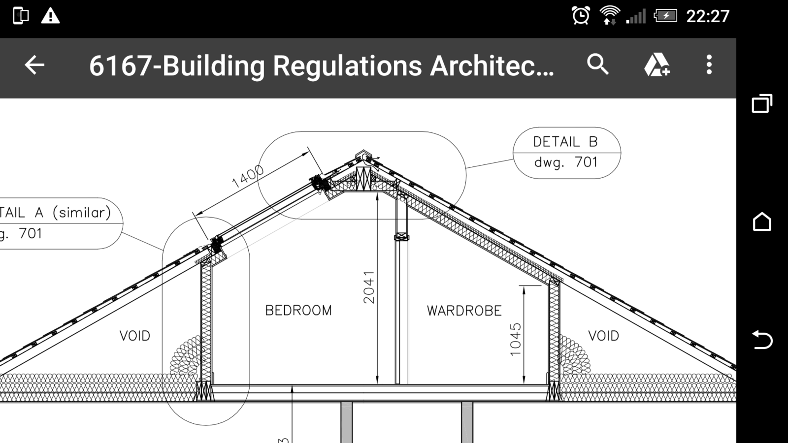

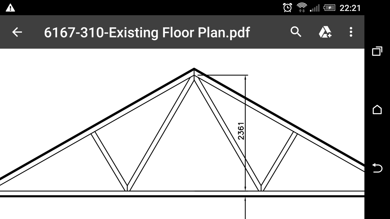

Here's a before and after section for a recent loft I did, personally I think the owners were nuts for pursuing it but Heyho, gonna be awfully cramped IMO.

And as the new joists would reduce the floor height, that would make matters worse. I wonder if the neighbours quote was to reduce the bedroom ceiling height to increase it in the loft.
