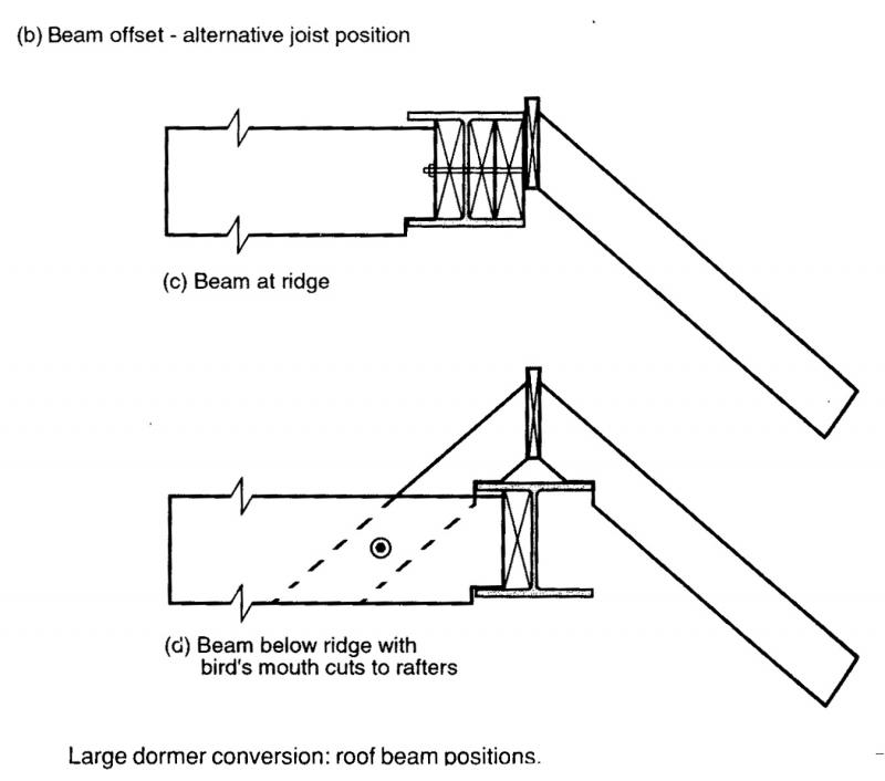

I have other threads running regarding a predicament over Building Control plans - and their lack of suitability for the job.
I've tried to keep it short, and with the minimum qty of steels :wink: sic
Plans are approved and ready, but I would like to raise the ceiling joists in the flat roof, on plan they bear into the webbing of the steel support beam just below the ridge, with a warm roof, as per 'd' on the diagram, I would get better ceiling height if arrangement 'c' was used, but I am concerned the BC officer would'nt allow such a change without new structural calcs being required.
If 'c' was accepted, would I run the 115mm Cellotex Temp Check Deck over the steel beam (plans require this on top of the ceiling joists) to satisfy insulation requirements. (to be under highest point on the roof - for planning purposes - is that the ridge beam or the ridge tiles)
If 'c' wasn't accepted, and I had to accept the beam in position 'd' could I bolt timbers to the steel beam, fix joists hangers and hang joists - higher than the steel.
They won't need new structural calcs. None of the member spans or loads will change so the calcs will still be OK.
That will raise the (approved?) dormer roof height and will also alter the ridge height and appearance which may not be acceptable to planning.
So moving the ridge up (200mm approx) and to the right (100mm) to option 'c doesn't effect calcs :)

But with this arrangement I'm now presented with the problem of insulation and venting of condensation, (a warm roof steals 115mm of height - which would be good to avoid doing), I have read somewhere - if the voids between rafters are filled completely with insulation - there is no room for condensation - I assume voids are to trap air which is an excellent insulator - joists are 175mm thick - surely the underside of 175mm of insulation would remove the likely hood of any thermal bridging, or am I barking - up the wrong tree.
Out of interested for option C - how would you install this and keep the rafters in place? I can see how the option D steel would be install with the current roof in place. However option C looks like you’d need to take down both sides of the roof, then rebuild the front/rafter side? Therefore Surely Option C costs considerably more to achieve
