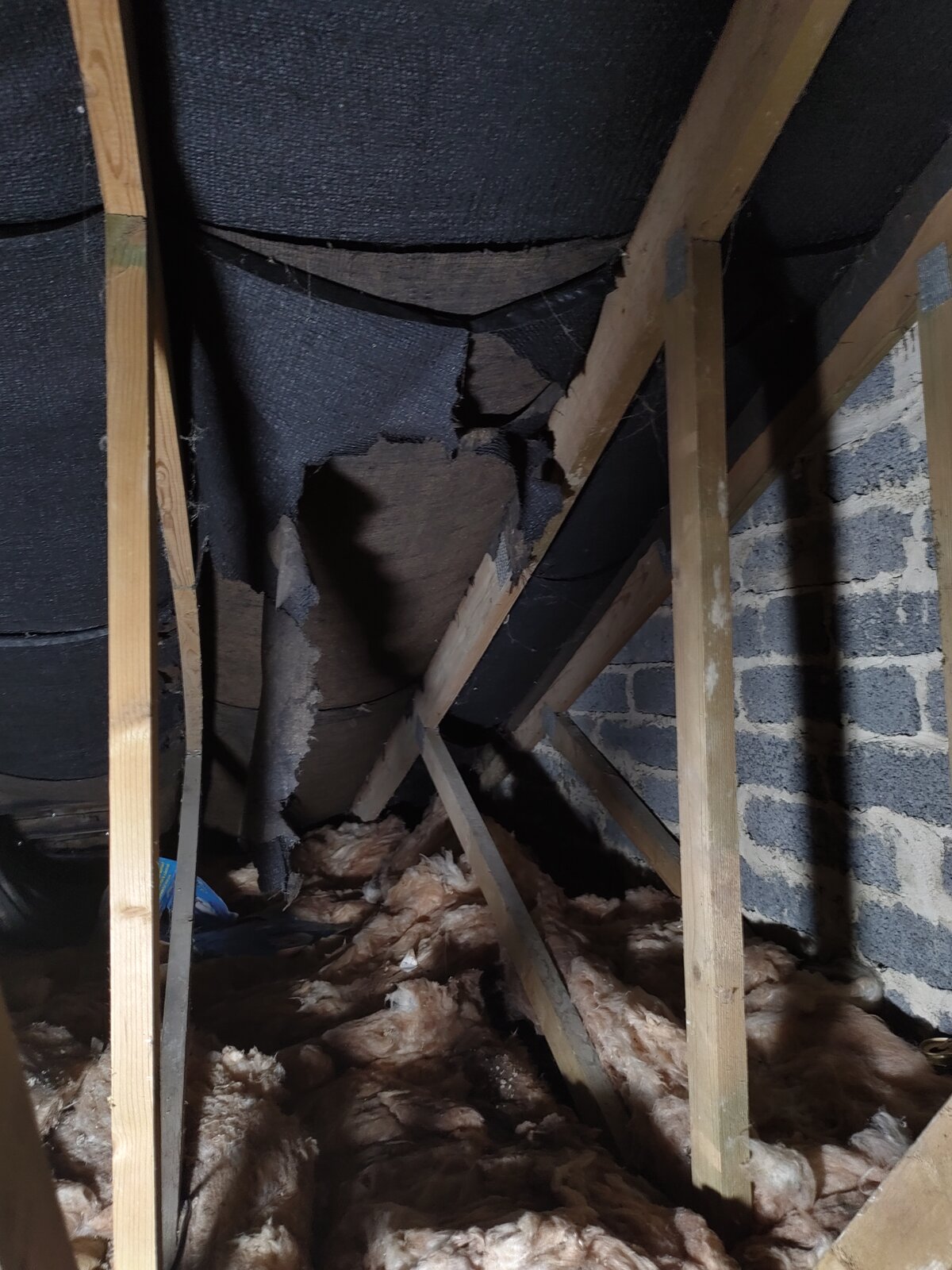

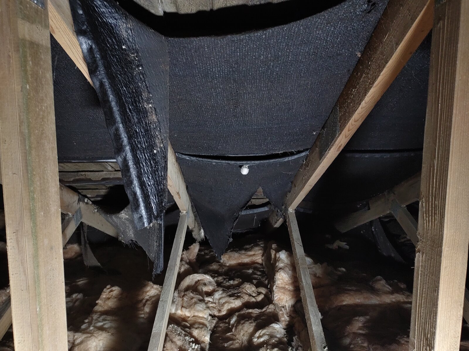

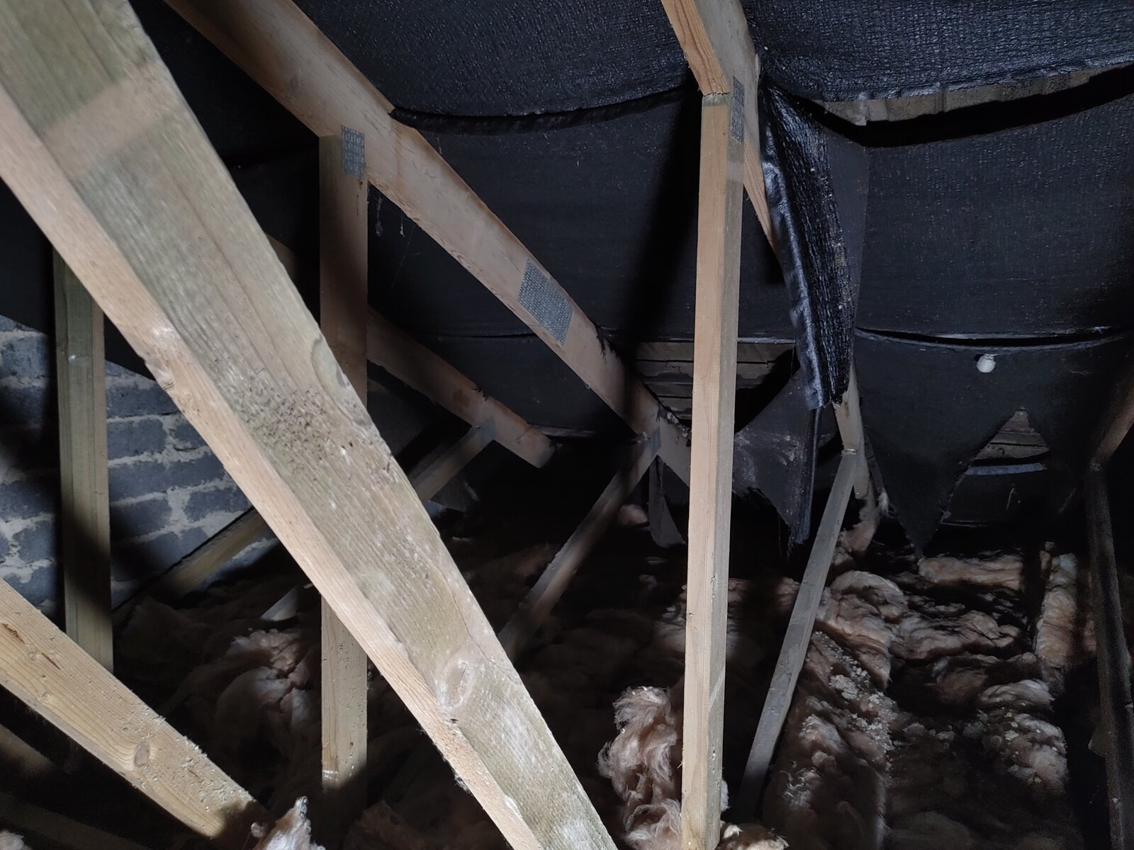

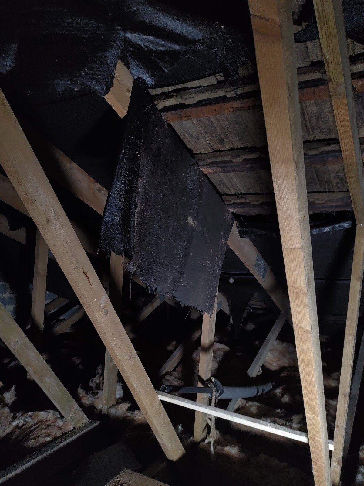

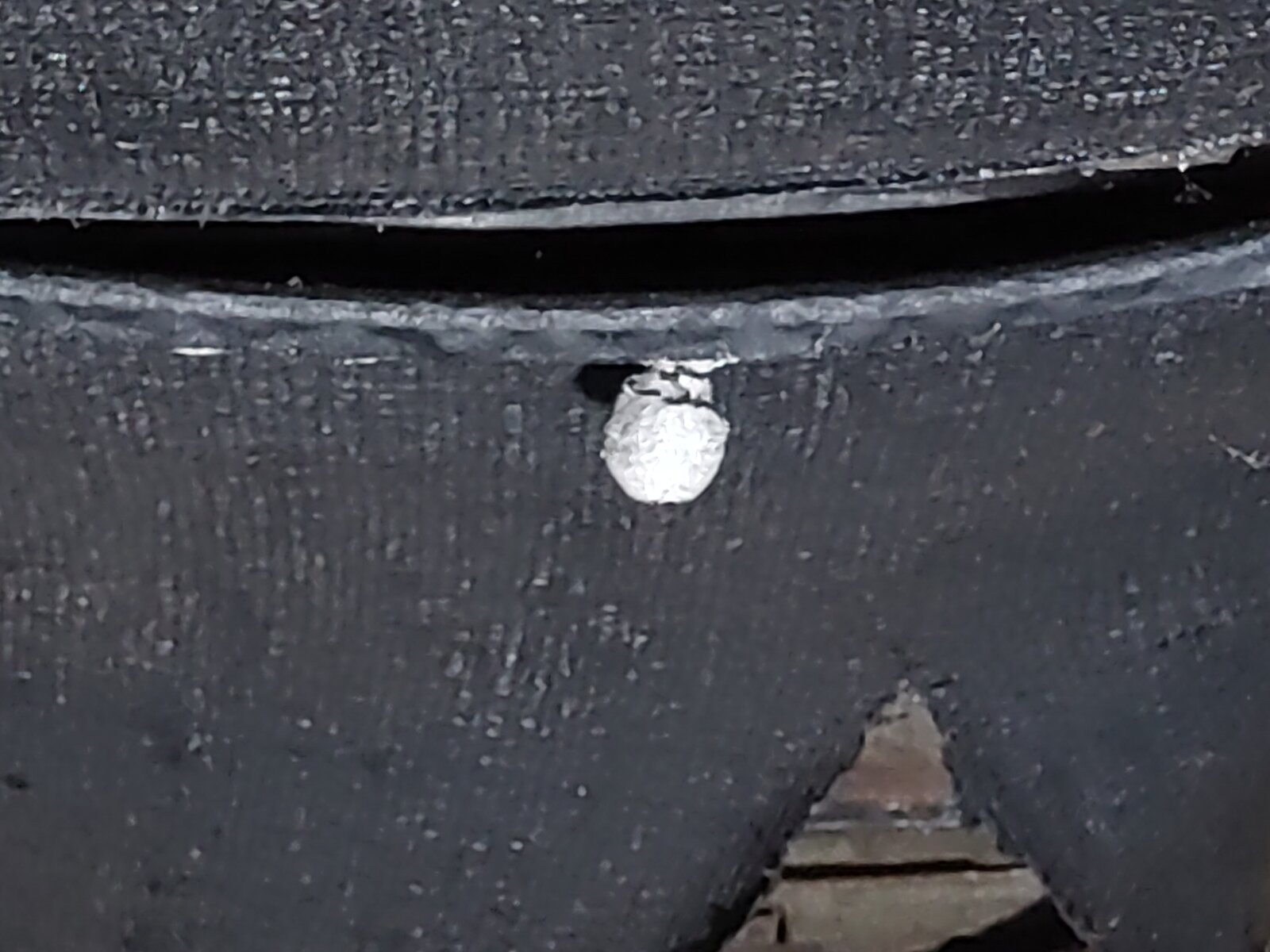

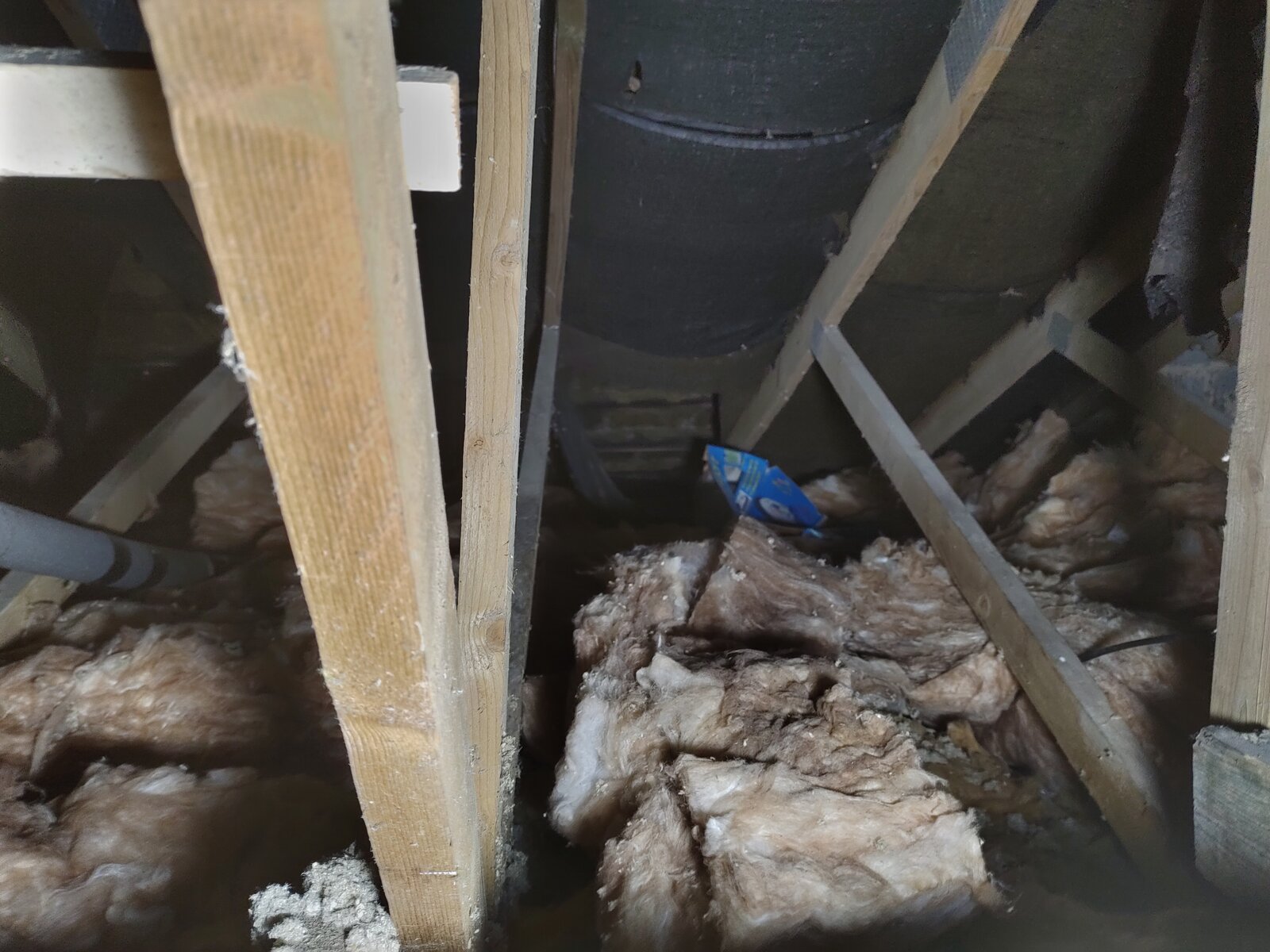

Hi all. I heard dripping on the ceiling of the first floor when it was raining outside so I went into the loft the next day to take a look and I think I may have a leak somewhere.
Do the pictires indicate a requirement to repair from inside the loft or from outside the roof?
Also, is that a wasp nest??? I thought they were only active in summer and are abandoned in autumn.
Thanks.

Yes it is the start of a wasp nest but unless you see activity it's probably dead.
Is anything wet in the loft?

The nest still being there fits in with the idea of it being 'abandoned'. They don't take it with the when they're finished. If you go near it with a hoover you'll find it shatters into dust [my loft had at least 5 of them].

Hi. Thanks for your reply. The loft is part boarded but empty. I touched a bit of the insulation and it did not feel damp but it may well have been further below.
Unlikely to have heard dripping water onto fibreglass insulation and not have it wet. The felt condition doesn't mean it will leak (mine has no felt at all), so look for evidence of water ingress. Also consider the dripping may have been from guttering or similar onto an external window sill perhaps.
