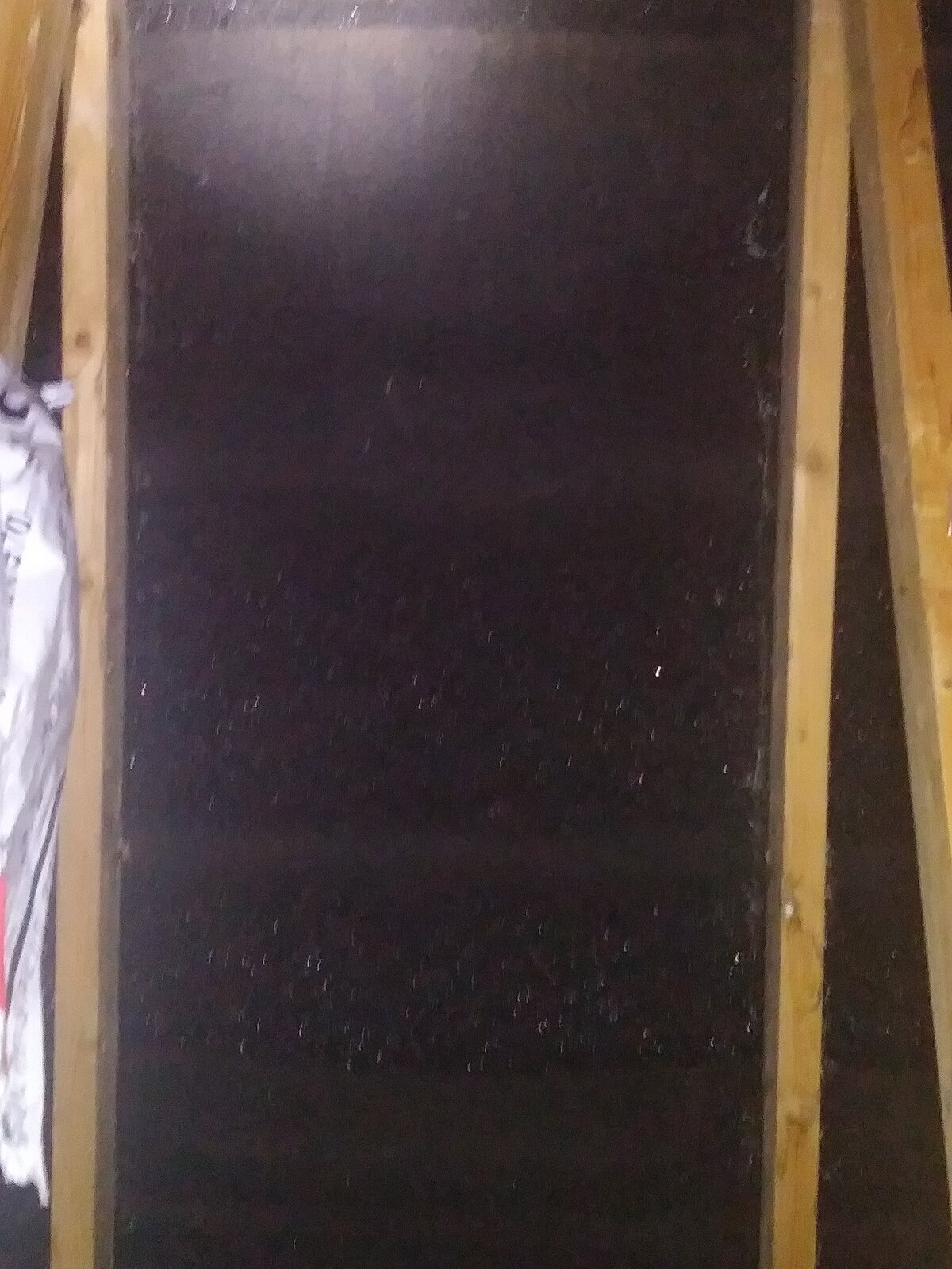

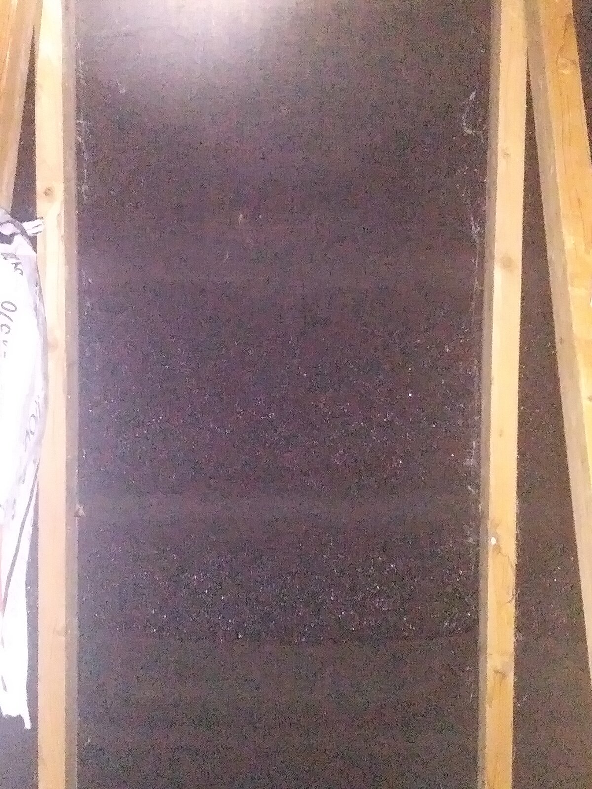

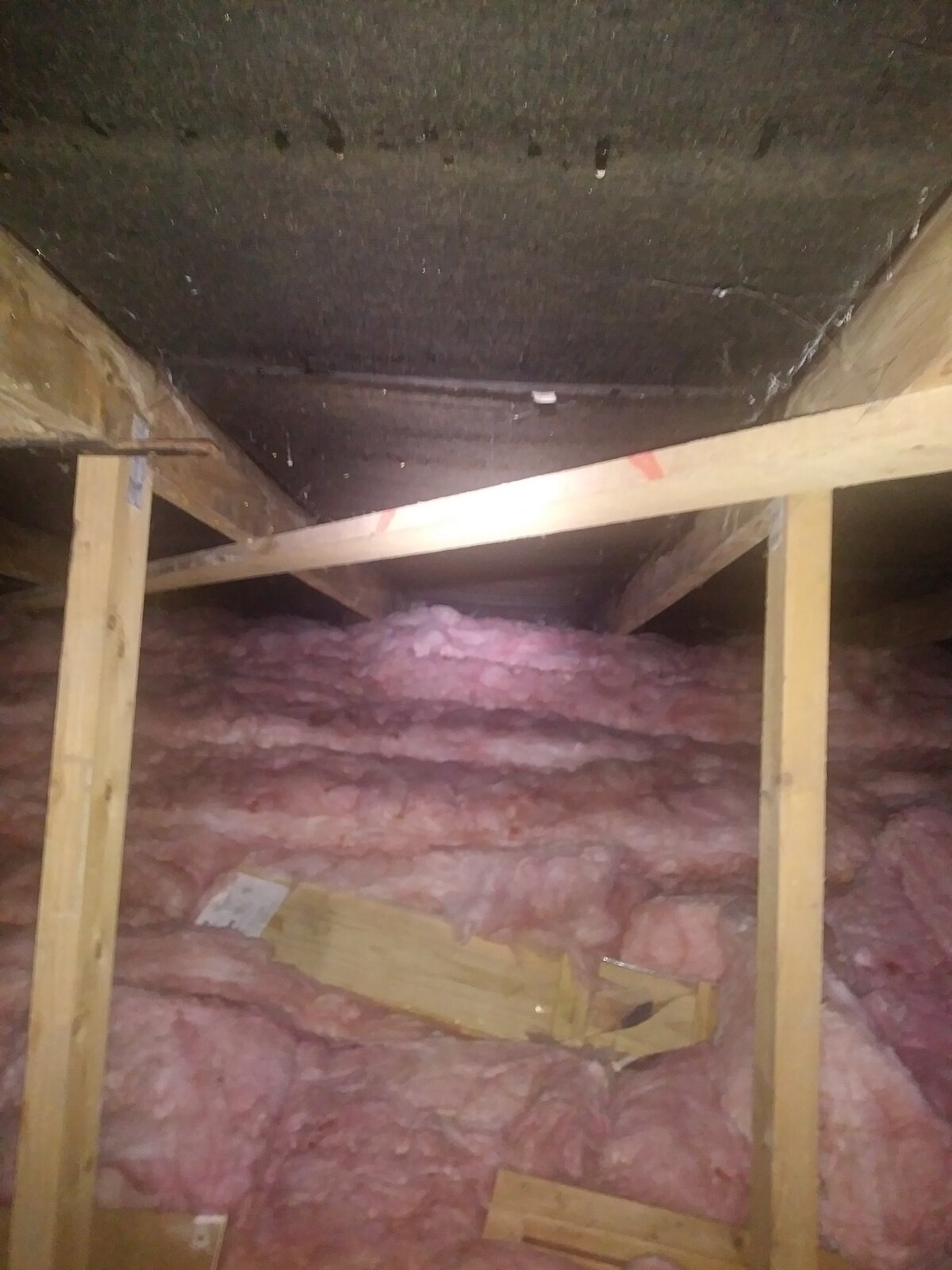

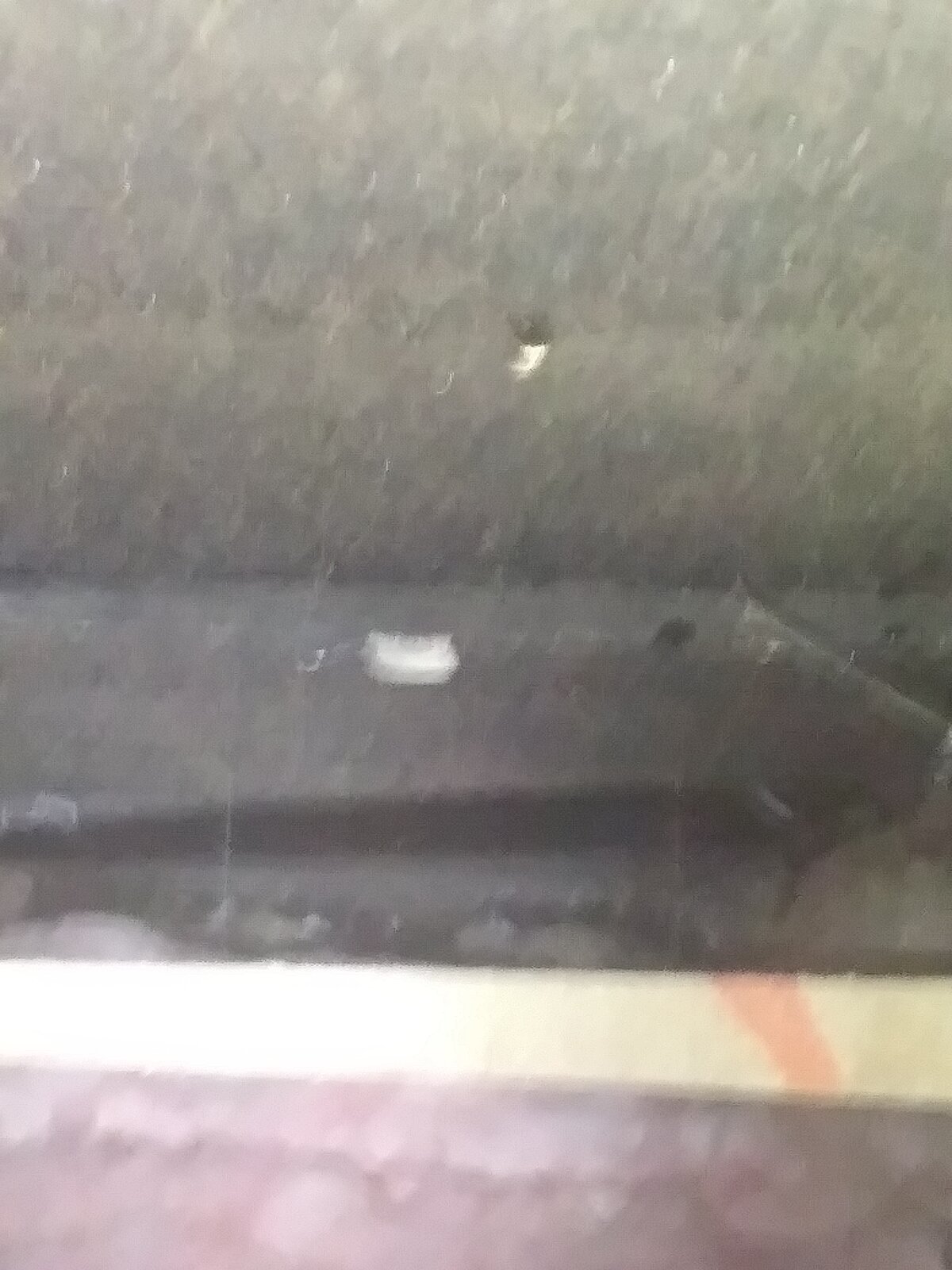

I've just been in the loft to put something in there and while up, I noticed between two rafters light condensation, along with some across the ridge of the roof, between the rafters. No where else seemed affected. Other times I have been up there has been nothing, although this tends to be in Spring and Autumn.
It was difficult to tell by eye if it was water or simply the torch reflecting off the material however upon touching it, it felt wet.
To me, what is odd, is that it is only affecting one part of the roof and not the others, and only on one side. Is this something to be overly concerned about or simply the roof doing its job? There was no sign of mould either.
The humidity in the hall is usually around 55%. We have a fan from the bathroom passing through the loft to an external wall, however, this seems to be working ok. The loft had extra insulation added a prior to us buying it so I believe it's double insulated. When I went up the house was around 20c and outside maybe 0c.
Jim
A bit of condensation at this time of year is nothing to worry about.
Thanks. I've been back up today and little difference. Left the humidity meter but it's around 45%. The insulation isn't over the soffit with the air vents in it and no condensation that low down. A few drops on the insulation but nothing too bad. We do have a bathroom fan that vents through the loft by about a meter or so but the insulation around that is dry.
It's only affecting the west side of the roof so presumably no direct could be a factor. The East side with solar panels appears fine. One or two of the beams looked like they may have a wet line next to the black felt but again, only on parts. A few dodgy images attached.

Update. Humidistat was reading 58% after 30 min in the loft and around 7.5c. Outside it's probably 1-3c. Turned the torch off and from one of the soffit vents I can see daylight so I know some fresh air is getting in.
You can open the laps in the felt if you think its a problem, that way as it dribbles down it can exit out of the roof space. Something like plastic clothes pegs should work to keep the laps open.
