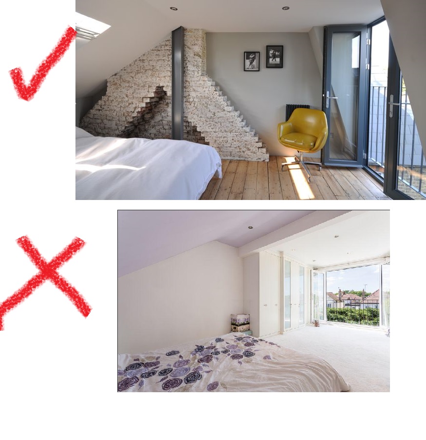

Would you also be able to offer some advice Re: the post at the other end which is bolted to the 100x100 post at my chimney end please ? My engineer has drawn the post to sit within a solid wall spanning the front face of the soon to be created dormer to the rear purlin wall which is sat on one of the 203s . I would like to try and keep the chimney visable but my engineer was concerned about the forward thrust of the highway facing roof hip , I believe he wanted the post in a wall to prevent lateral movement. I have seen examples where a steel has been used as a post and that post remains visable within the room but this means the chimney can be exposed as it is no longer hidden by the posts lateral wall.
I have attached a pic to show you watch I mean, do you think it is possible to have this exposed with the post or should I be looking to switch this post to a steel ?

I have never been asked to do calcs for a box-section support bolted to the chimney front. In any case, it's difficult to quantify because you won't know the crushing strength of the brick immediately under each bolt, where the weight acts; it just 'works'.
For the other end, I can't see why the SE is concerned about lateral support against the push from the hip. The rectangular flat roof of the dormer will offer sufficient support (it acts like a horizontal rigid plate once the deck is nailed down). The flat roof maintains its shape and so resists the twisting moment caused by the hip. In any case, the forces involved are not great.
