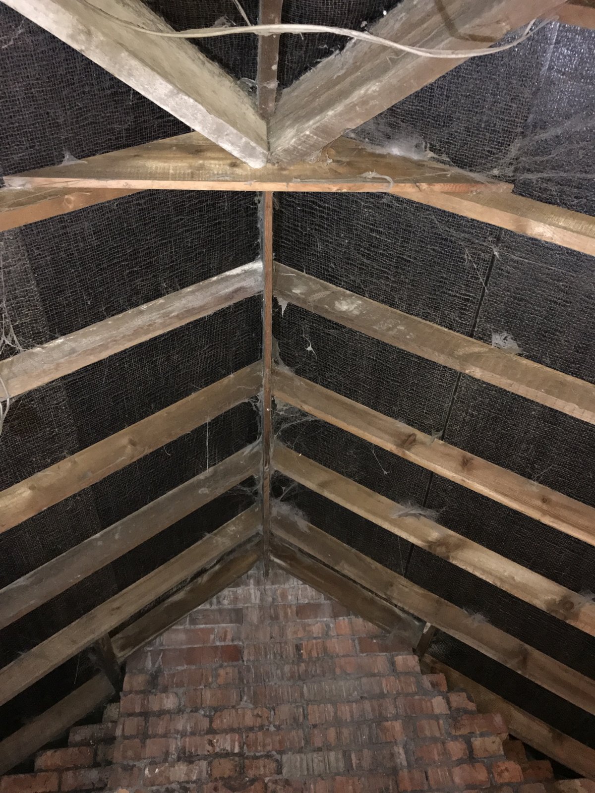

Hi all,
just after a bit of advice on a 1930s 3 bed semi, dormer loft conversion.
The drawings for the steels include a support for the ridge beam to run up against the chimney breast between the ridge beam and a new beam below it.
The chimney breast has already been removed at the lower levels so all that remains is the stack and the breast in the loft, currently supported by steel beams running from the front to rear wall.
The builder has said that he does not believe the support for the ridge beam is required as it wont be doing much and it's worth him discussing it with building control to give us the extra space if not needed.
I just wondered if the ridge beam support is a common feature in loft conversions? I believe its job is to take some of the load off the chimney breast.
Any advice on this is appreciated,
John

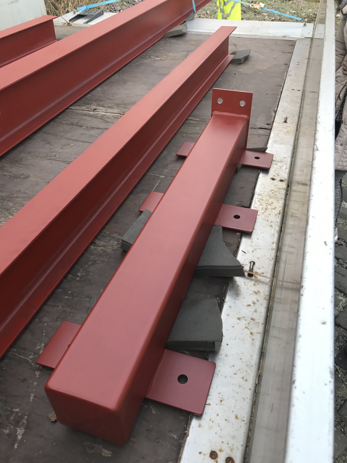

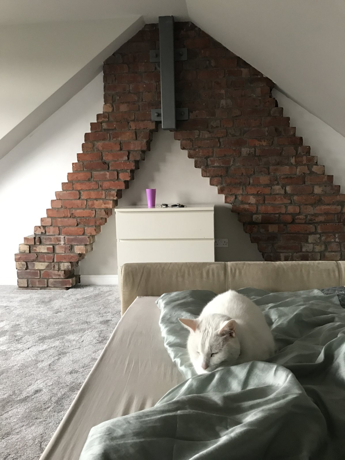

Tony is on about something like this:
As I understand it, you can’t knock into the chimney to support directly off it.
That's a nonsense concept.
Can't bear a beam into the breast, but can fix a massive box section bolted to the very same wall in six places but doing nothing half way up the wall, and then with a skinny 4x2 timber below that?
Who comes up with this crap?

And the original 6x1 ridge board didn’t go into the chimney either

If the chimney is in use, then it is not permissible to run a steel beam into it. Fixing a steel post to the brickwork face to support the end of the ridge beam is perfectly acceptable. The proviso is that no metal fixing must penetrate nearer than 50mm to the inside of the flue, which suggests bolts no longer than about 75mm. As long as the bolts are reasonably spread out, and into whole bricks, then there is no problem.
This is a common method of supporting a steel ridge beam off a central chimney in a party wall; would have thought that most surveyors would understand that?

Hi all,
I really appreciate all the detailed info and pictures, thank you.
The remaining chimney is not in use (supported in the loft with actual steel beams at or just below current floor level), im not sure if that makes any difference to it partly taking the load from the ridge beam. It does sound like the support column is the safe option, but it will still be interesting to hear building controls comments on it.
