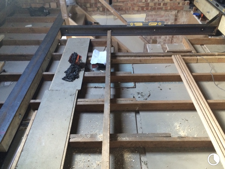

54803B61-3622-4DC0-BEC4-7E4A2801FFB6.jpeg We put a 152x152x37, 254x146x31 and a 152x89x16 to create our floor.
Then a 178x102x19 for part of the original roof.

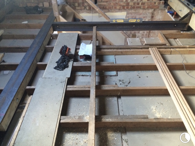

View attachment 162609 We put a 152x152x37, 254x146x31 and a 152x89x16 to create our floor.

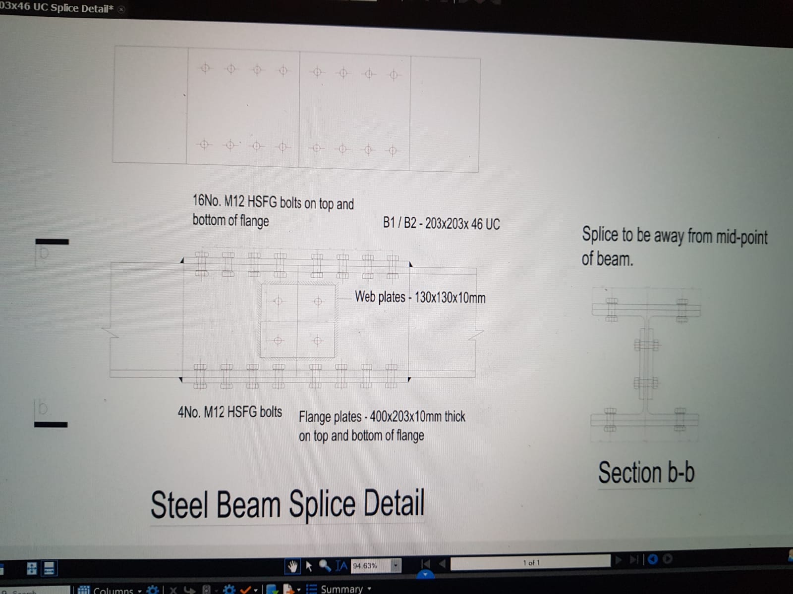

My house is mid terrace so would be a nightmare trying to get full beams in, The 2 x 6 meter beams will be 203x203x46kg, we are getting each beam spliced into 3 peices, each peice roughly 2 meters long. They will be bolted together with 36 bolts and web plates.
A mate who works at a car parts manufacturing place is a welder, he says once in situ he will run a couple of welds along the web plates to make it even more secure.
Just waiting now for SE to confirm if we can use web plates instead of padstones, been doing some reading online and surprisedvto finf web plates, instead of padstones, are now used quite often. Wonder why SE didnt offer that option in the first place?! Would make life a lot easier!
Thats pic of beam joint details from SE

Regardless of what the steel fabricator says, you can have the splice(s) anywhere you want, including in the middle. The point is that a splice has to be specifically designed with regard to the number of bolts; a splice at midpoint, where the bending stress is greatest, will need more bolts than a splice at third- or quarter points.

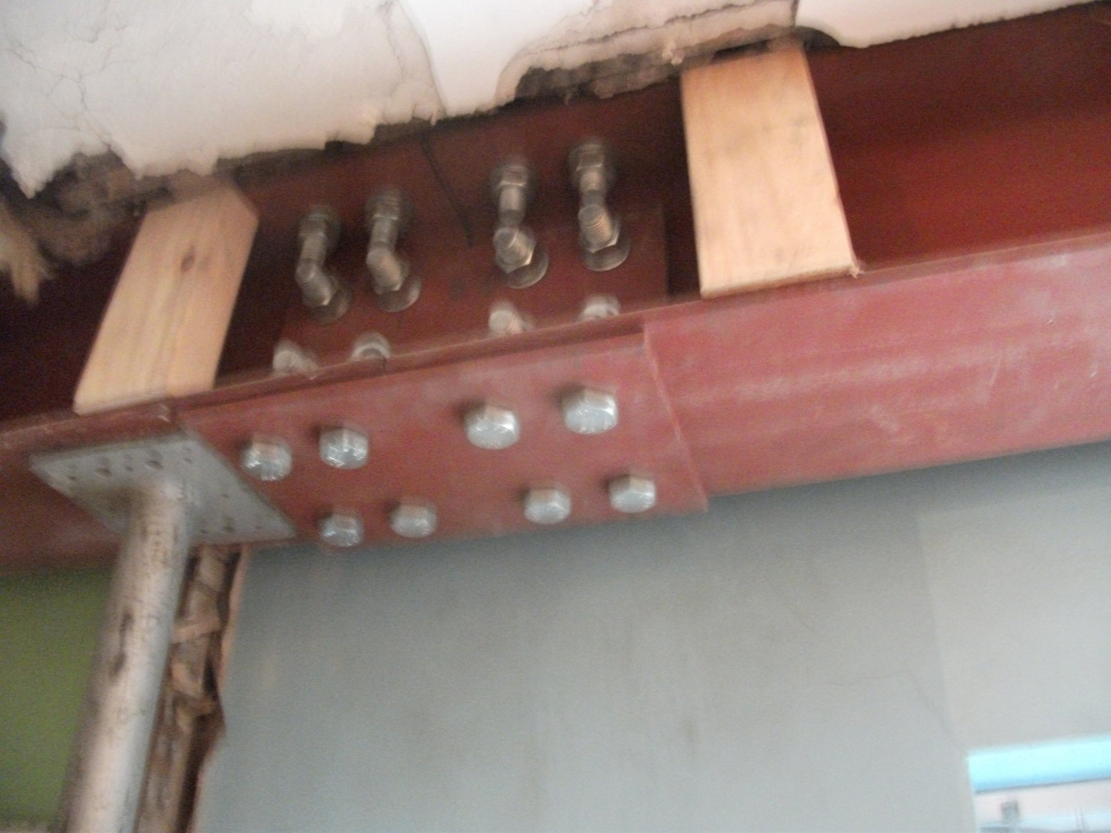

One small but important point; your SE has correctly specified HSFG (High-strength friction-grip) bolts for the splice. Make sure that the fabricator gives you these, rather than ordinary bolts. The difference is that the HSFG bolts can be torqued up much tighter than ordinary bolts to the point where they clamp the plates and beam tightly together by frictional force. Ordinary bolts can't do this, and if you use them the beam will bend excessively - see attached pic where the bolts supplied were wrong and a gap has opened up at the bottom plate.

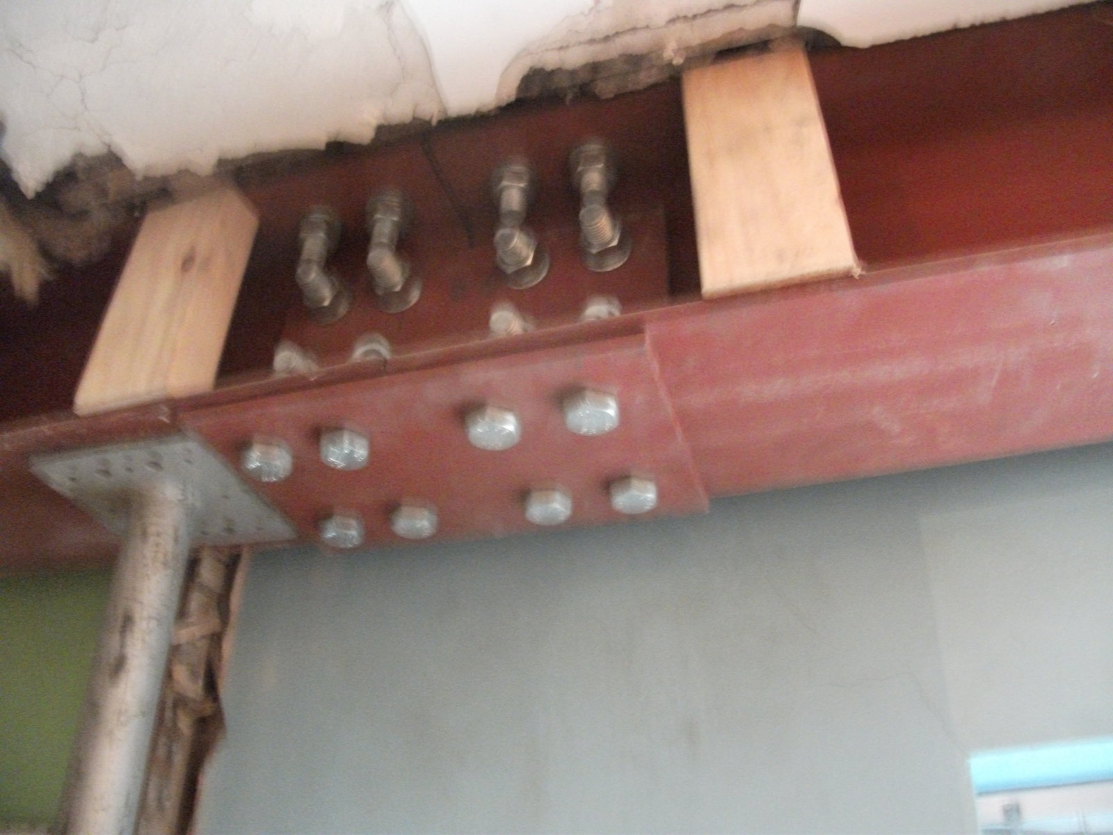

One small but important point; your SE has correctly specified HSFG (High-strength friction-grip) bolts for the splice. Make sure that the fabricator gives you these, rather than ordinary bolts. The difference is that the HSFG bolts can be torqued up much tighter than ordinary bolts to the point where they clamp the plates and beam tightly together by frictional force. Ordinary bolts can't do this, and if you use them the beam will bend excessively - see attached pic where the bolts supplied were wrong and a gap has opened up at the bottom plate.View attachment 162650

HSFG bolts usually come with 'load-indicating' washers with little pips on them. As the bolt is tightened, the pips gradually squash up and when the gap is a quoted particular amount (checked with a feeler guage), the maximum torque has been applied. Some types just state a maximum torque, in which case you'd need to get hold of a torque wrench.
It's also important that the mating surfaces of the beam and plates are not painted, as this reduces the available frictional force.
