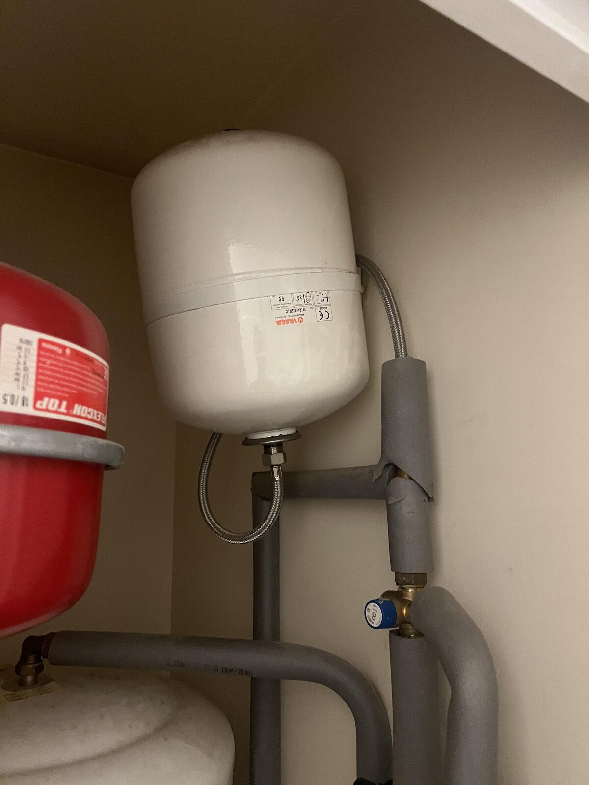

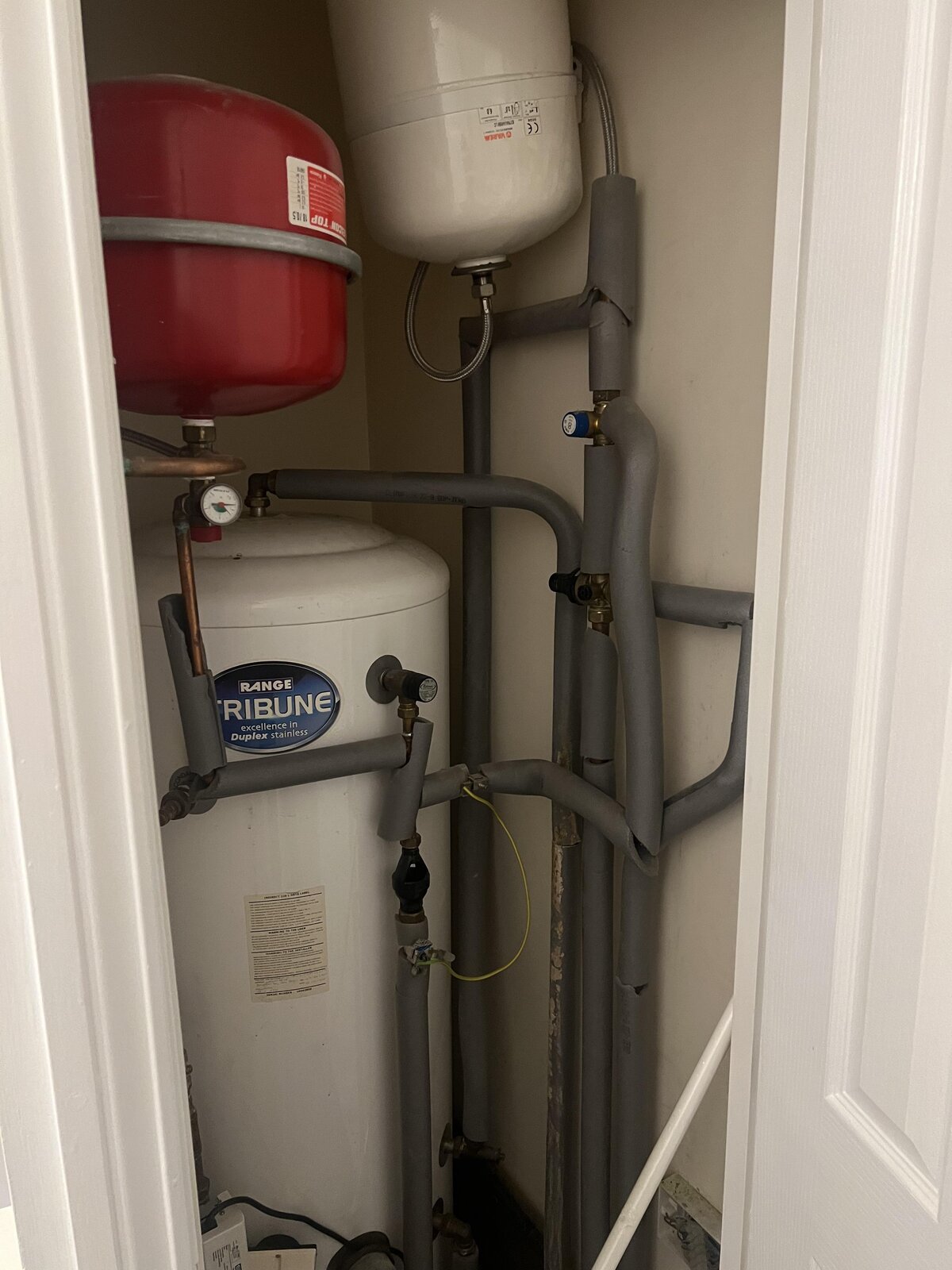

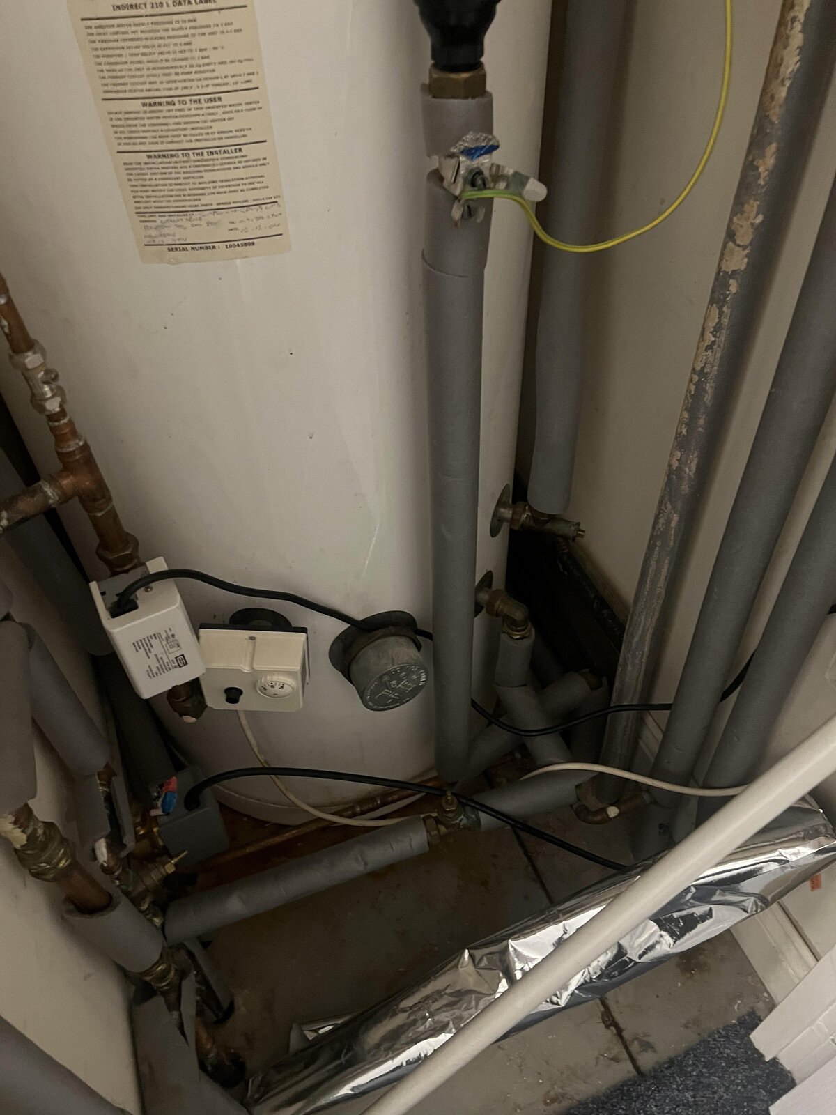

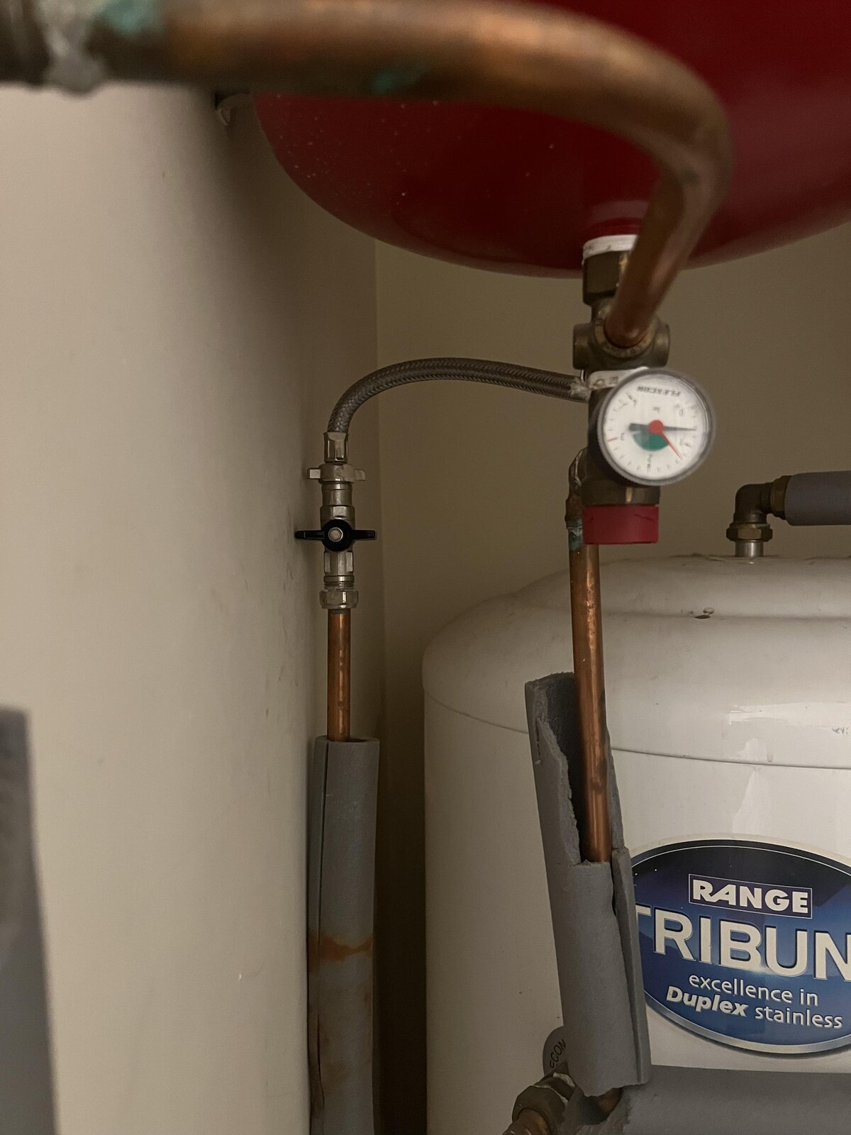

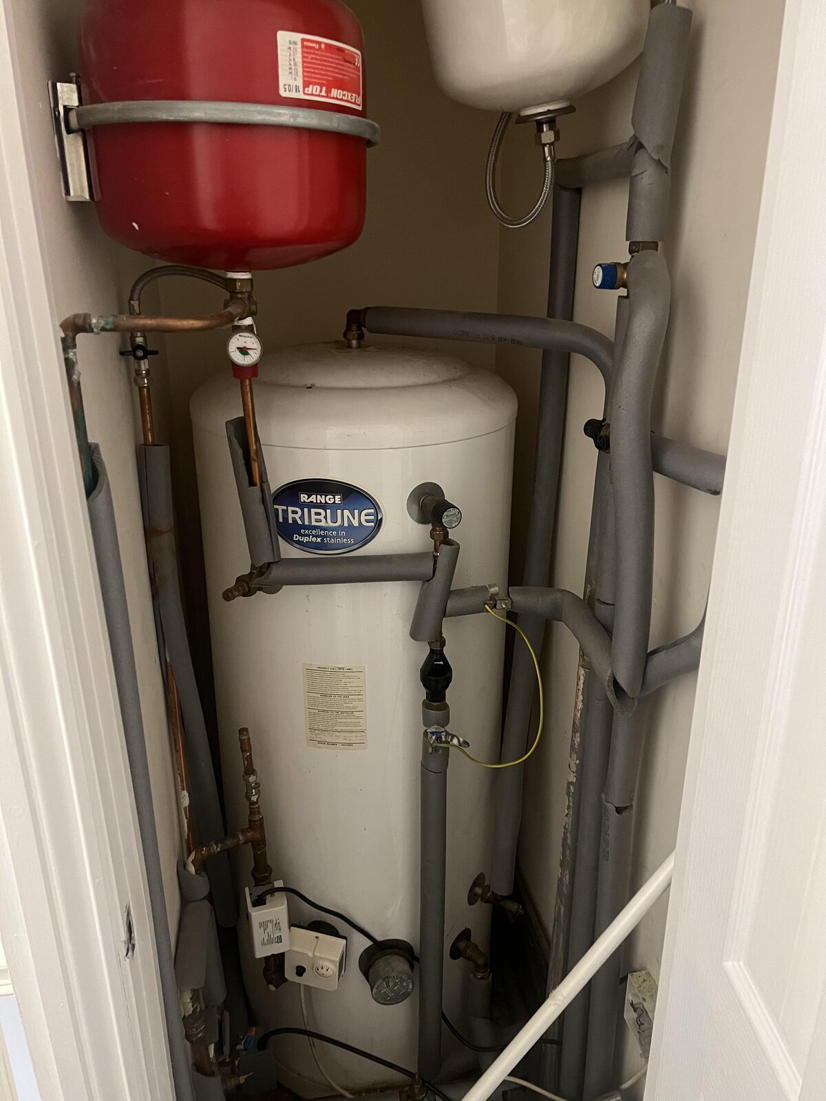

My son has just moved into a house with some issues with rads leaking etc We have sorted all of them minor issues but now need to bleed and balance the system. His boiler is logic system s30 but has no filling loop in the usual place, under boiler near flow and return or anywhere to attach a filing loop that we can see? Is it possible the pressure can be topped up at the tank somewhere? I've attached images of his tank and vessels attached if anyone can point us in the right direction.

You have a black butterfly handle valve near that red expansion vessel open that, if it doesn’t start adding water trace the pipe down and look for another valve further down the pipe
