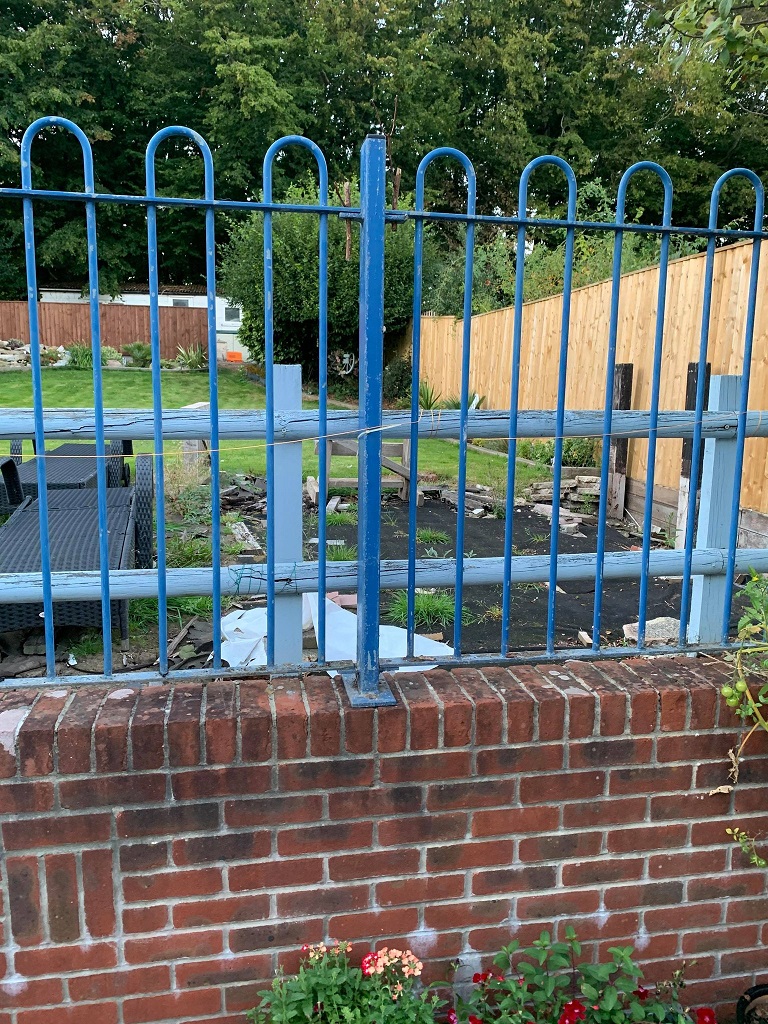

I want to fix these railings on of my garden wall . I’m a bit worried if I fix it to just the top brick it will come loose over time , so was thinking of drilling down 2-3 bricks 150-250mm + .
Are there alternatives to rawl bolts as they seem expensive for the long ones , ie long stud and resin or similar to rawl bolts

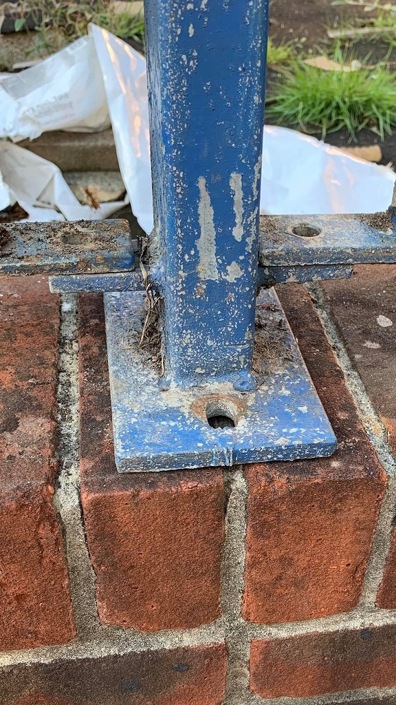

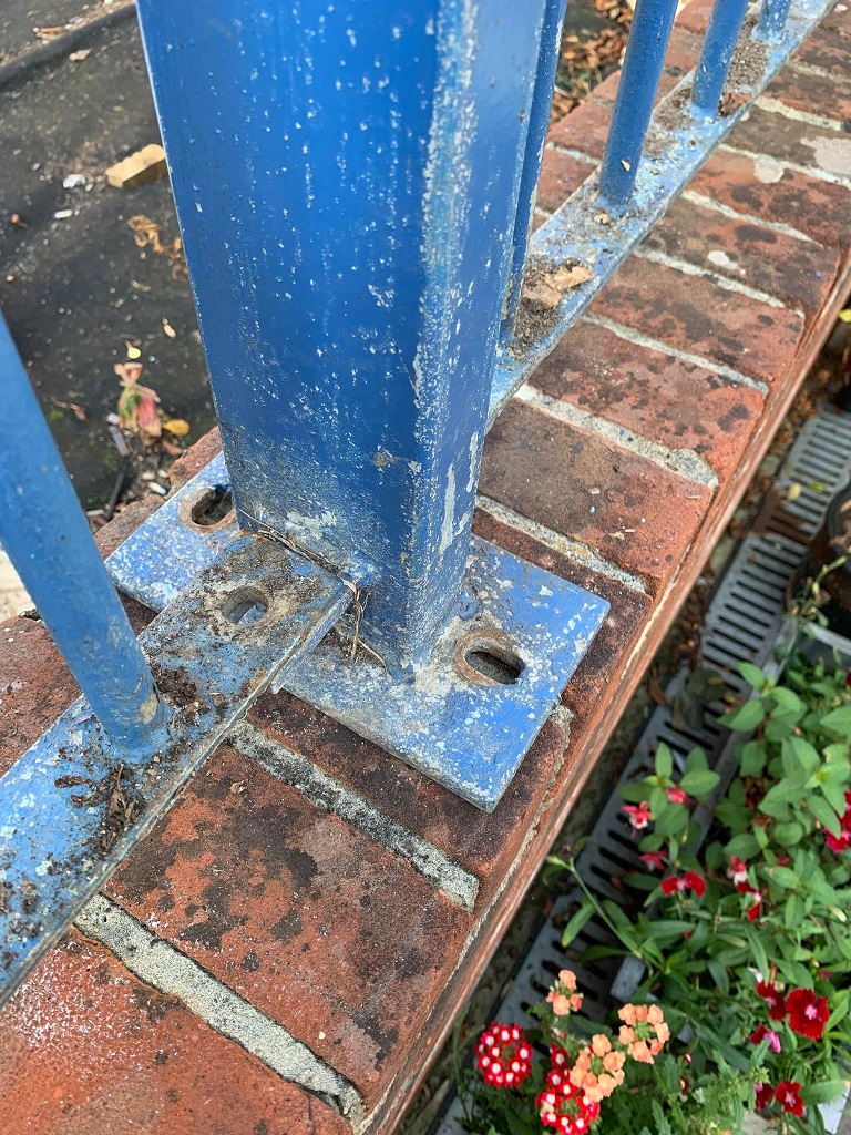

just a DIYer , but i would use a rod and resin, thats how i did it on a raised patio, many years ago , however it looks very close to the edge of the brick , and they may break out drilling , looking at the photos
Go for stainless if you can afford it and some spare nozzles for the resin if you are planning on doing the work over a few days.
I find Toolstation normally have a good selection in stock.
