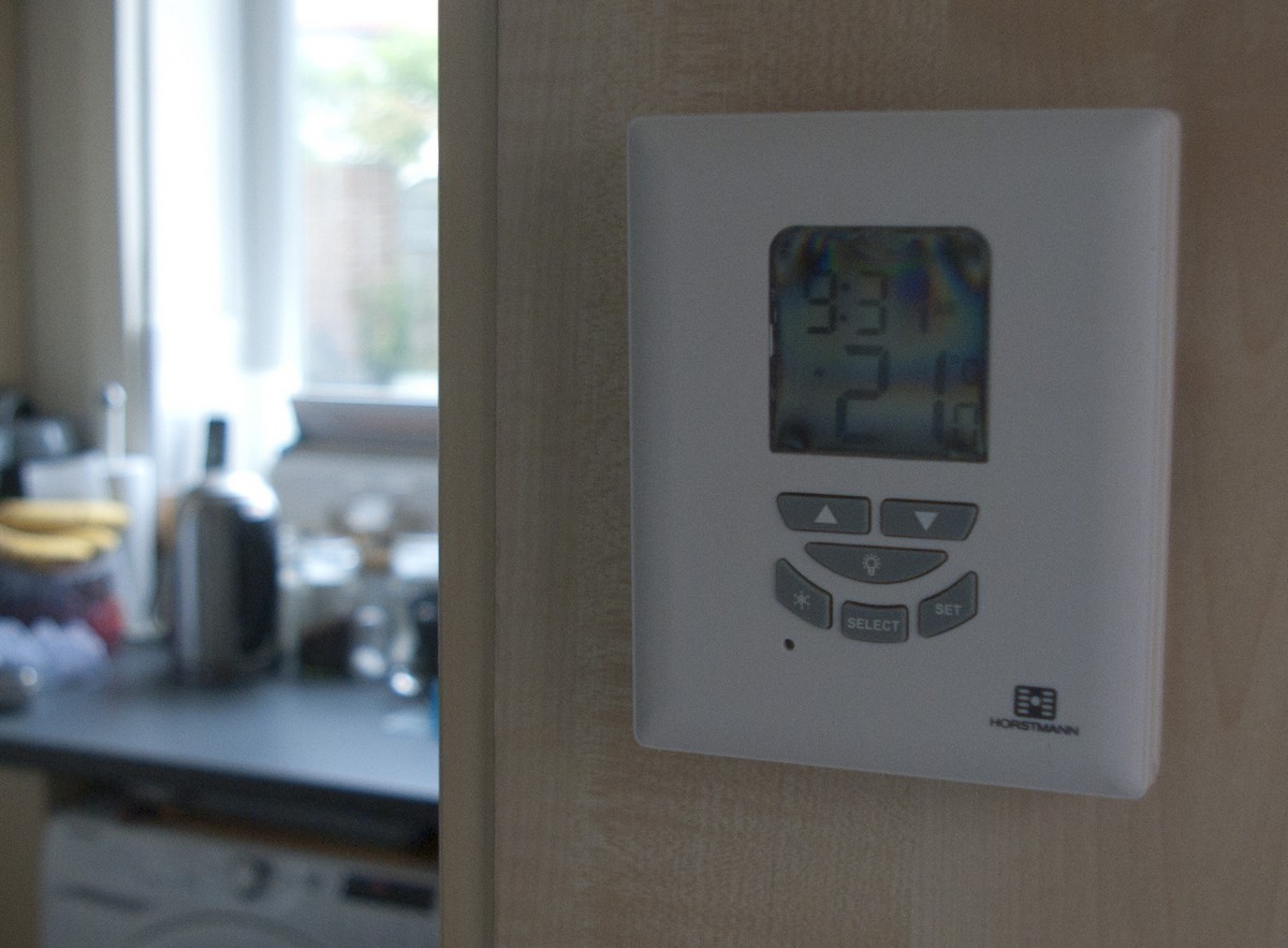

When I came to look at it, it seemed it had been fitted by cowboys, every lock shield wide open, and a wireless thermostat one of these 84067_P.jpgfitted which was really not suitable for a gas modulating boiler, although would have been very good with oil, the reason is it had anti-hysteresis software, which as it approached the target temperature, started to use a mark/space ratio (turning on/off) to stop it over shooting, which defeated the boilers built in system which would modulate the output (turn it down) as the return water gets hotter.
The return water will get hotter as the TRV's close and the by-pass valve opens, so the boiler auto adjusts output to match demand, but each time turned off, then back on, the boiler reverts to full output. So the two systems were in conflict.

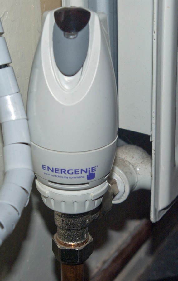

However that wireless thermostat did have a safety device, and if no signal in ½ hour it auto closed down, I tried this thermostat IMGP8037.jpg which did not have the fail safe, and found the living room far too hot. After the thermostat failed did not want to just fit another one, so I tried fitting electronic TRV heads, IMGP8035.jpg they were claimed to work with Nest, so I had intended to then fit Nest, however they worked very well, at first not so good, but they reported both current and target temperature TRV_report.jpg so it current exceeded target I closed the lock shield a little, and once set, they worked A1, in fact that good I never bothered with Nest.
