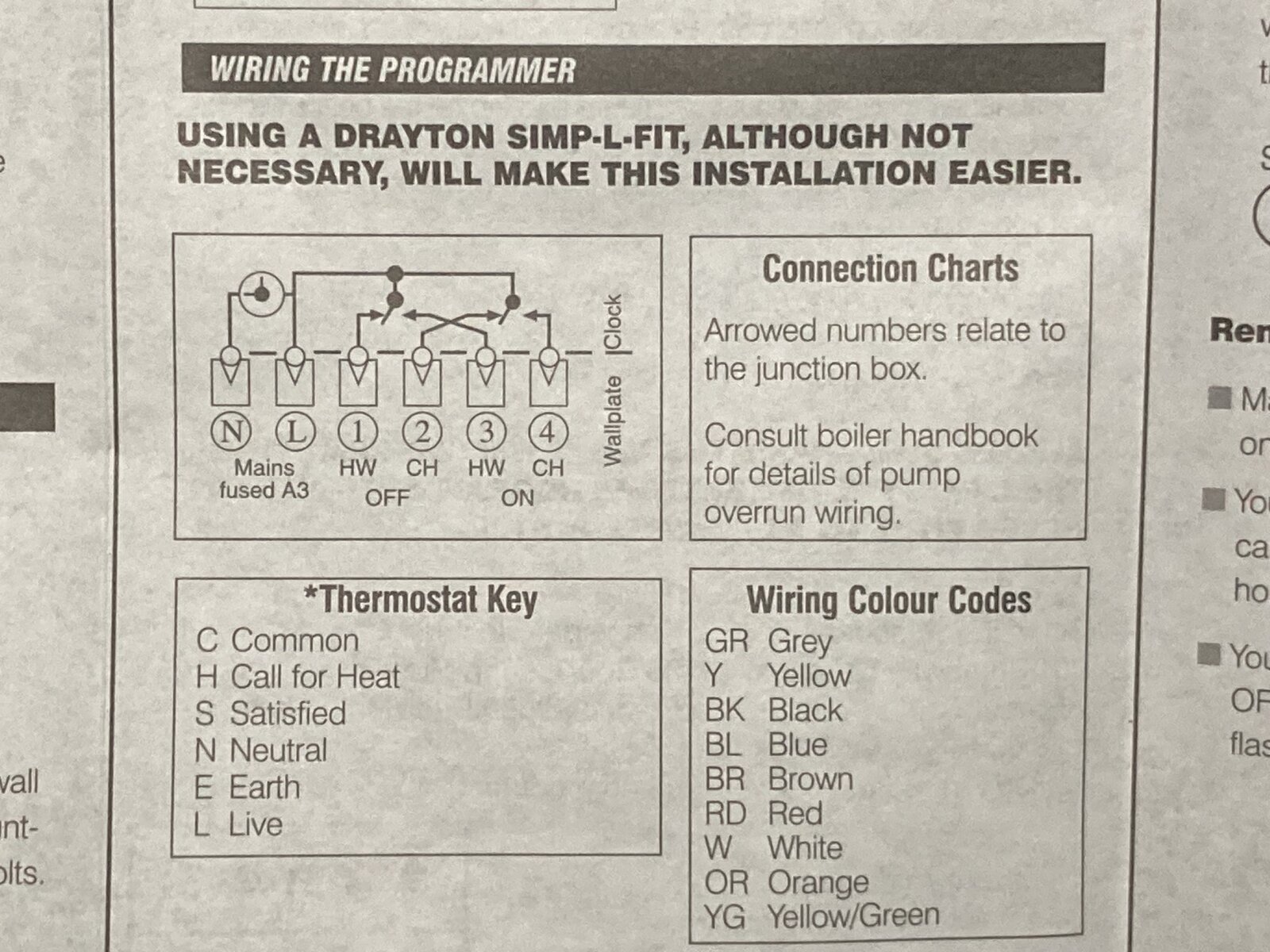

So I’ve just fitted the new LP522 but the back plates weren’t compatible. Luckily it was a case of just transferring the wires from the terminals on the original back plate to the terminals on the new one. The boiler fired up initially and started sending hot water to the rads but then the boiler cut out but the pump kept going! Typical!! Bizarrely the boiler fires up for the hot water….

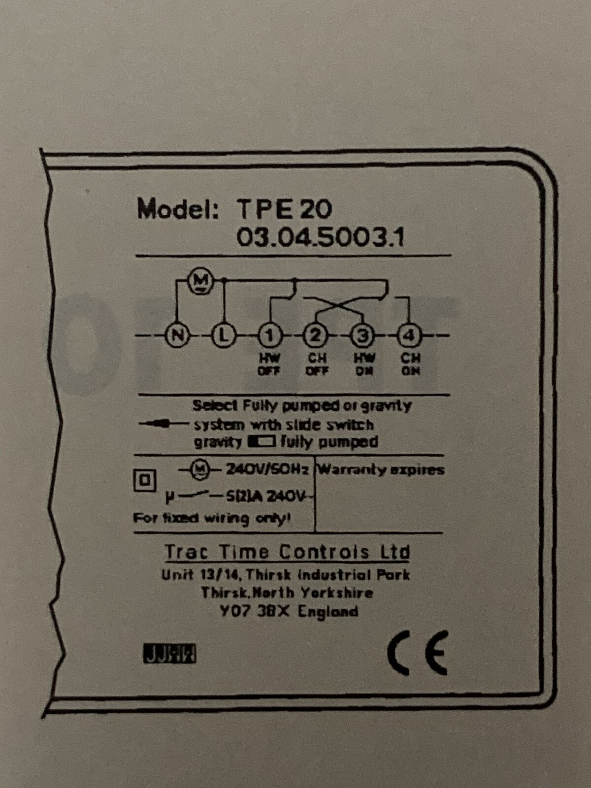

Photos from old and new instructions

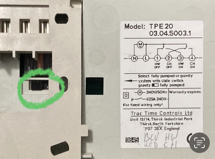

Apologies, bit of a faux pas. Pumps are known for continuing, it’s called pump overrun. Are you saying one circuit isn’t working? Was the Trac set to gravity?
Yes, this little switch shown circled green
