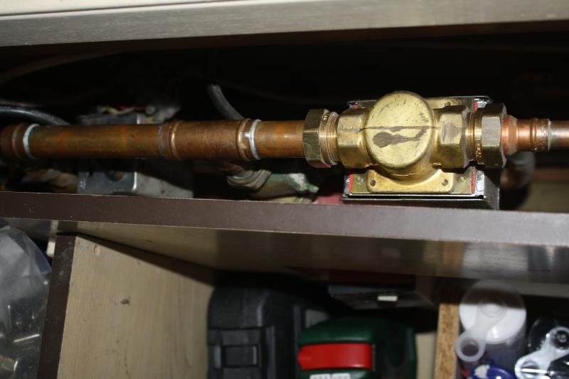

If I understand correctly, this is the zone valve (the box behind the pipe) ?
a switch which attached near the valve with three numbers on it:

The box behind the pipe in pic 3 is a motorized valve. You only mention one valve, so it will be a mid-position type, not a zone type.
There is a lever in the slot which is just visible in the pic. Try moving the lever to the right. Is is loose, or does it need some effort to move and then go back to the left when you release it?
If the lever is loose, turn off the main power to the system and try again.
What happens to the lever this time?
Does the cover for the motorized valve have a small bump on the top at one end?
PS the thermostat on the side of the cylinder is set too high; reduce it to 60.
The lever is loose, no effort needed to move it and did not go back to the left when i released it. I've tried both when the heater is on and the heater is turned off manually from the thermostat on the boiler.
yes it does have a small bump on the top of the one end

You have 2x 2 port valves and it is most likely that one of the valve end switches is staying closed or one of the valves is seized.
They look a bit of a pain to get to.
Is that the same valve as in the earlier pic or a second valve?
The fact that the lever was loose means one of two things: (1) the valve is being held open; or (2) the valve is stuck open.
Turning off the power (setting programmer to off is not sufficient) will mean that the valve is no longer held open and you should then have resistance to movement. So, if the lever is still loose the valve must be stuck open.
The bump on the top of the cover means that the actuator (that's the complete box) can be separated from the pipe part of the valve. (One screw to remove cover, two screws to separate). This would then expose the valve spindle, which should turn easily by hand - less than a quarter rotation). If it is stiff a little silicon lubricant should help (NOT W40, which will rot the seals).

Thank you for the suggestion. I have managed to remove the side of the cupboard and yes both valves are the same. I tried to turn on the water heater from the programmer and I can hear the mechanical movement on one of the valves (the brass-colored one on the right). The same cant be heard when I turn the central heating on from the programmer.
I just turned off the power and I found there is still no resistance from the lever (its still very loose). Do I still need to proceed to

Yes. The lever is still loose when the power is off, so the valve is stuck open. Removing the actuator will allow you to check if the spindle turns easily and lubricate if necessary.
is this actuator need to be replaced ?
The sticking spindle is in the other part of the valve, so replacing the actuator will not solve that problem. If lubrication does not help you will have to change the complete valve - that's a drain-down job.
It might be a good idea to check the other valve.
