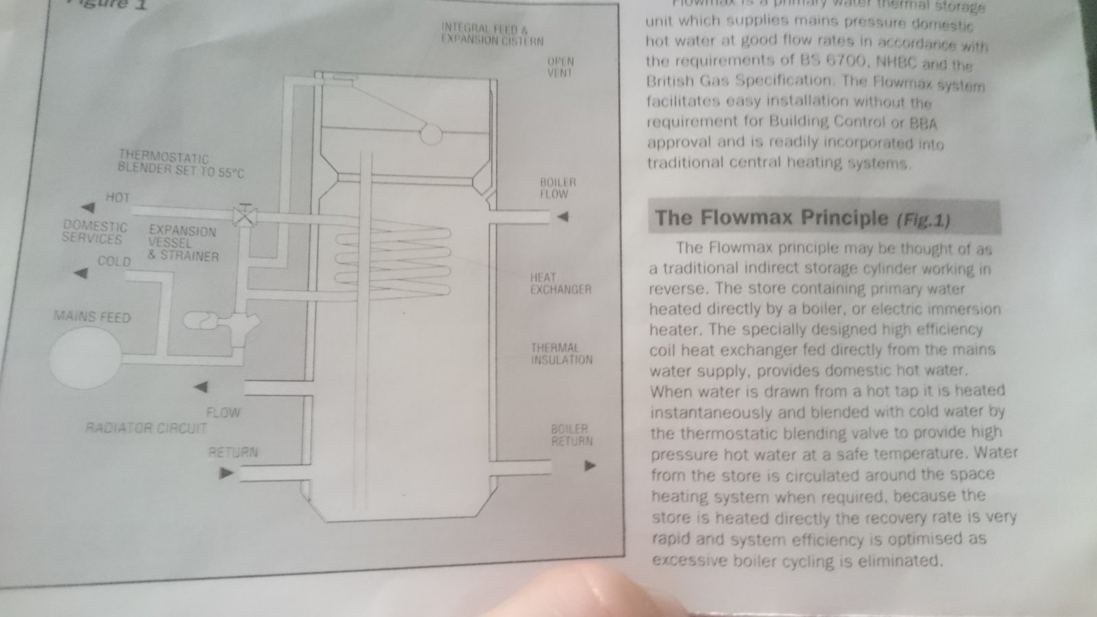

Getting new kitchen fitted going to move current programmer Landis & Gyr to different location so thought would take opportunity to replace it and current roomstat, which is in totally the wrong place with new one and wireless stat. The system I have is in the pictures included and wondered if anyone could offer advice on good replacement that wont cost the earth ,please.

My current setup was in the house from new. I have a 180ltr tank containing primary water heated by the boiler circulated via a pump, this water is fed round the heating system via a second pump when required. In the tank is a coil heat exchanger that is fed with mains pressure water which is heated via the water in the tank and blended with cold to a safe temp. I have one roomstat in the house. Because of my system I can only get hot water from the tap if the primary water in the tank is hot therfore when I press hotwater on the programmer the boiler fires up and heats the primary water tank contents if I then press ch the water is circulated via radiators. If I only press ch both hot water and ch will illuminate as the tank needs to be hot to supply the hot water for ch, but I don't set any temp for hot water via programmer as this is done via a preset blender valve exit the tank. I do require to be able to set on off times for both and want to be able to move the thermostat to any room. Boiler is a Vaillant eco tec 418.Hope this makes sense .
OK, that's sounds like a thermal store, not a particularly common type of installation. I have only seen a couple of that type (Gledhill Boilermate) but they had three pumps, one for the boiler & thermal store, another for the central heating and a third for circulating the hot water from the thermal store through a heat exchanger that then supplied the taps. They had a proprietary controller on board, that sorted out the switching functions.

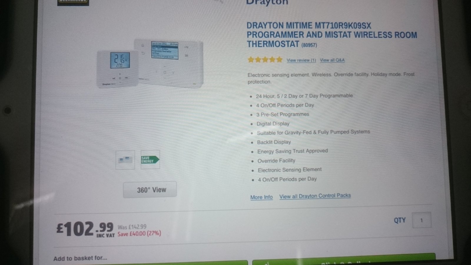

Screwfix have a Drayton MT710R9K09SX programmer and mistat wireless thermostat with £40 off @ £103 now says suitable for gravity fed and full pumped systems?
Looks like only single channel.

I currently have the hotwater set to come on before the heating so that wouldn't be a problem only issue would be if someone tried to boost the ch and hotwater hadn't been on I'll look for a like for like, do you think the Honeywell rf2 is no good then ?
It is, if you click on 'more info' on the web page that you posted, you will see that it says..
..so no hot water time control. However that makes a mockery of describing it as "suitable for gravity fed" as I've yet to come across a gravity fed combi. :rolleyes:

I can't say for certain. I can't see in the instructions any mention of being suitable for 'gravity fed'. (although I have only scan read it) Other than they do show it with a C-Plan which is gravity fed, but the provision of the motorised valve that they have shown provides a changeover contact that gets around having to have the hot water 'on' to get the heating 'on'.
