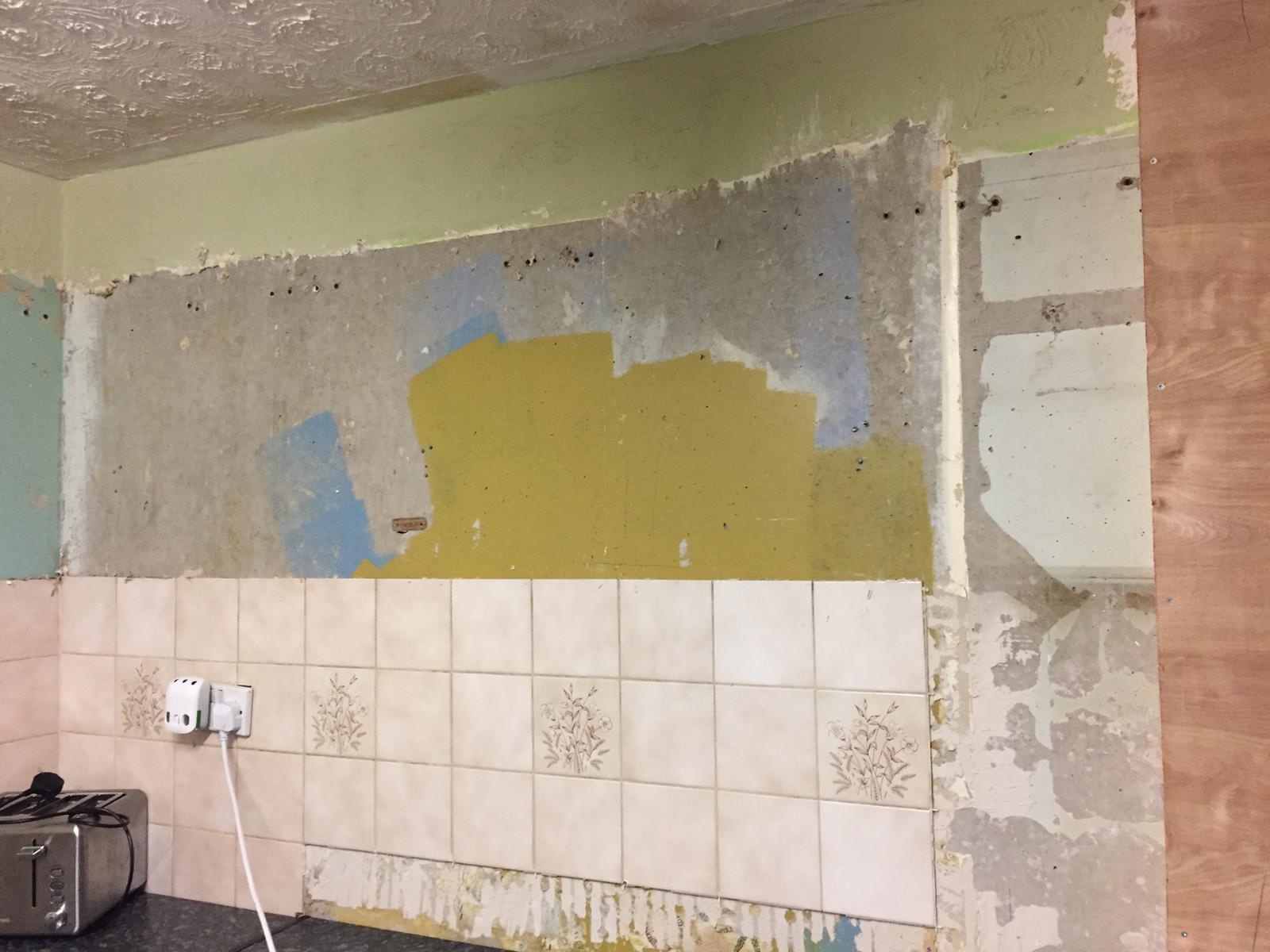

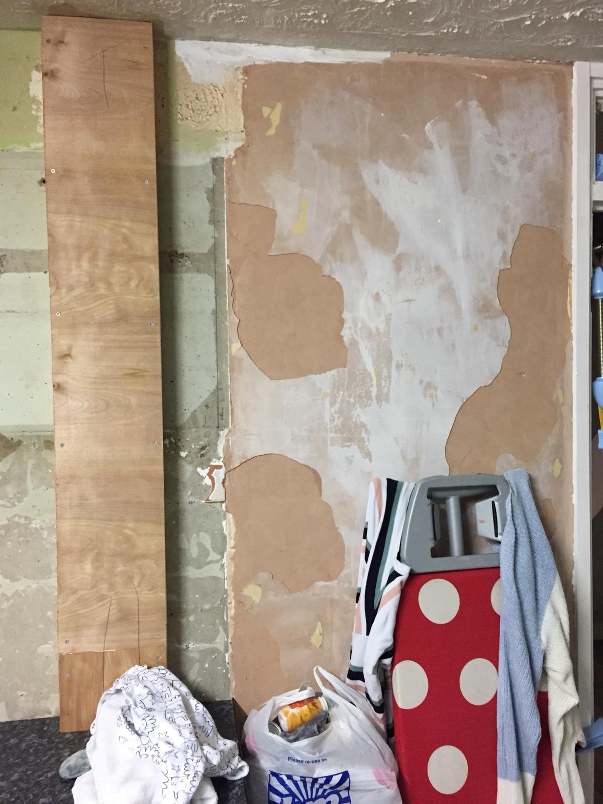

Hi
After some advice on this as its the first time
Ive come across this can i just plaster over this wall once tiles are of or do i need to put a browning coat on first
pva then a tight coat of bonding will make it a better and easier job.
