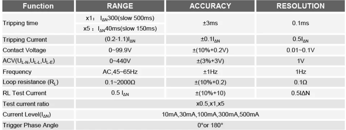

The loop test is not the best 1724497129168.png it only shows 1 decimal place, most meters I have used show to 2 decimal places, but the plug in testers with loop pass at 1.9Ω so far better than them, and not much more money (£61.72) and also tests RCD's so it does seem to do what I need.

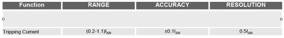

.... and not much more money (£61.72) and also tests RCD's so it does seem to do what I need.
There seems to be something odd (wrong?) about the claimed resolution for RCD tripping current, and the accuracy for that test (±3.3 mA for a 30mA RCD) seems pretty high.

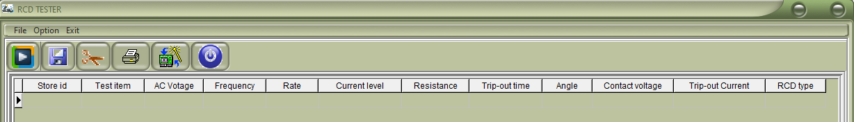

Well got one, seems to work A1, sockets tested give the results expected, only problem I have is connecting it to my PC. A mini CD came with it, and it had three bits of software. The RCD one shows:-
Which seems fair enough, but Read data gets
I am sure it is me doing something wrong, and don't really need to upload anyway, so now back in the box, actually rather a nice carry case, until Christmas when my wife will officially give it to me. But needed to test it first.
