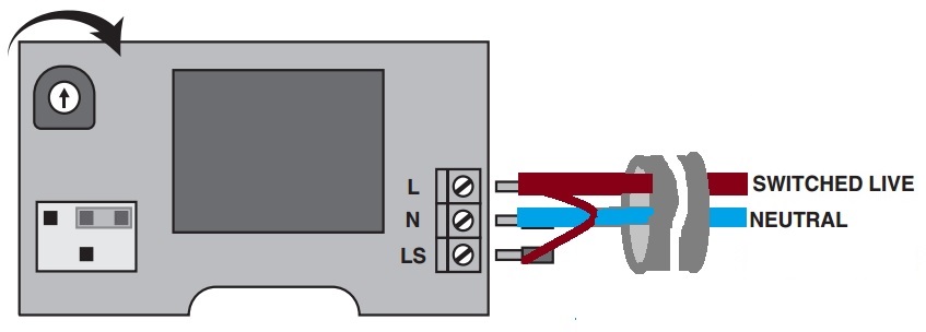

I called Manrose and they said I need to loop the switch live with the permanent live on the fan. Does this mean I can simply use a connector block between the two? I don't have any 4 core cable.
Put link between Live and Switched Live at the terminals in the fan.
EDIT Error in sketch corrected. Now shows Switched Live instead of Live

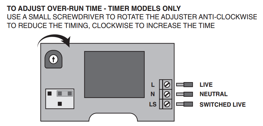

If you might want to use the timer in future, wire the PL and turn the timer adjustment to the lowest point.
It will be much easier to adjust it in future, than to clamber about running and connecting an extra wire.
BTW the wire you are using now will be the SL, so really (see Bernards diagram) it should go to the SL terminal, with a link to PL.
I imagine a sheathed conductor of the same size as the feed (1mm or 1.5mm) would suffice.
