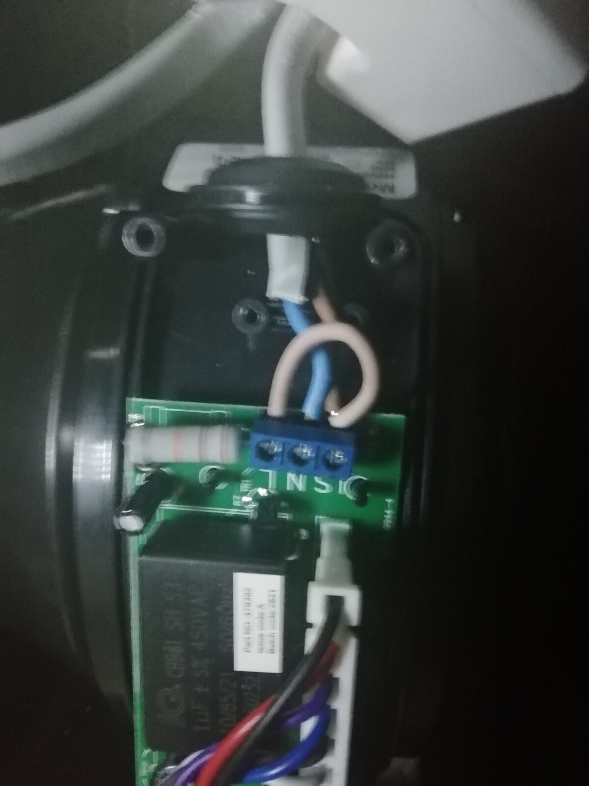

Hi,
I'm replacing a Manrose ID100s with a Manrose MF100T.
I currently have just a permanent live and Neutral wires available. I'm not fussed about the timer function.
I tried placing a wire loop between the LS and L but this didn't work. Any suggestions? Thanks IMG_20230124_132737.jpgIMG_20230124_132253.jpg
That should be ok.

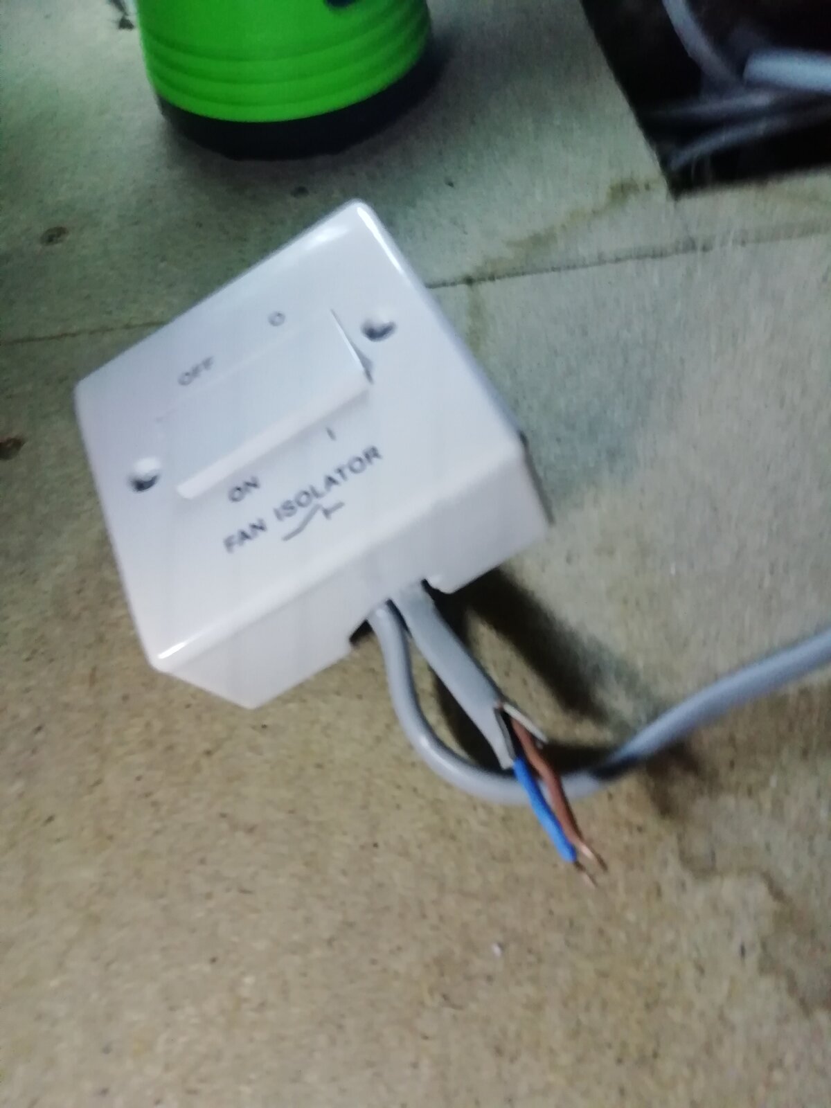

I don't understand the picture of the isolator. What is it supposed to indicate?
Opened up the isolator, all cables still in place.
Does it matter what type of wire i use for the link, i just used a spare piece from a plug/cable?
No, the old two wired fan worked fine before i disconnected it. This made me think i messed up the wiring.
I've took the wires out and redone them but still the same.
if i get hold of a multimeter tomorrow, what would i be testing? thanks
Just wanted to check, my Switched Live goes to the LS on the fan? not the L on the fan
Test you have 240V between L & N.
If you messed up the wiring before perhaps you have blown something.
Ok will get a multimeter tonight and check. Thanks for the help.
If i have blown something then i presume the reading would be zero between L and N?

Could be - but could still be 240V if, as I meant, you have blown something in the fan.
Is there anyway of knowing for definite if something is blown in the fan?
I took everything out and tried again, double checked the connections all looked good.
Borrowed neighbours multimeter, read 240v between L and N.
Bit stuck now, not sure if the fan ever worked in the first place, or did i mess it up some how.
