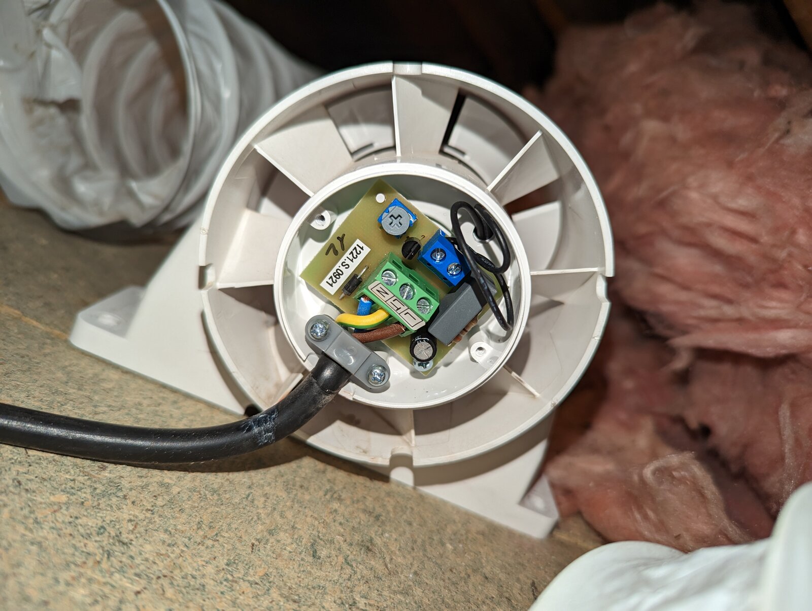

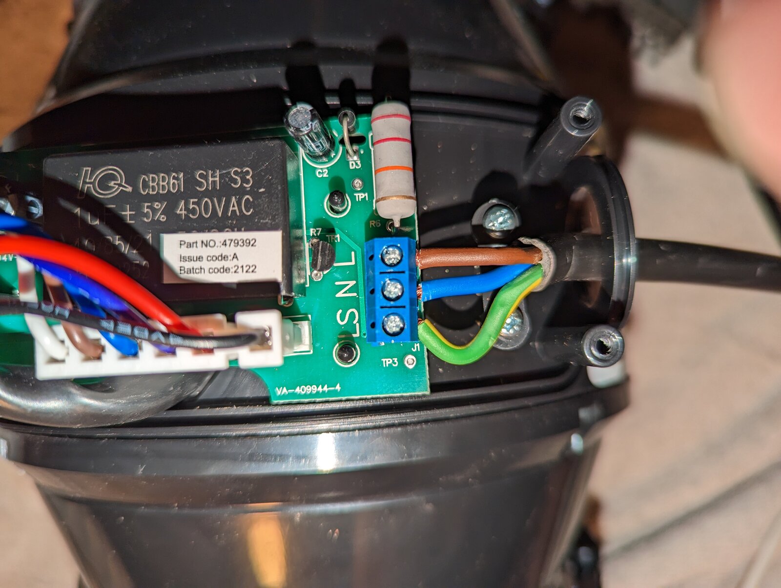

Hello. Was wondering if anyone can help. Just had bathroom done and the fitter installed an inline Osily extractor which, quite frankly, is useless! So I've replaced it with a Manrose MF100T which is far better.
However, the Osily has a N, L and LT connection. The Manrose has a N, L and LS connection (see images). Are LS and LT the same thing (presuming switched live)? From what I found on Google, everything suggests they're probably the same, but I can't find a definite answer.
Thanks for your help!
Be aware someone has used a green and yellow wire as a live wire - which, until recently, wasn't a major problem if it had a brown sleeve over it.
Ideally you should have a new cable, consisting of four wires. The fourth being an earth wire, which gets connected to the supply end, where should be an earth connection. At the fan, the earth wire will be placed into a connector block on it's own, as bathroom fans tend to be plastic and don't actually need an earth connection.
All a bit pointless, it would seem, but that's how it should be done, to satisfy all the rules.
Whether you go to all that trouble...
agreed, using a g/y conductor whether sleeved or not must never be used as a live conductor - note live includes both the line (phase) and neutral conductors. l,n,e in a plutop etc stands for line neutral and earth not live neutral and earth. yes it really should be done in 4 core and park the earthwire safely in a connector.
that picture is a prime example of why you must always test before touching, no matter what the colour code/diagrams etc says it is.
