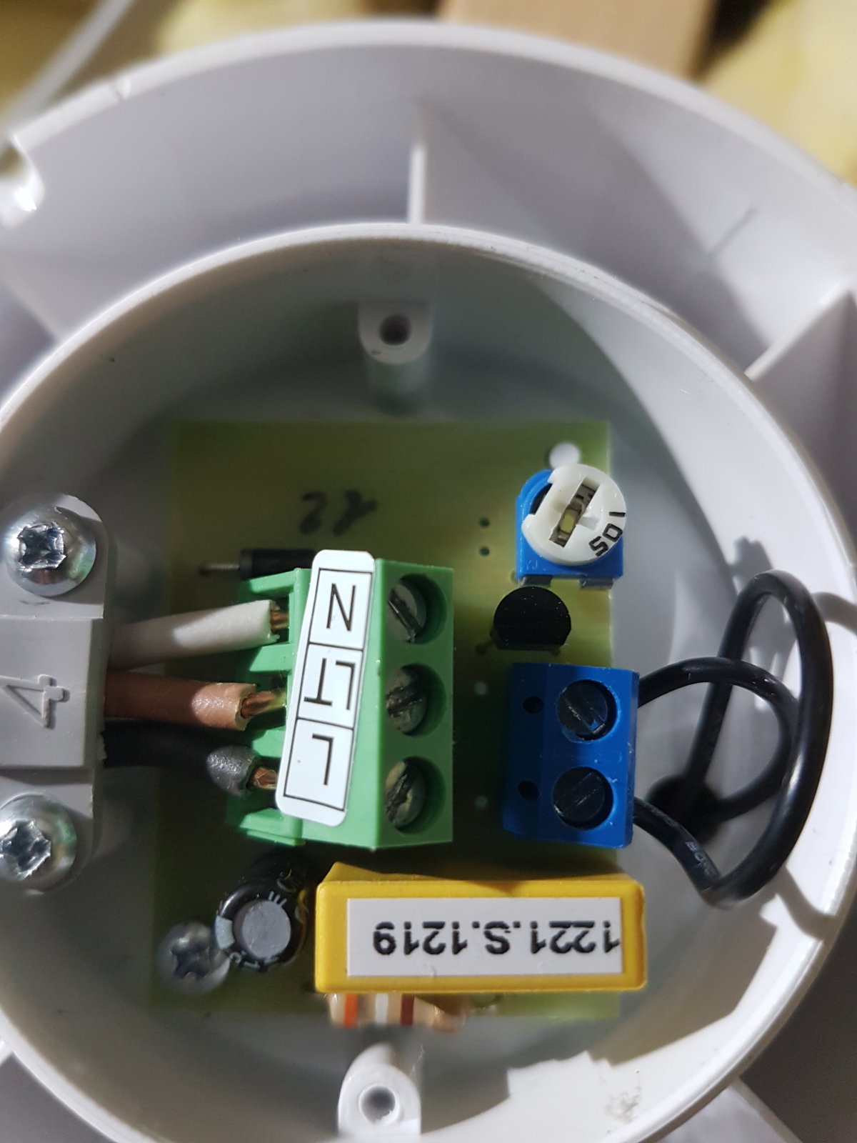

I've replaced an inline extractor fan but the timer won't work I followed the old wiring which was
permanent live =brown
switched live =black
neutral = grey
on the new fan I've put the grey in N
and tried the black in LT and brown in L and swapped them round but can only get the fan to work when the light turns on.
any ideas?
Have you adjusted the Timer at all? Might need a Tweak with a screwdriver?
A. If you have them the wrong way round, it should work as you say - only when the light is on.
B. If you then swap them and it does the same, then the timer is faulty.
C. If it runs all the time - longer than the timer maximum - then the timer is faulty.
You seem to be saying that both B and C are the case; this is not possible.
I've come down now and cleared away, but when the black was in the L terminal it would only turn off with the isolation switch, I swapped the brown and black and it now turns off with the light switch but adjusting the timer wont increase the time so I'm beginning to think its faulty
What make is this?
I've recently had two identical in-line fans, and they would only work when the light was on, the timer function did not work.
I ended up buying a different make in the end, which worked fine, and proved the wiring was ok.
