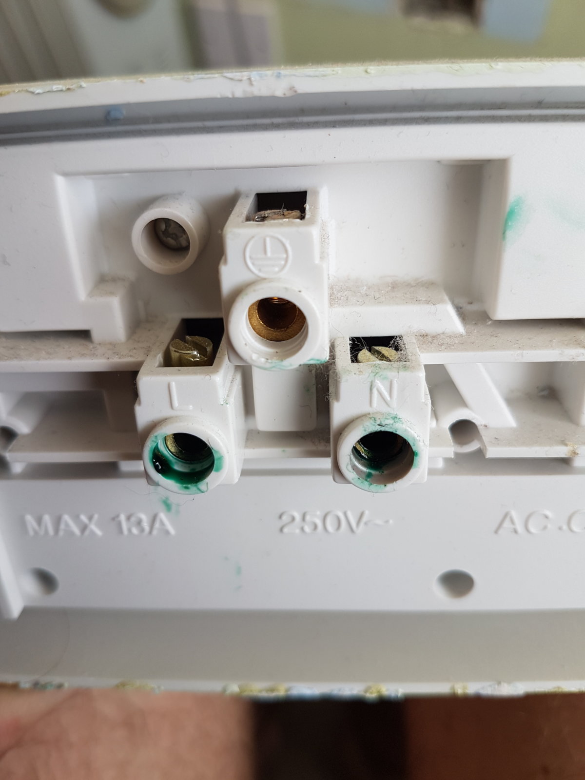

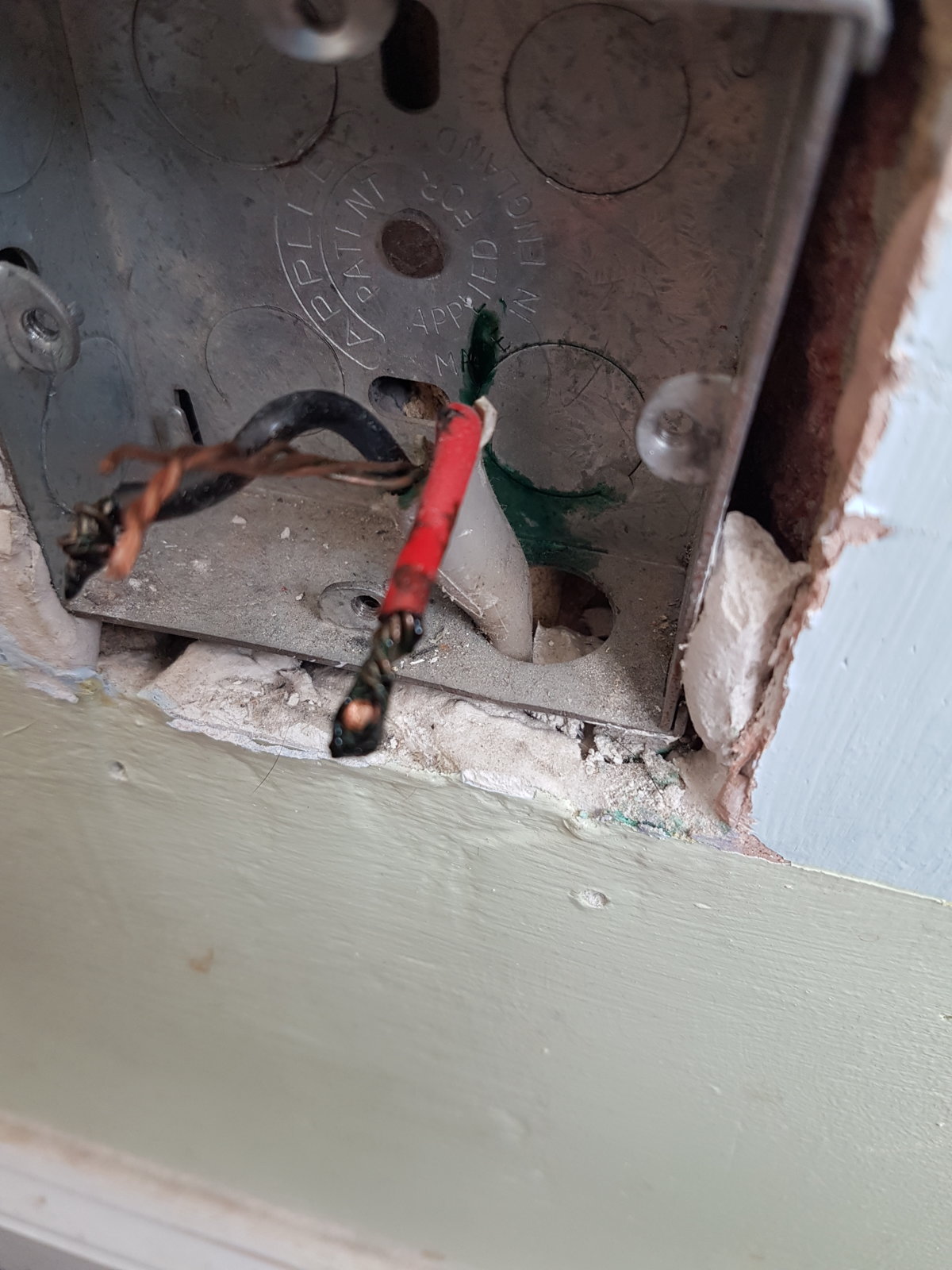

Loose neutral
the green stuff would still run down the sleeving.
I guess you could leave some copper showing out the terminal to give the green stuff chance to leak out before going into the socket.
Not normal recommended practice! but good in this case
the whole house might not have it. For example, I found it in the 1.5mm lighting circuit of an extension, but 2.5mm (obviously from a different batch, but installed about the same time) was fine. The electrician might have had one bad reel, or lots of them, and some work may have been done at different times. IRC the affected cable was made in the early 1970's
If the goo runs down into switches it is liable to cause malfuncton. I suppose if the cable entered the enclosure from underneath, the goo might not reach the accessory.
