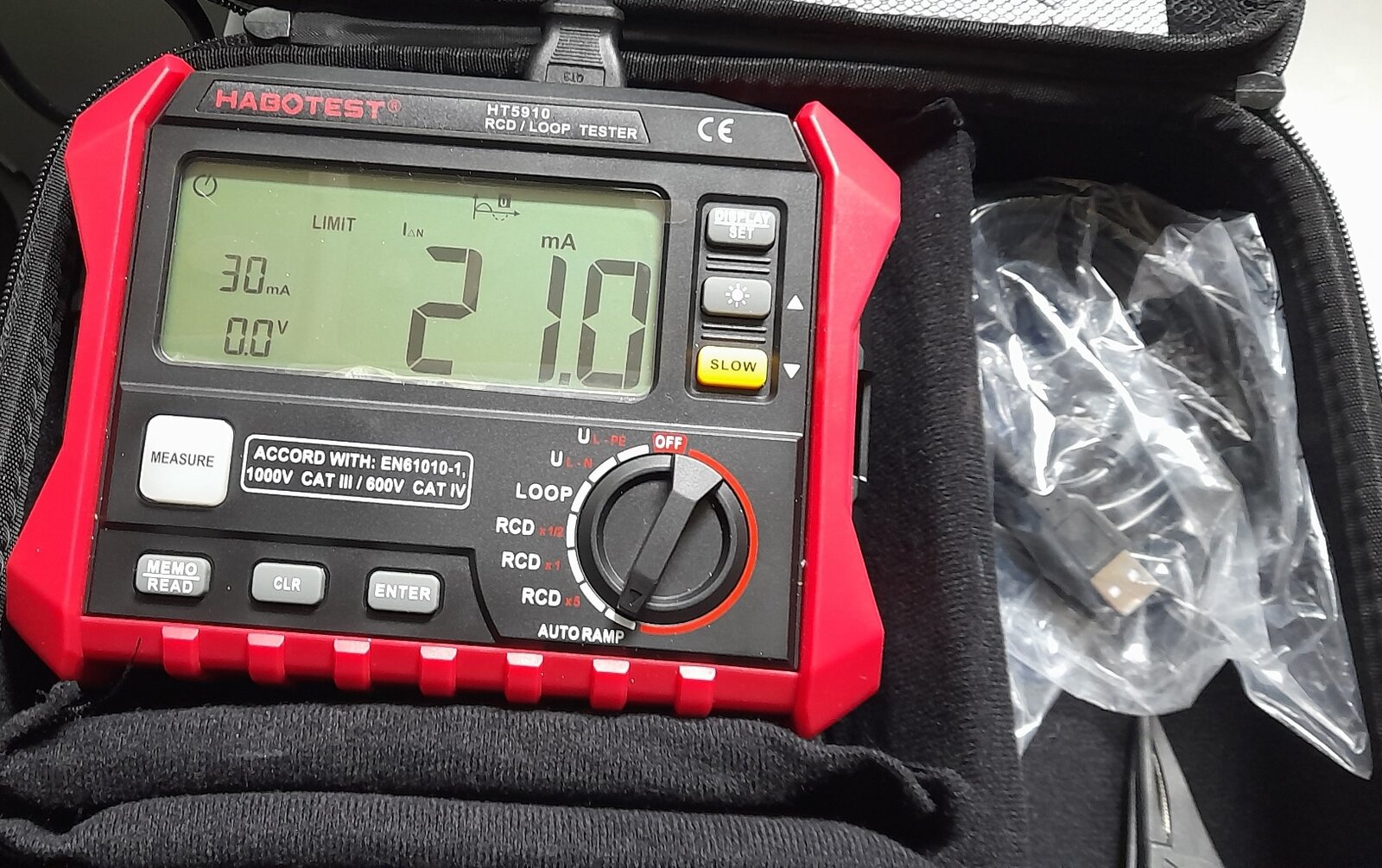

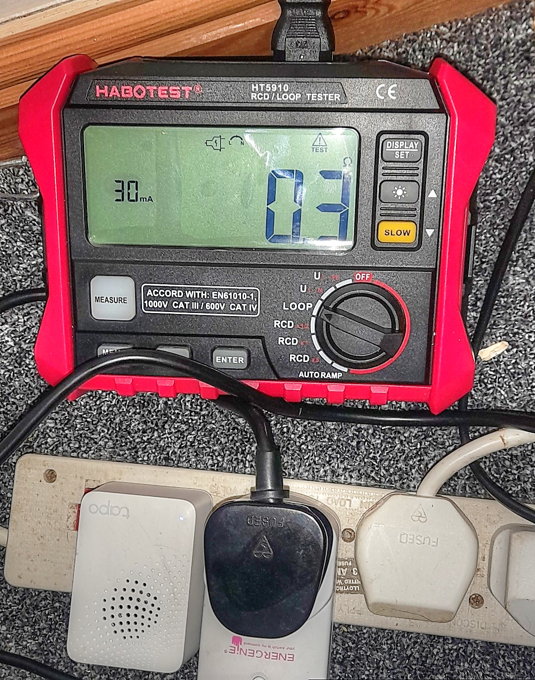

But when we add sockets, we also test, RCD tester ramp.jpgLoop-test.jpg and so we should see if there is a problem, be it the RCD tripping current and time, or the loop impedance, these tests should alert us if there is a problem, but the cheap meter shown costs around £80, and most DIY people simply trust to the lord.

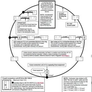

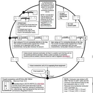

note three connections, as it is not expected to need more.
The diagram on how a ring final is installed also shows no more than three connections, however, since not in the UK, it is anyone's guess what is considered as appropriate in other countries.

View attachment 388880 The diagram on how a ring final might be installed also shows no more than three connections, however,
Nor does it show four on the radial circuit diagram.
That does not mean it is not allowed nor perfectly acceptable.
