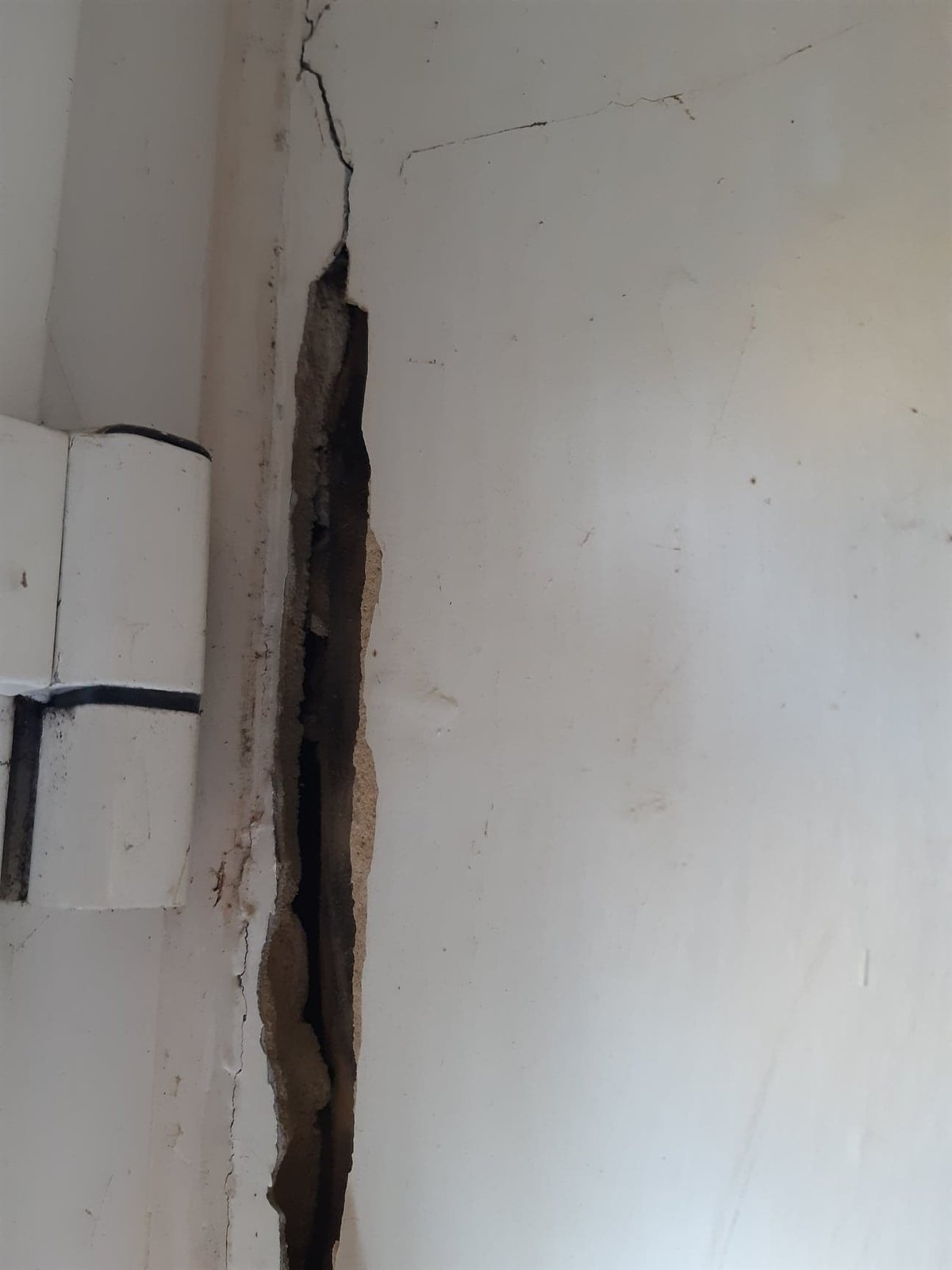

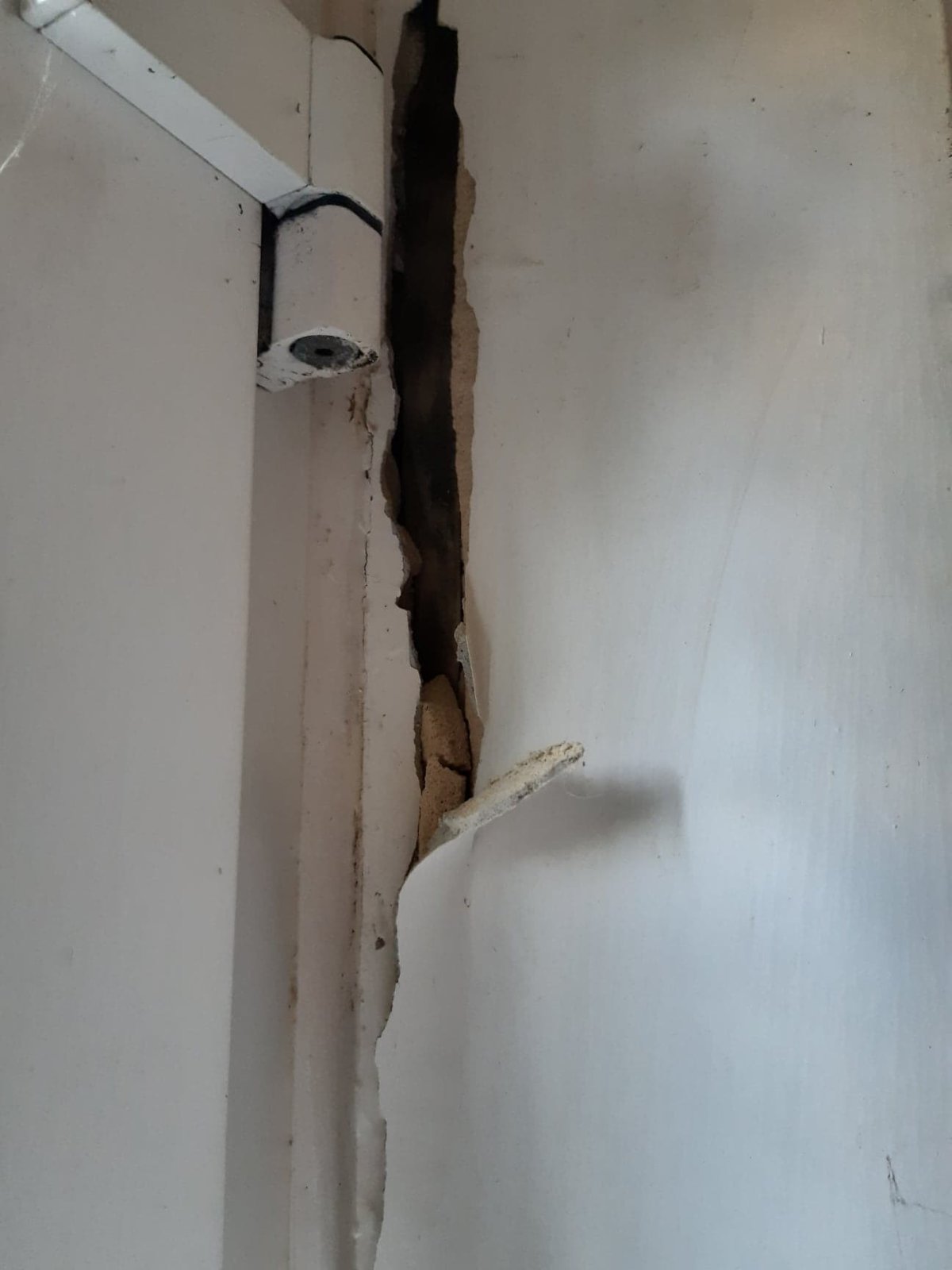

We have had a crack for some time in the plaster on the inside of the external back wall of the house (extension) where the external door is located. Plaster has now started to fall out of it (see pictures). What would be the best way to repair this please?

Possibly the door frame fixings are coming slightly loose.
Can you see the fixing heads - they sometime are covered by a Pvc strip?
Why not photo the whole door jamb from floor to the head - one pic inside and one pic outside, & a pic of inside the jamb showing any fixing heads?
Until any door problems are sorted its not much use making good the plaster etc.
are you sure that there's no cracking on any outside walls or inside surfaces?
There are some pro Pvc fitters on the "Windows & doors" forum.
