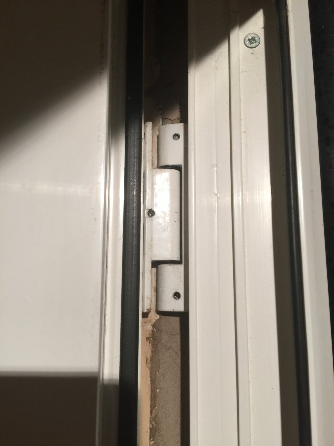

can anybody very kindly advise?
Our back doorhas decided to become a bit lobsided with result that there is a draught at the top right.
The door needs adjusting to pull itself back up.
I've found these grub screws on the hinges. Are they for adjusting, if so how exactly?
Cheers
Those are butt hinges and have very little adjustment.
What you will need to do is "toe and heel" the door (have a google for pics and videos).
Basically you need to take the glazing beads out, Lift the door and slide additional packers between the top of the glass and door frame.
