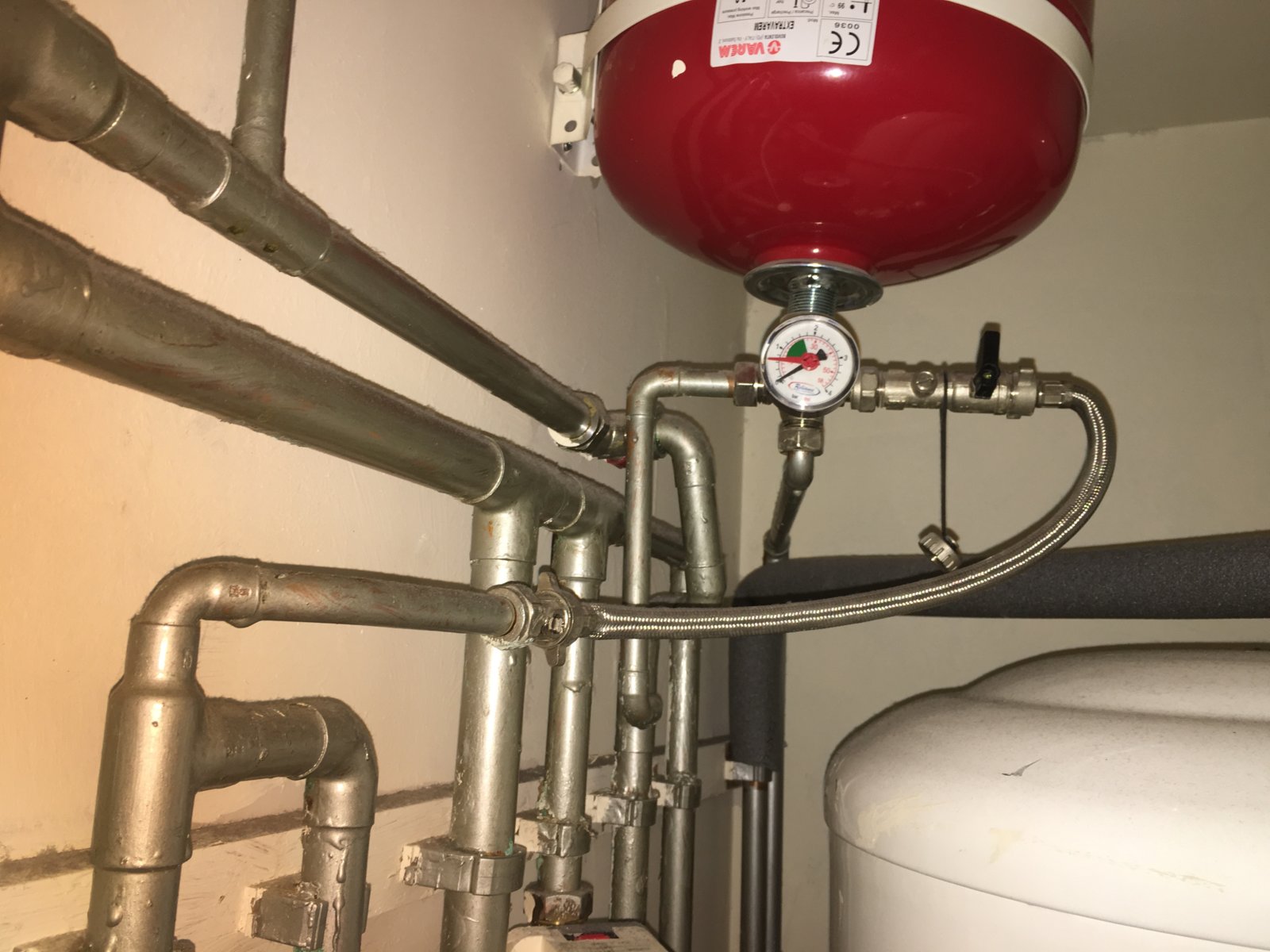

I fired up my central heating on Sunday and bled 2 radiators ( they both hissed but no water came out) all the others were roasting hot and now I have no hot water. I can see the pressure has dropped on the expansion (?) tank to zero but I don't know how to get it back up and even if this is the right thing to do......
Thanks in advance

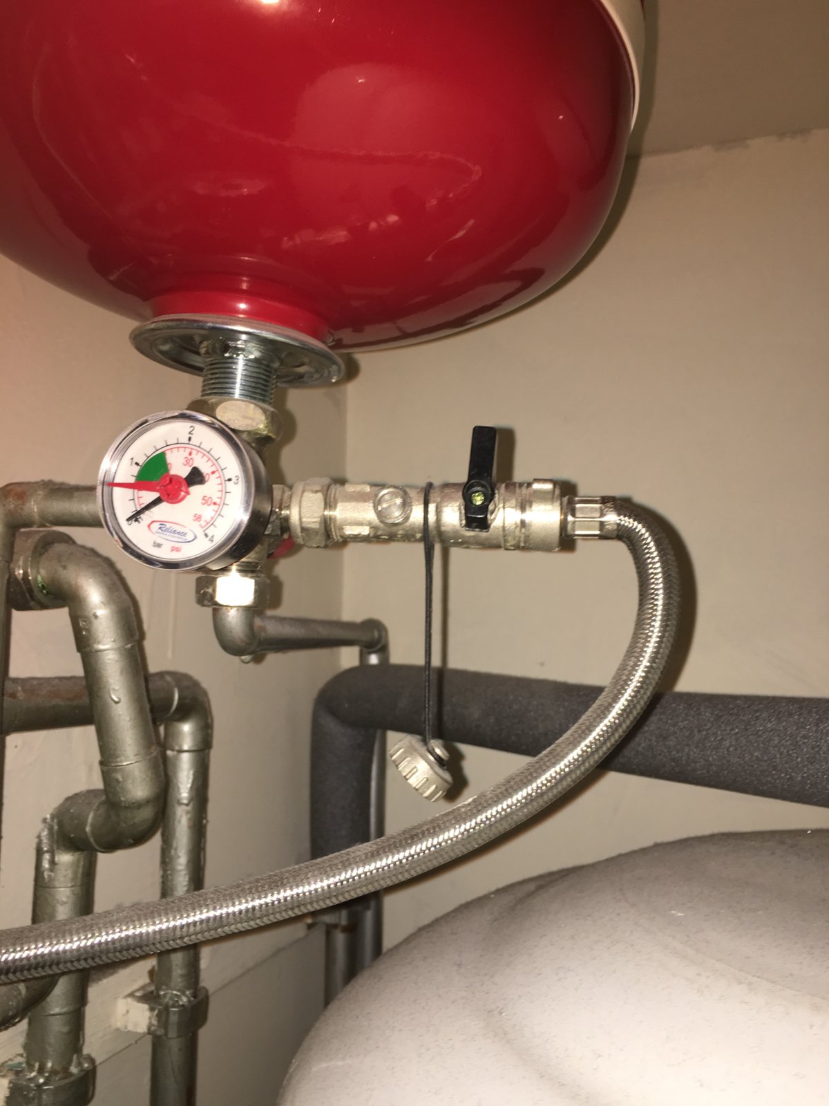

It sounds like you've depressurised your heating system. Post a photo of the red expansion vessel and the pipework around it
OK, silver hose with a valve at either end - open both valves until the black needle on the pressure gauge goes into the green zone, then close them again. You might need to bleed some air out and repeat this
So sorry for the next question - should I keep turn everything off before doing this? I turned my boiler off at the mains when I realised I had a problem
