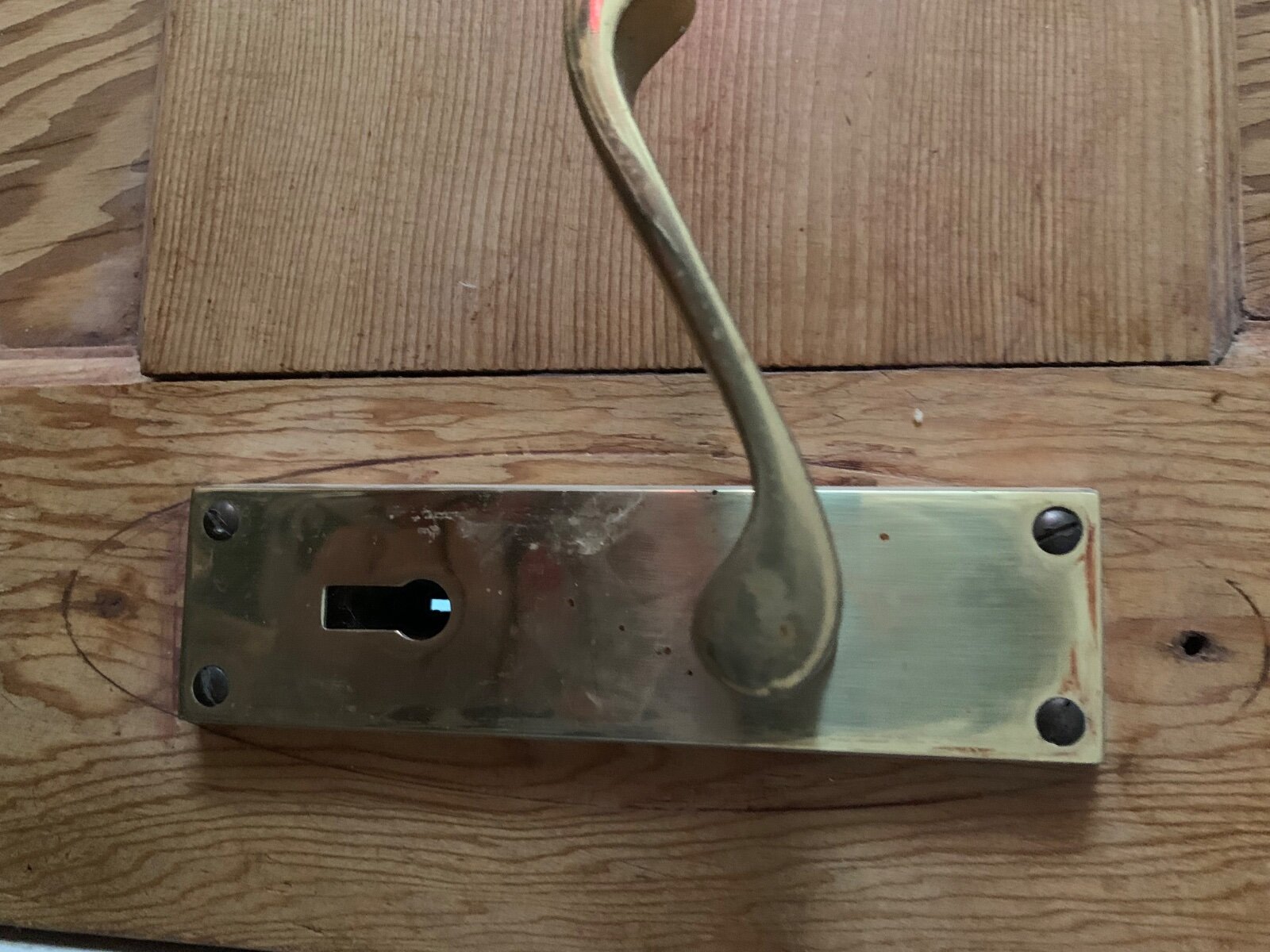

I locked an internal door which has an old lock and have lost the key. Most YouTube videos are for more modern locks. Is it possible to pick this myself? I’ve seen lots of different tools on line but any advice would be appreciated. Thank you.
Thank you but I’m an 82 yo lady who loves doing her own repairs still, what is the lug and latch plate? I have a multi tool so part of the way there. I would love to do this myself if possible.
Thank you so much for your advice, I’ll have a go and if all fails I’ll call Mark my trusted locksmith but I didn’t want to worry him at Christmas time. Thanks again have a great Christmas and New Year.
Does the door open into the area from where you photographed it?
If yes, then as per @Wayners post, you can use a multitool (oscillating saw) to cut through the latch bolt that runs in to the door frame. If it opens in the other direction, you will need to remove the timber door stop to get to the bolt.
You may need a number of blades though.
An angle grinder with a thin metal cutting blade will be much, much faster though. If you go down that path, mist any carpet first though because of the sparks and wear appropriate PPE. If you have a 115mm grinder, you may need to remove the door handle first because of the limited depth of cut of the grinder blade
The bolts are often (but not always) brass. Brass is (relatively) pretty soft and the residual dust will not "rust" if it gets wet.
As an aside, if you have the same lock elsewhere in the property, have you tried one of the other keys?
Thank you for your advice, it seems a lot more complicated than I thought. All the other 4 locks have slightly different keys. I thought I might get away with a hairpin as they do on the films. So I will have to call my locksmith after Christmas. Luckily I have another bedroom!
