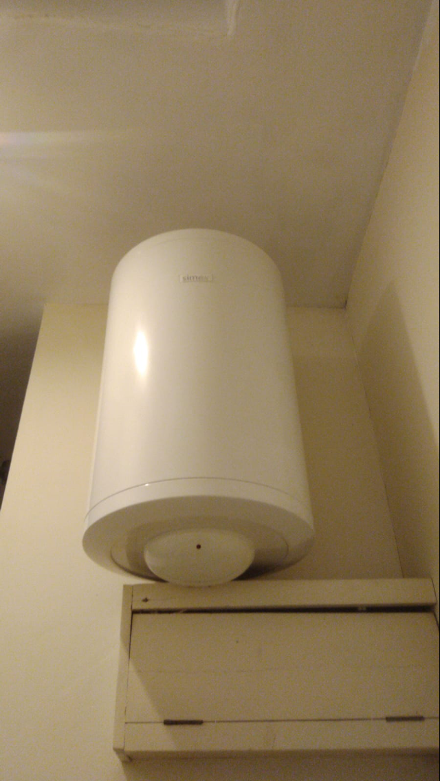

I have a fairly old electric water cylinder (maybe 80 litre) Im suddenly getting low pressure.
Does anyone please have any idea for the possible cause ?
Im thinking maybe rust is building up inside and os causing a blockage ?
it doesnt have an expansion tank but I think has a pressure valve.
thanks

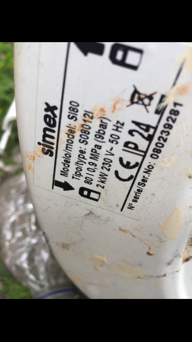

Hi its simex not sure of model but its 80 litres.
On second thoughts I dont think it has a pressure relief valve

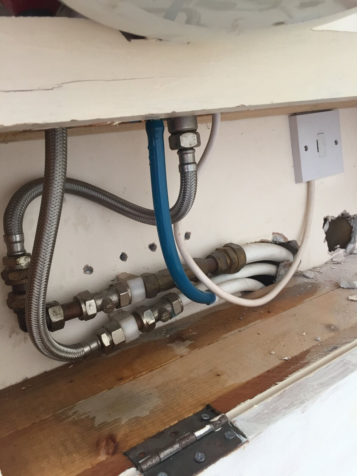

This is the pipework to it, is it likely that any of that could be causing it ?
also theres a cap on the top, I wasnt able to remove, dont know whats under there
Can't find any MI's for it so likely parts unavailable. Can only suggest a G3 plumber to disconnect it and find cause or replace with a modern equivalent.
It has to have some way of safely dealing with expansion of hot water and emergency discharge.
It. Might be as simple as a blocked inlet filter but maybe more involved.
