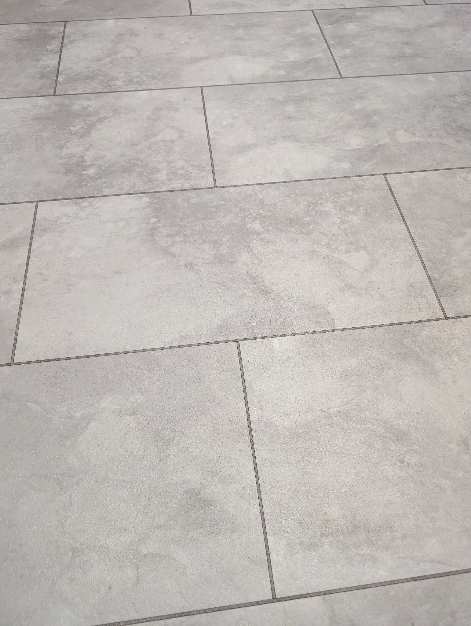

Hi everyone,
I'd be grateful for some advice from anyone with experience installing LVT flooring.
I currently have glue-down LVT that's approximately 2mm thick, bonded directly to a screeded floor. It was installed by the previous owners around six years ago and is still in good condition, with no loose or lifting planks.
I'm looking to replace it with herringbone glue-down LVT, something similar to Karndean, approximately 2–3mm thick.
My main question is whether it's possible to bond new LVT directly onto existing LVT.

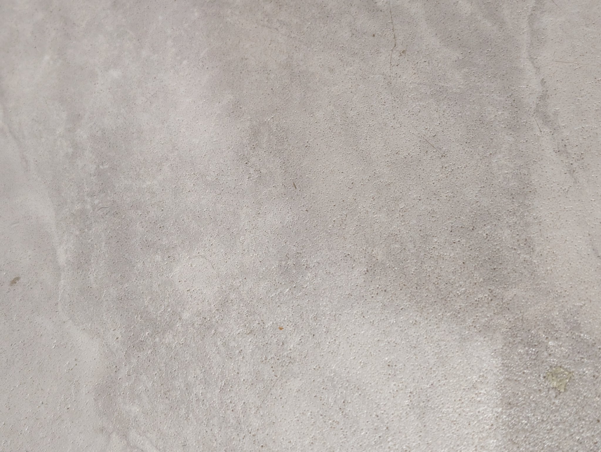

I appreciate that the existing flooring is non-porous, which could cause adhesion issues, although it does have a lightly textured surface.
I've come across F. Ball Styccobond F49, which apparently can bond to non-absorbent surfaces. Would this be suitable for bonding LVT directly to LVT?
Alternatively, would I need to apply a specialist primer and a thin layer of smoothing compound before installing the new flooring? If so, I'd appreciate any product recommendations.
I've also considered click LVT, but I'd prefer glue-down as I want the flooring to fit neatly against the existing skirting boards without having to remove them.
Ideally, I'd like to avoid lifting the existing LVT, as it's firmly bonded to the screed.
Has anyone successfully installed glue-down LVT over existing LVT? If so, what preparation, primer and adhesive did you use, and has it held up well over time?
I've attached a photo of the current flooring for reference.
Many thanks in advance for any advice!

have know a few fitters to do it over the years but bad idea imo. You won’t get a full bond as the adheisve can’t soak in and would sit ontop so a weak bond. But if you want to gamble use F46 and trowel on then flatten adheisve with a medium pile paint roller sleeve.
For my heat tiles and pull up which hopefully won’t pull the screed up then you could prime p51 4-1 then ardex feather finish skim at 1mm.
As Dazlight has say's, don't do it.
It's not hard to uplift the existing lvt, warm it up with a heat gun, peel it up and re-screed the subfloor.
If you try fitting over what you have directly it won't bond and the design of the old floor will show through.
It won't be hard to get the old LVT up.
as above,
A heat gun at 300(?) degrees will soften the adhesive. I have done it a few times but I was only replacing sections. Not my bread and butter work though.

Avoid click LVT, it's an absolute disaster of a product and wont perform anything like glue down LVT. The joints are notorious for breaking, even with correct subfloor prep, we even had one manufacturer not uphold their warranty for a customer because a washing machine had been put on the floor in a Kitchen!
Thanks for the replies, seems like good prep is the only way, will take my time with a heat gun and do this properly. Will avoid click, seems like there is no easy way just the right way!
