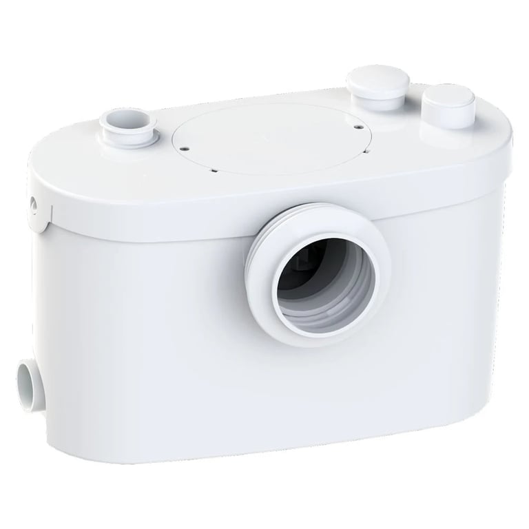

I have researched macerators on various forums and spoken to a number of suppliers and manufacturers and I think I’ve narrowed down the macerator choice to one of two, either a Grundfos Sololift2 WC-3 or a Sanipro XR UP, as both of these seem to have good reviews, the capacity required and also, importantly they both seem to allow the macerator to be fitted to the garage side of the wall. Unless I’m mistaken both have in-built vents as options, both also have the option of having an alarm fitted and both have very similar noise levels. There is a price difference between the two, but the cost of the macerator is definitely not the deciding factor.
From what I can gather, the Sanipro has a max incoming water temperature of 35 degrees (which I feel is possibly a tad lower than needed as one of them likes hot showers), and the Grundfos can deal with much higher temperatures at a max 90 degrees which is way above the safe water temperatures that are ever going to be in use, in the en-suite. From what I can see both can be fixed to the floor (concrete therefore hopefully less chance of noise transfer), and the Sanipro can also be fitted to the wall. Just on the noise, I think by placing the macerator in the remains of the garage, will help tremendously on the noise front, particularly if everything is mounted correctly (it’ll be reasonably straightforward to enclose and carryout further sound proofing within the garage, if needed once operational) but I’d be more concerned about noise transfer through the stud/block wall.
