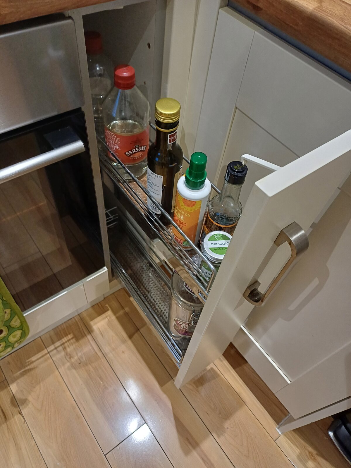

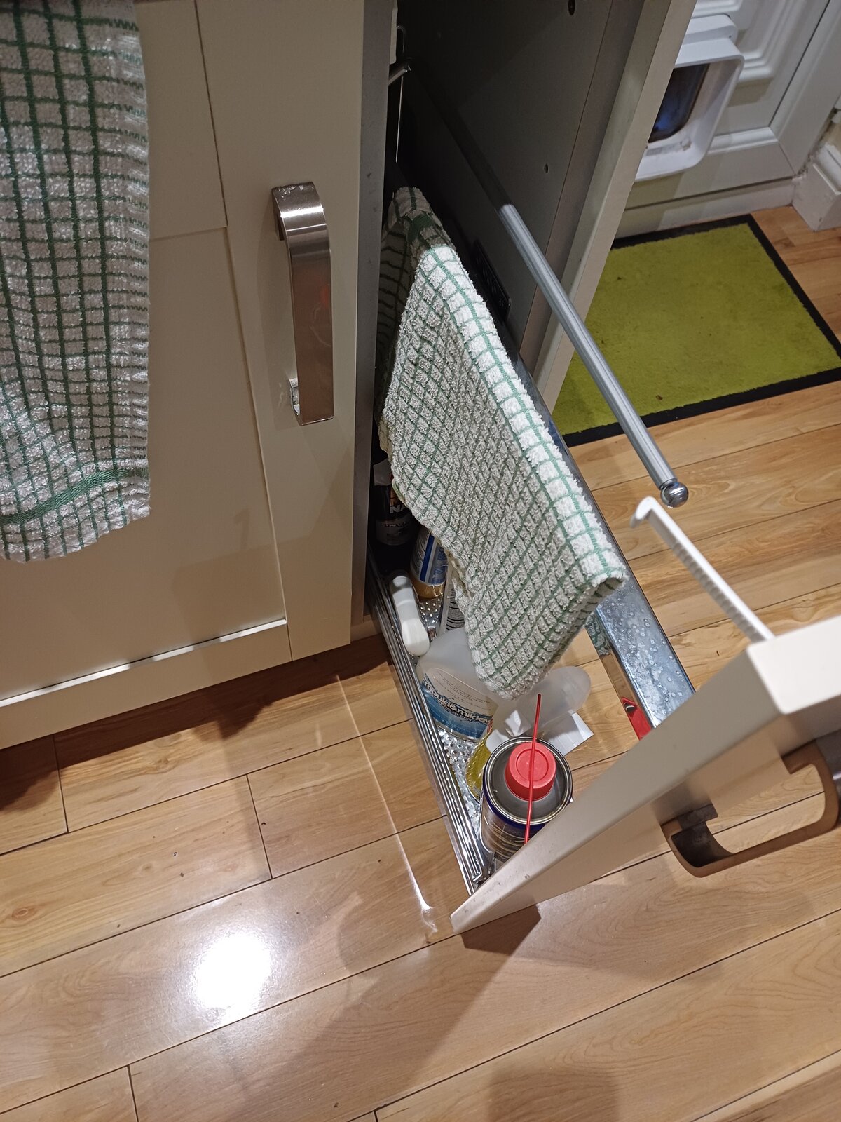

Hi
Tried searching and cannot find an answer so apologies if I missed it and this is repeated.
Please can anyone tell me if you are able to remove these metals racks from these magnet thin pull out.cupboards so you can access and clean behind proper?
I've looked over it multiple times and can't find any latches or parts that suggest it removes.
Thanks.

I’m fitting a Magnet kitchen myself at the moment. I don’t know if yours is the same but all my drawers are easily removed by tugging on them sharply in an upwards motion at the front when they are fully open. To refit them, you just have the runners pushed in, drop the drawer onto them, close it and it click/locks into position on the runners,
Thanks for the replies
I think the pull out slim cupboard racks are a different mechanism to the drawers.
As I know what you mean on how to lift and remove the drawers, which is easy and smooth.
Tried on the pull outs and seems resistance. So I stopped in case I break it.
Thanks.
Pull the unit all out until it stops.
Lift the front and it should come out easily.
Once it's all out you should be able to see the mechanism and work it out.
On some kitchens there are tabs to be pushed in to get the whole unit out.
Haha I pulled harder and success!
But now one of the two won't seem to click in to place on putting back.
Getting caught at the bottom by what looks like a white clip underneath
Doh.
Doh.
You often need to pull the arms/runners out to then drop the female part of the draw back down.
