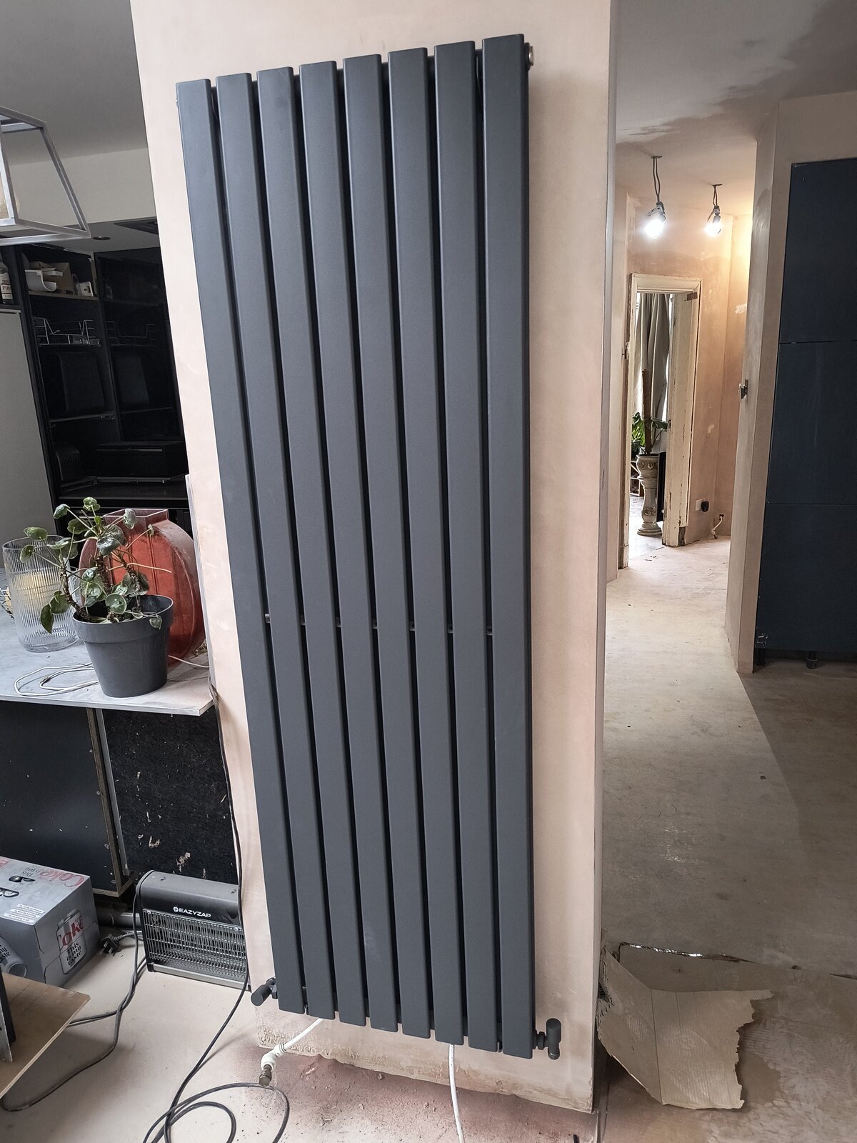

Please make sure you have taken into consideration how those rads will heat the space they are in. Those types of designed column rad cannot be gauged on output alone, as an indication as to how effective they will be at heating the space.
