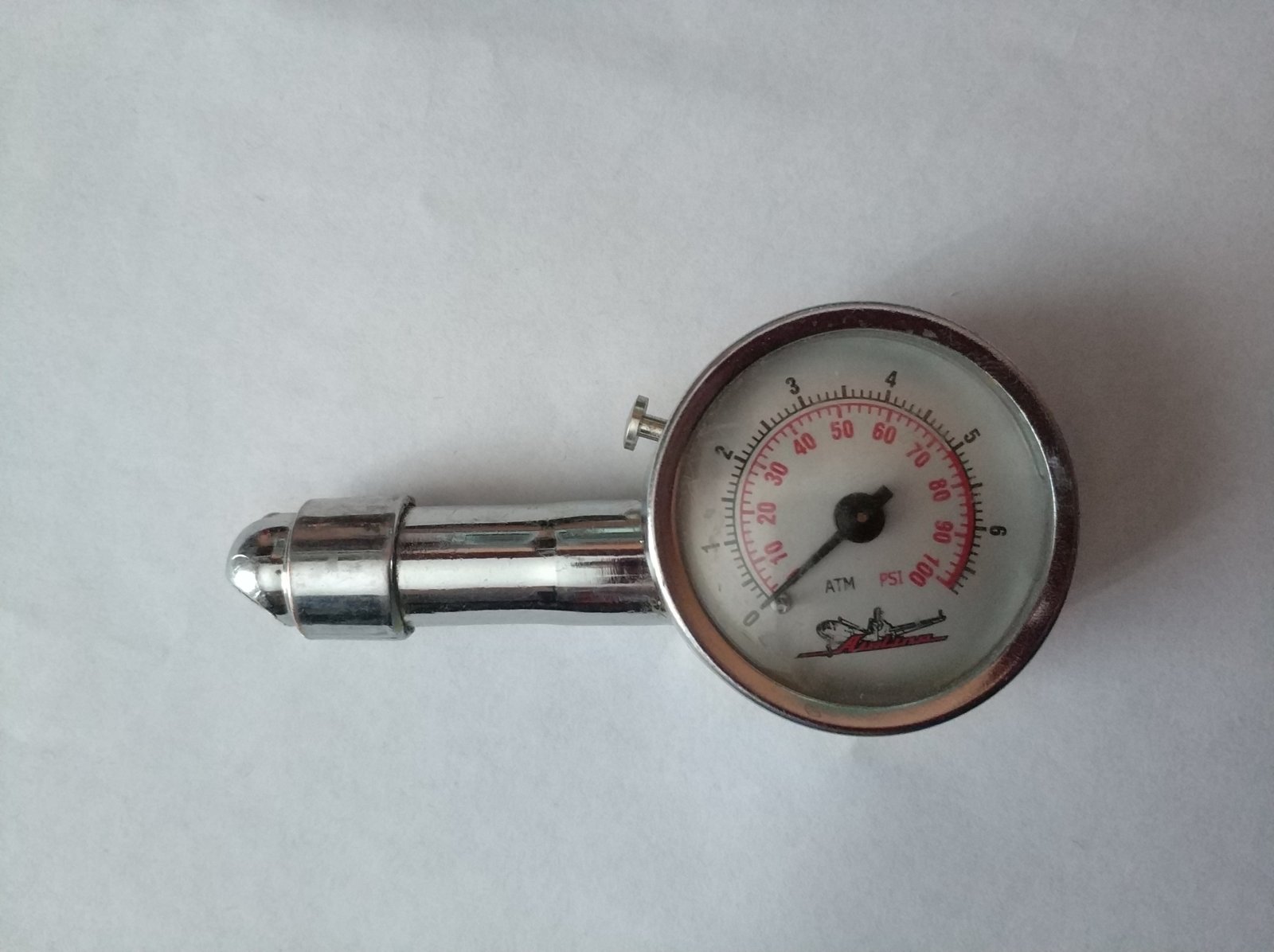

Imnot sure how to do that. Do I need a digital gauge???
Or can I use a foot pump?

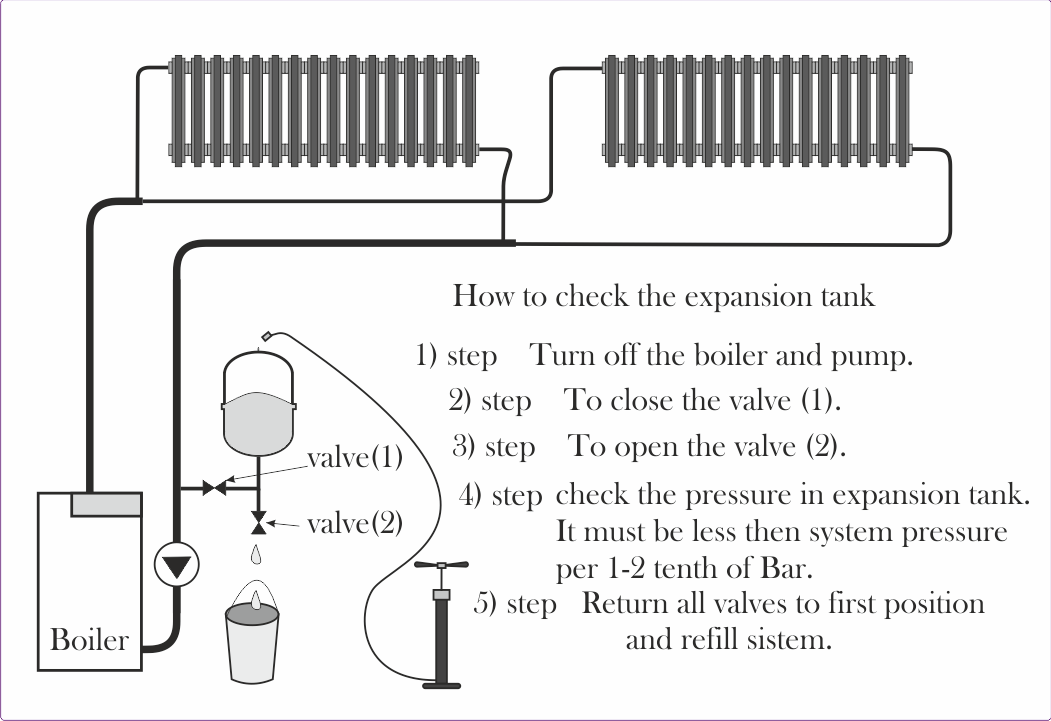

Could I check the pressure myself? Would I have to drain down the whole system inc rads, or just isolate the flow pipes & drain boiler?
Yes in theory - just isolate the boiler and release the water pressure. You're still going to need someone competent to replace the prv. If the pressure vessels inside the combustion chamber the answer is no to both though as you'd need to check the flue and gas rate etc before recommissioning
Easily! If the system has a special valves.
The PRV may not be faulty, and the problems could be down to the expansion vessel. The PRV should release water at 3bar, and if the pressure going too high due to a faulty expansion vessel, then the PRV could well be acting normally. The engineer should check both before replacing anything though.
The caveat here of course, is that you shouldn't be taking the cover off the boiler, and heaven forbid that I suggest you use youtube to learn how to check the pressure in the expansion vessel. With the number of times that you've refilled the system, you're inhibitor will now need topping up.
